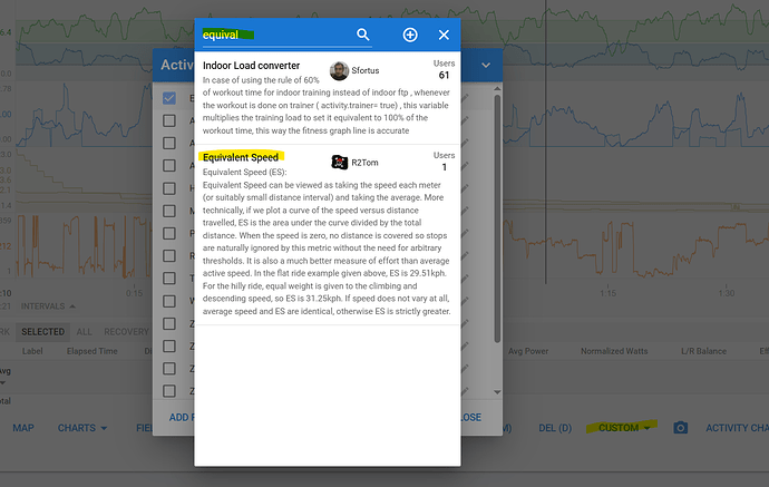

I found this metric thanks to strava sauce and I think it would be nice to integrate it in intervals.icu
So what is this specific feature ?
Equivalent Speed can be viewed as taking the speed each metre (or suitably small distance interval) and taking the average.
The goal being to have a metric like VAM but for flat terrains. It allows people without a PM to compare different activities.
It will simulate a average speed without stops, wind nor hills?

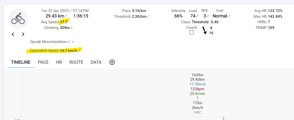

@R2Tom I was still not happy with the pace number returned for Walks/Hikes and a bit sceptical with the result for speed when cycling.
I found at whyā¦
The velocity_smooth stream is a stream with integers. So every point value is rounded (or cut) to the closest smaller/greater integer value. And that seriously messes with the result for Walks.
1m/s is 3.6km/hour, and most of walk/hiking is somewhere in between 1 and 2m/sec.
For longer steady state cycling, a resolution of 3.6k/h also looks too small.
I modified the code once more for both and shared them as āDist. based avg. speedā and āDist. based avg. paceā. Iām taking a 5sec moving average for velocity.
On my data, this is giving a much more meaningful result, especially on Walks/Hikes.
