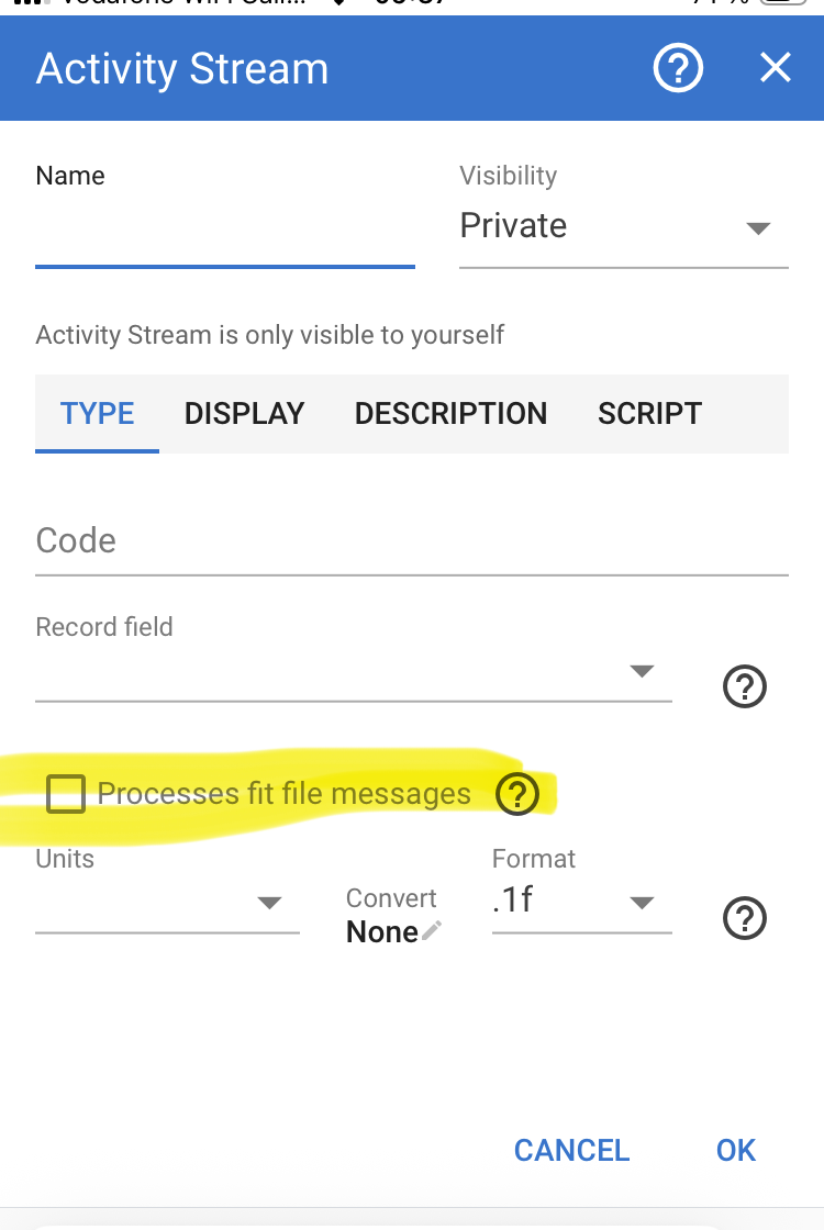

I am developing a custom circular chart for Garmin Cycling Dynamics (Power Phase left/right). I have the FIT data, but I need to parse the arrays into start/end custom streams. Could you please enable developer access / custom JavaScript streams on my account so I can check ‘Processes fit file messages’?

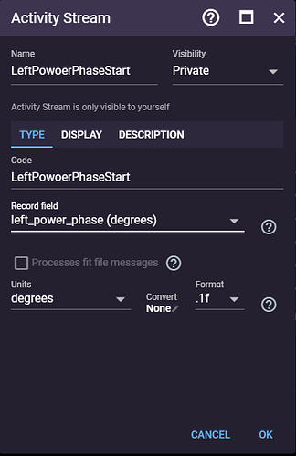

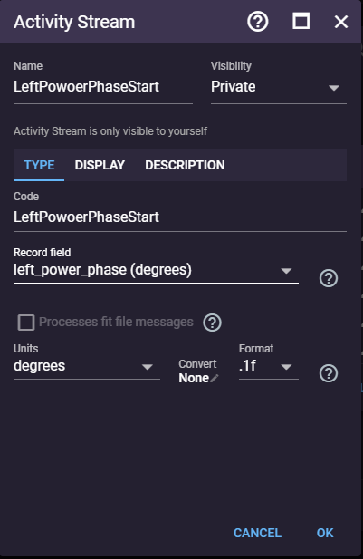

For me the option is dissabled as soon as I select a Fit Field

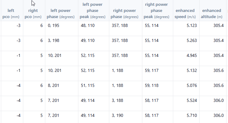

BTW I want to achieve splitting the Fit File data for power phases from 4 colums into 8 separate streams. I need to have start and end angles for the power phases as a stream to calculate and draw Cycling Dynamics Diagrams.
This creenshot from Fitfileviewer shows that those values are actually not single values but pairs stored in an array that I need to separate.
So either you select a record field OR you want to create a script from the fit data, then tick the checkbox and aggregate the data in the script tab
You where spot on. I need to leave the Fitfile Field empty. Now it works :slight_smile: Thank you very much!!!
