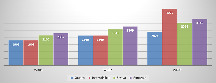

Hi @david ,
Here´s 1 week of evaluation.
If you ask me, it actually looks scary, how much it most likely overstates elevation gain.
Weeks 1-2 without elevation correction on intervals.icu. Week3 with elevations correction.
Suunto is the raw data, Strava and Runalyze they recalculate.
I´d say you´d rather consistently understate it, hence not apply any correction, than so much overstate it.
Still much appreciate your help & effort here.
Thanks,
Vero

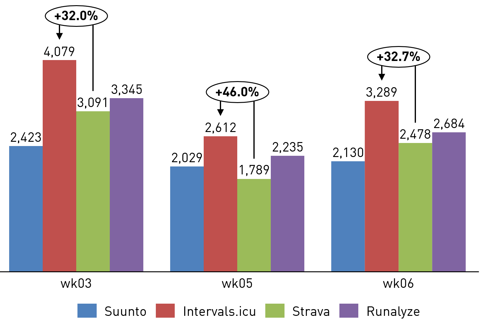

Hi @david again!
Few more weeks data in since you updated the code.
Wk04 is missing as i was sick.
FYI - versus Strava, intervals.icu is populating now 35% higher elevations gain on average of these 3 weeks.
Let me know, if you need any more updates on this.
Many thanks!
Vero
Drat … I have changed your settings to not use elevation correction for runs.
THANKS!!! :slight_smile:
