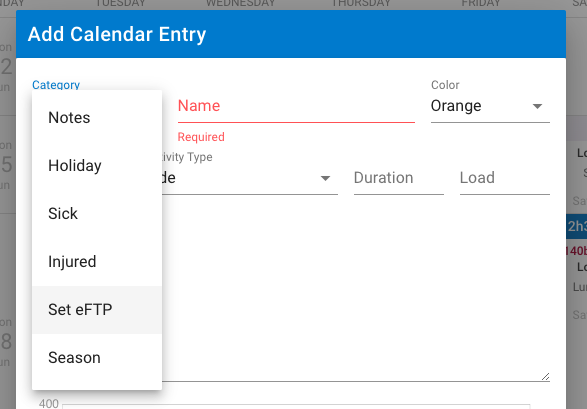

Hi, It seems like my eFTP is based on last season. I started a new season but still it did not affect my eFTP. When I look at my eFTP for my current season, then it is 70 watts below that of the previous season and I have a gap of several months of no training. On my activities it shows an eFTP 10 watts below that of my previous seasons eFTP. How can reset the eFTP for the new season?
You can add a new entry to the calendar (click in a blank space at the start of your season) and change the category to “Set eFTP” to reset it.
Thanks that worked 100%
