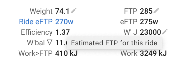

You can see your eFTP for an individual ride to see how close you were to getting it to go up:
