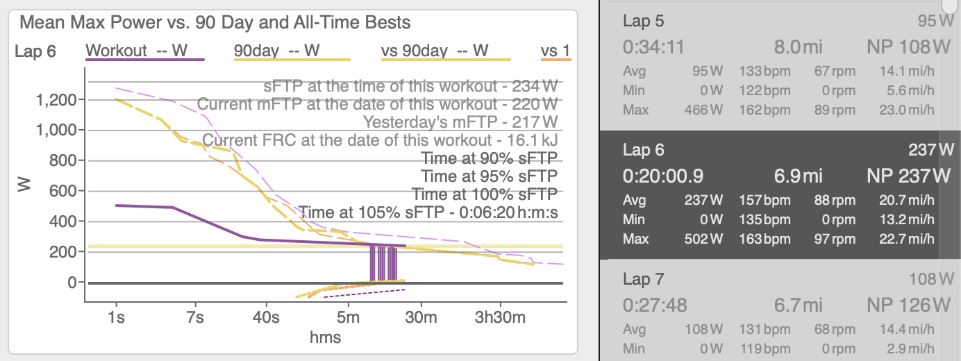

237 x 0.95 = 225.15 but mFTP = 220W
The WKO model maps your MMP to a family of power curves. At least for my physiology, WKO usually is 0.95 of 20-min max power but not always,

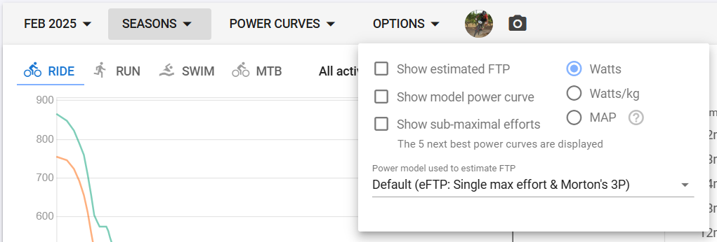

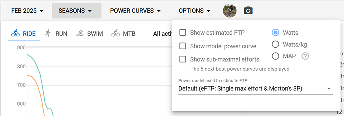

Exactly this. With Intervals, you select among the five different modeling approaches. The default one is from Morton’s paper: https://doi.org/10.1080/00140139608964484
and the raw formula is
eFTP = Critical_Power + (Anaerobic_Work_Capacity / (t_exercise - t_exhaustion_at_max_power))
(If anyone has a fully parameterized 3P formula from that paper, please post it.)
The abstract states it’s a hyperbolic curve with “time asymptote significantly less than zero” [??]. Other discussions on this forum imply that the parameters are based on real world data, which of course sites like Intervals would have in great volume.

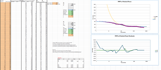

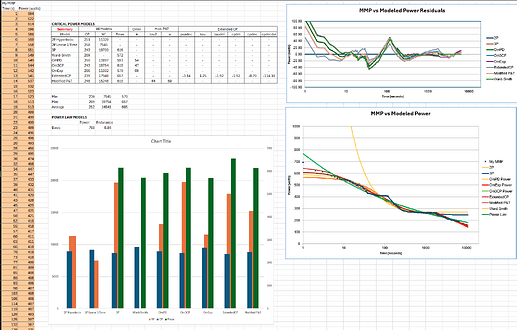

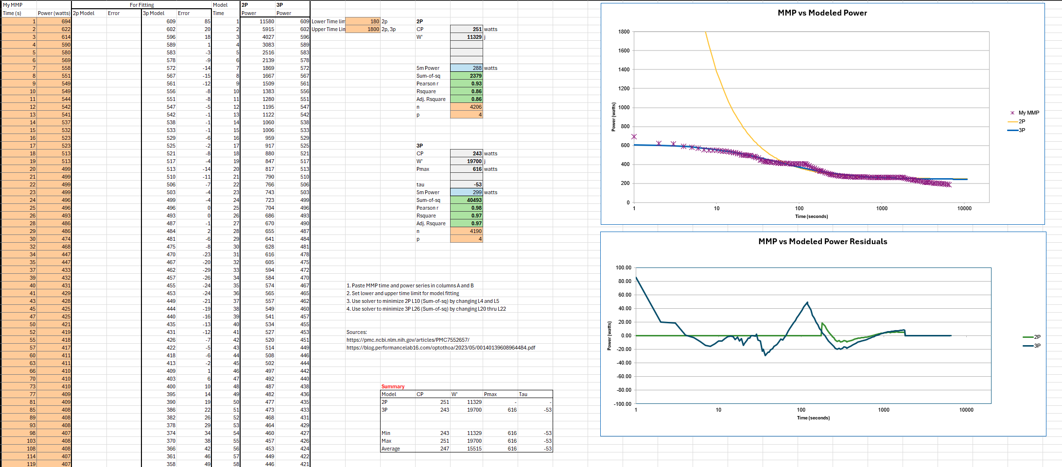

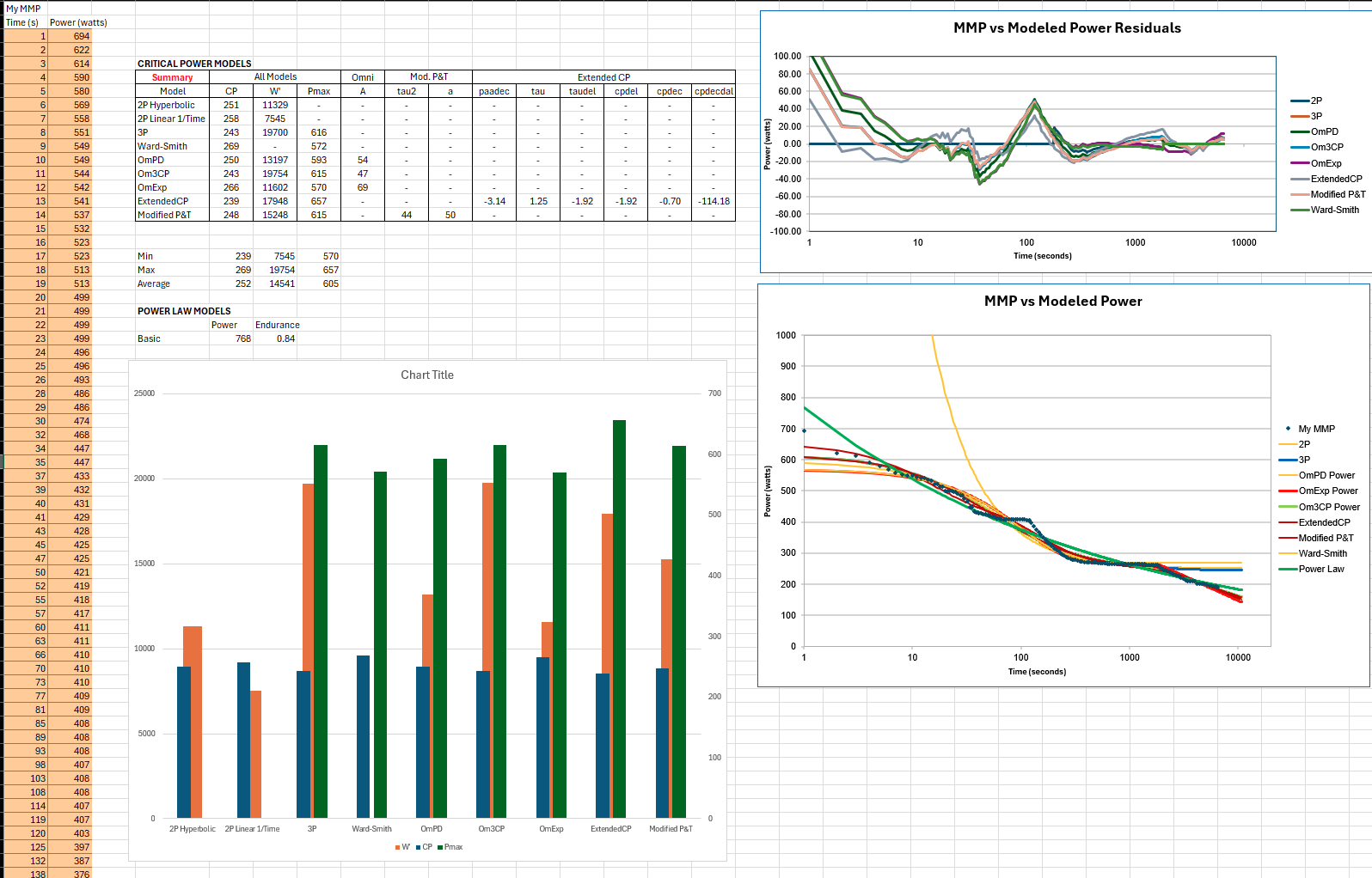

I have a spreadsheet coded that has the model for comparison. I’m trying to make is more user-friendly and I can share it eventually.

Yes, please tag me when you have a spreadsheet ready to share, even if not especially user friendly.
