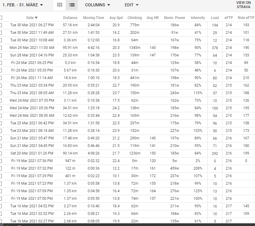

first question; how accurate is eFTP calculation compared indoor and outdoor? A mate of mine does >90% indoor and his eFTP matches his latest FTP test (on Zwift) near to 100%.

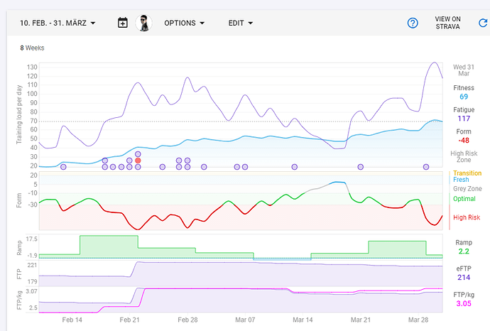

I am doing 100% outdoor, including commutes. Didn’t have the opportunity to do a test the last few weeks (tbh. didn’t have the motivation :P). My eFTP is 219 atm, and the fitness curve shows me I am deep in the red zone all the time. FTP is set to 220 since 6 weeks or more. I don’t feel like overtrained or exhausted.
Am I right that setting a higher FTP would create less load and so less stress?
Is there a way to kind of simulate the fitness diagramm with a higher FTP? I am a bit afraid of recalculating the last 42 days :slight_smile:

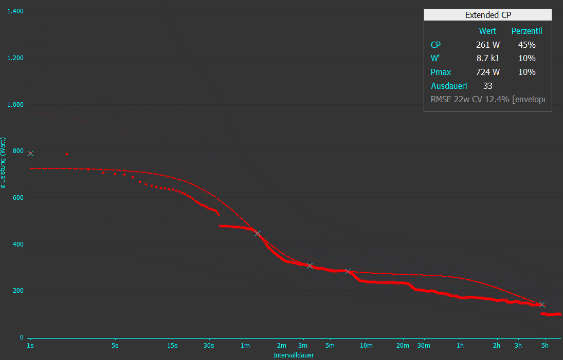

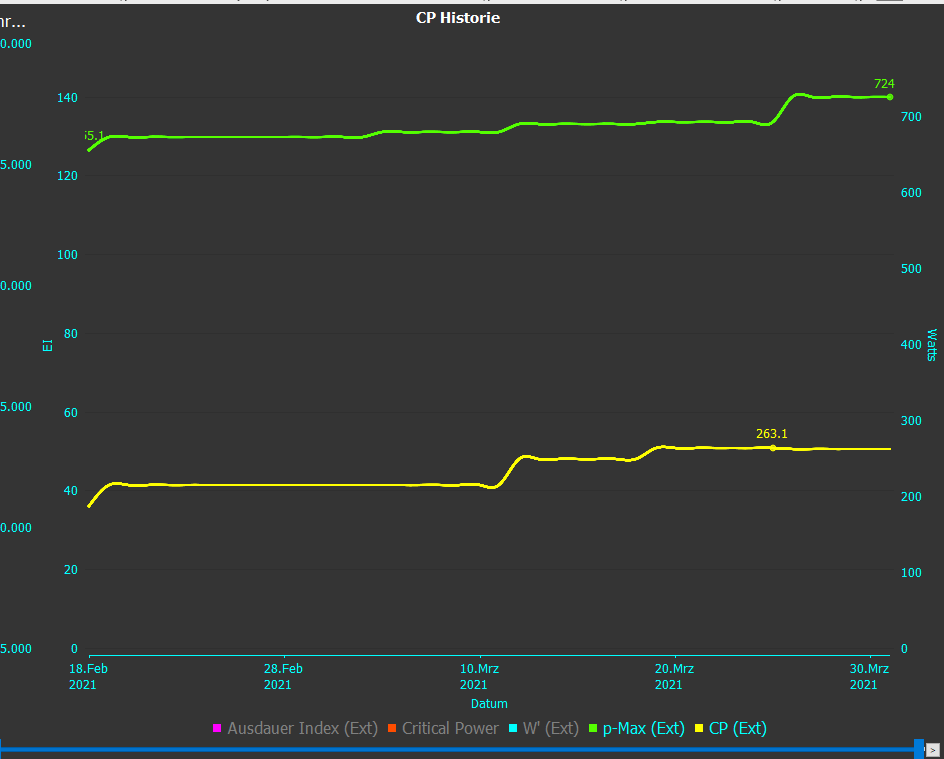

This is what Golden Cheetah calculates:
Okay, I know… this is the theoretical part. I need to add the practical one :stuck_out_tongue:

From the chart it looks like you are coming off a very low fitness base and have ramped up very quickly and hence are in the red. However it is quite likely that you actually started a lot fitter than the chart suggests. So I wouldn’t worry about all the initial red zone.
Setting a higher FTP will create less load. You can easily test that just by filling in a higher number on the activity list view. It’s easy to undo it.
But its probably a good idea to just go out do a max effort to get a new eFTP number.
Thanks, David. You are absolutelty right. I started cycling just 8 months ago. The powermeter was installed just end of January. I was not really unfit before, but I increased fitness stress a lot since then.
Your last sentence is probably a good conclusion :slight_smile:

CP from Golden Cheetah is probably a bit high because I would expect a higher W’ value at that fitness level.
eFTP from intervals is probably a bit low, caused by the absence of a maximal effort.
It’s time to put out a max effort and get the numbers right.
