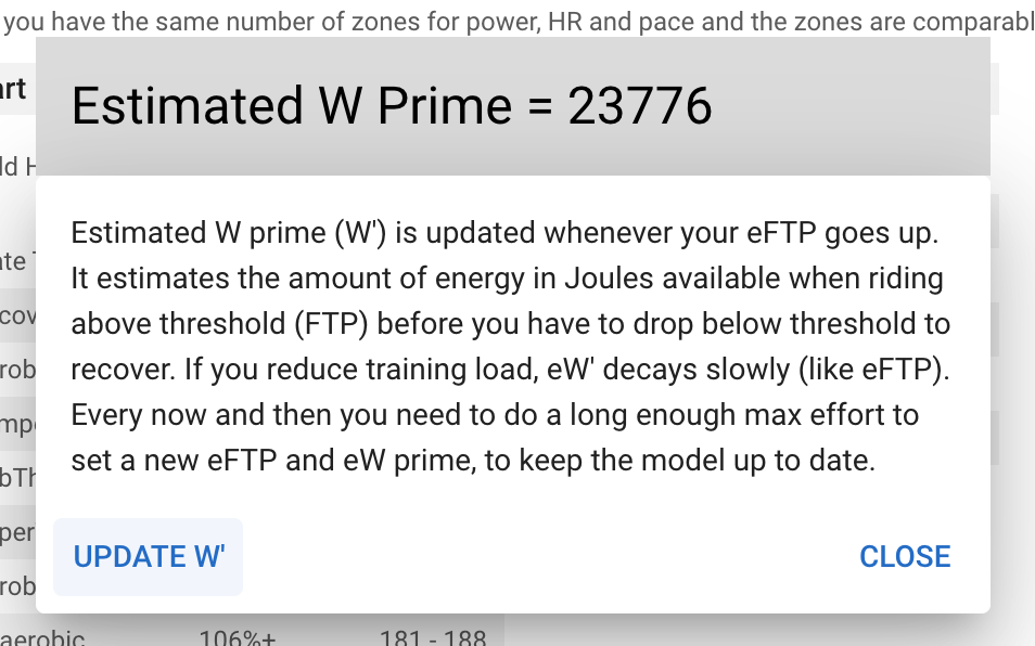

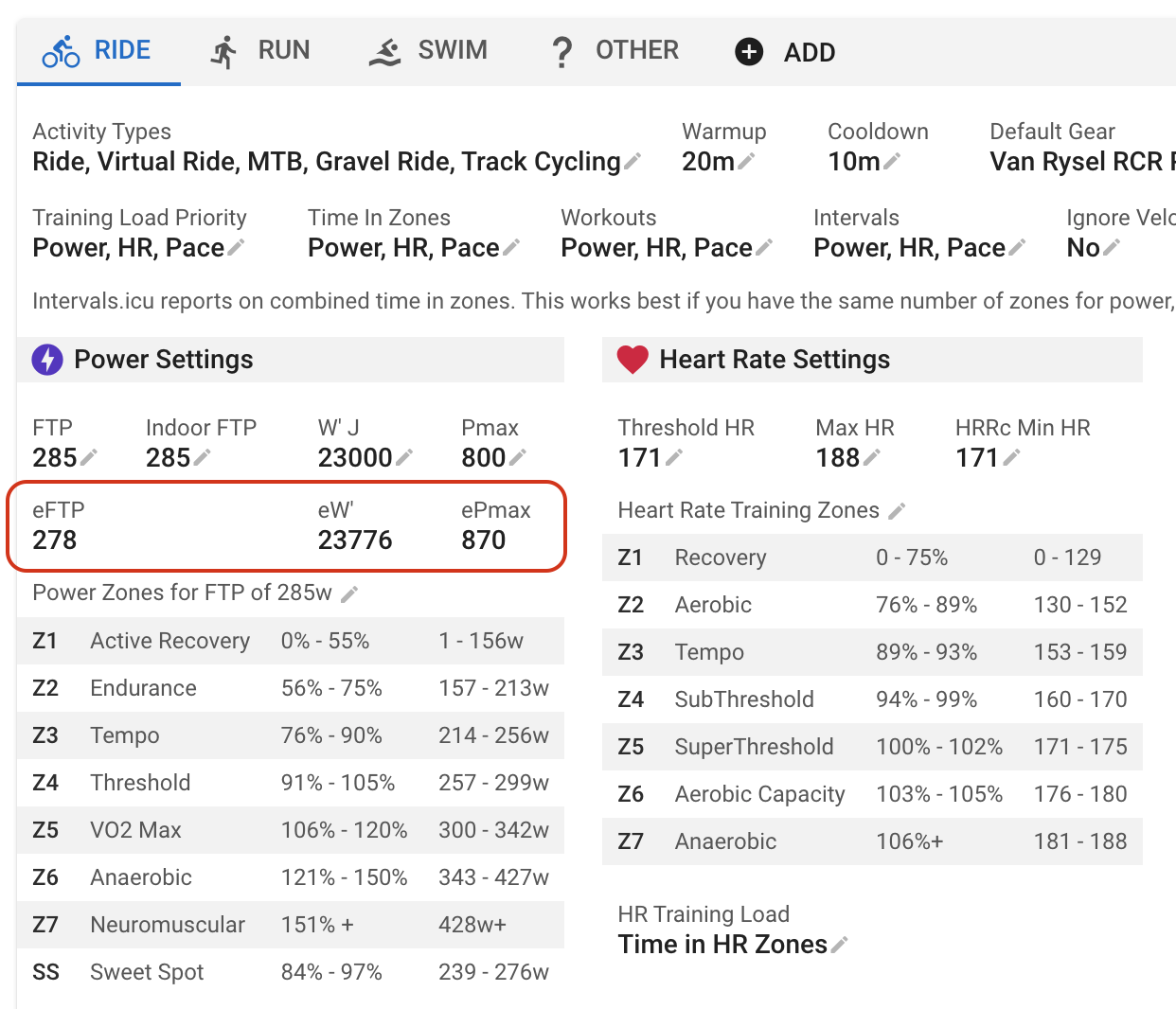

out of curiosity, which API endpoints will serve those 3 new information? /athlete/athlete.ID/sport-settings/ Haven´t found it yet :slight_smile:
It is stored per sport on the wellness records. It should be on every day. That page pulls the 14 most recent days of wellness data and find the most recent sportInfo[] entry with eFTP for the sport.

I’ve been playing with a custom activity field to set the activity FTP to eFTP, so its not changing the settings page but each activity is setup with the current eFTP. Anyone know a reason why this wouldn’t work? Thought it might be of interest to folk.
  activity.icu_w_prime = wellness.sportInfo[0].wPrime;
  activity.p_max = wellness.sportInfo[0].pMax;
  activity.icu_ftp = wellness.sportInfo[0].eftp;
The field is public called Fitness Signiture.
