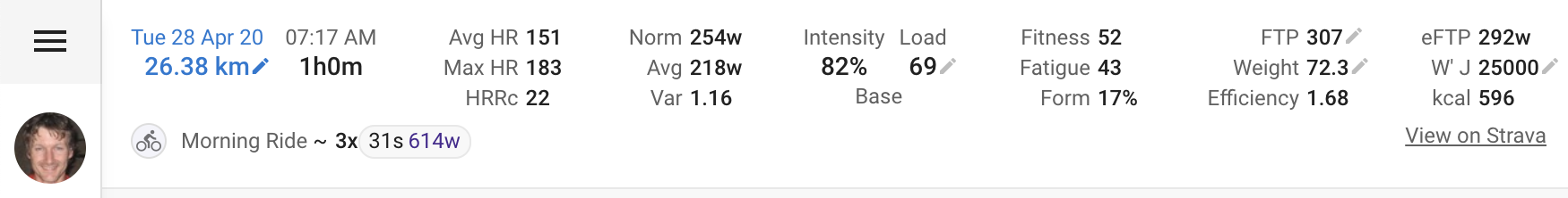

Edit distance on activities
You can now edit the distance of an activity. This is useful for indoor rides done with GPS left on and other similar issues. This has no impact other than correcting weekly distances totals and so on.
