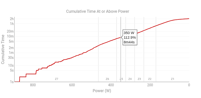

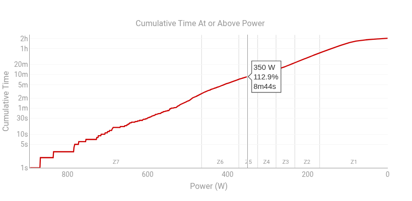

Does it help? You can find it in “power” tab, then “activity charts”:
Thank you very much for all your help. That’s awesome!
@Gabriel_Vargas this chart is very handy!

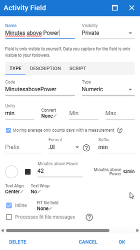

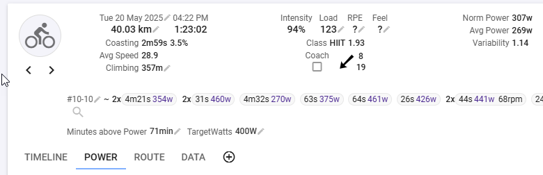

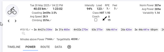

@David_R I managed to include the two custom fields (first time I did it :slight_smile: ). However the minutes are x10. In my example the time above is 71 minutes where it was 7 minutes. Do you know what I did wrong?
@Gabriel_Vargas
22-05-2025_16-44-31

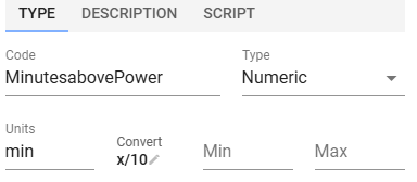

I fixed it. I had to convert it to “x/10”.
