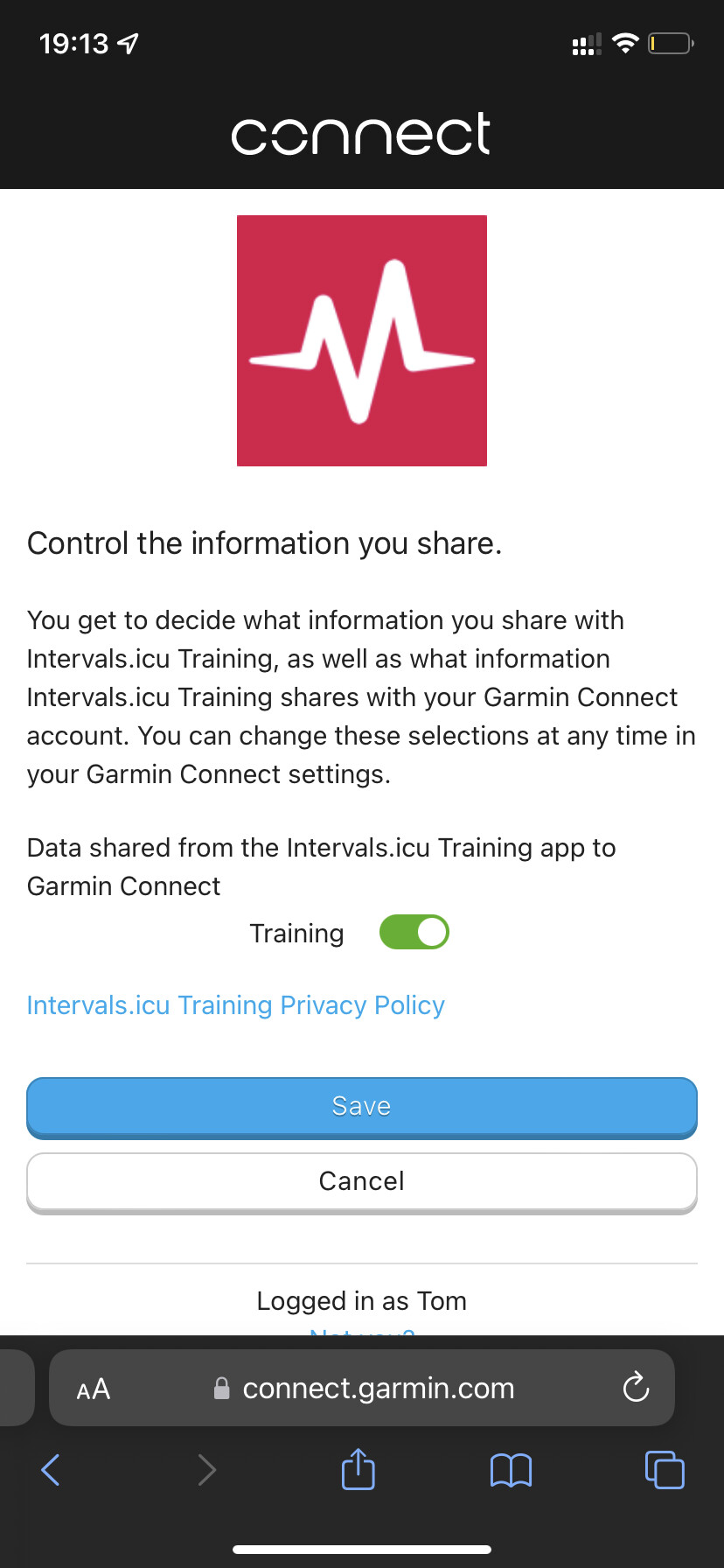

Here’s a screen by screen (iOS) view of what to do:

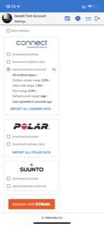

Open settings in Intervals
Scroll down to get the Garmin block and tick the box that shows the upload planned workouts (bottom tick box)

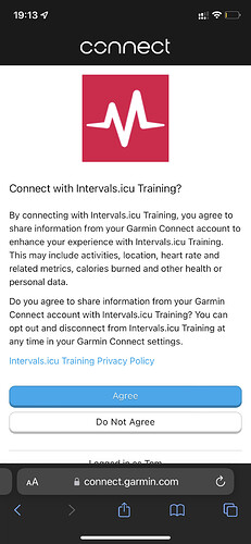

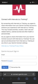

It will ask you to log in to your Garmin Connect account
Once you enter your details, accept the next two screen messages.
It will bring you back to the settings page. You can tick the other boxes, to bring your workouts back into Intervals

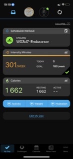

Go to the calendar (Activities page) and see if your workout for today shows

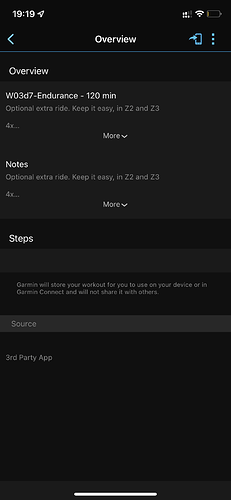

Go to Garmin Connect and you should see today’s workout showing.

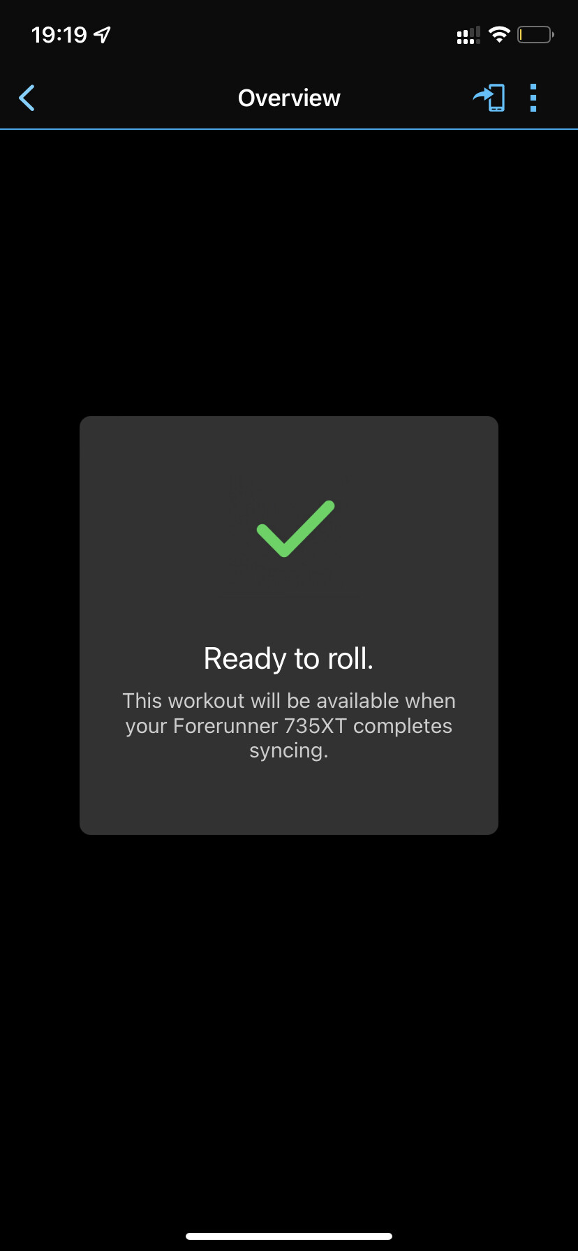

Click on the workout

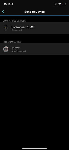

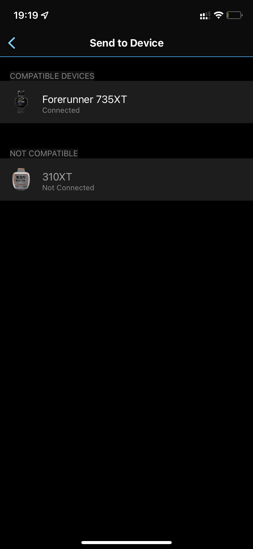

It will show some details like below. Click on the Send to Device.

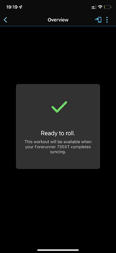

Select the device you have (could be more than one.
The you should be “ready to roll”.

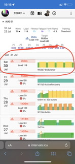

Hello everyone
For me it is impossible to implement several training sessions blocked at 4 days I tried to duplicate a session already put in my GC calendar ditto impossible to add it?

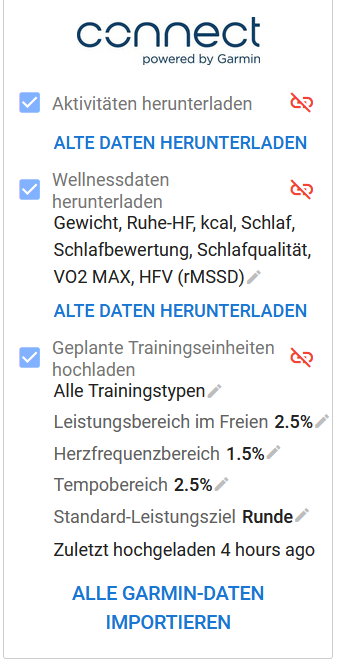

Have you set everything correctly here?
I plan my workouts in intervals and don’t worry about anything anymore. Intervals automatically pushes seven-day scheduled workouts to Garmin. If I only have one workout scheduled in the seven days, then only one workout will be postponed, no matter what is scheduled in the next seven days.

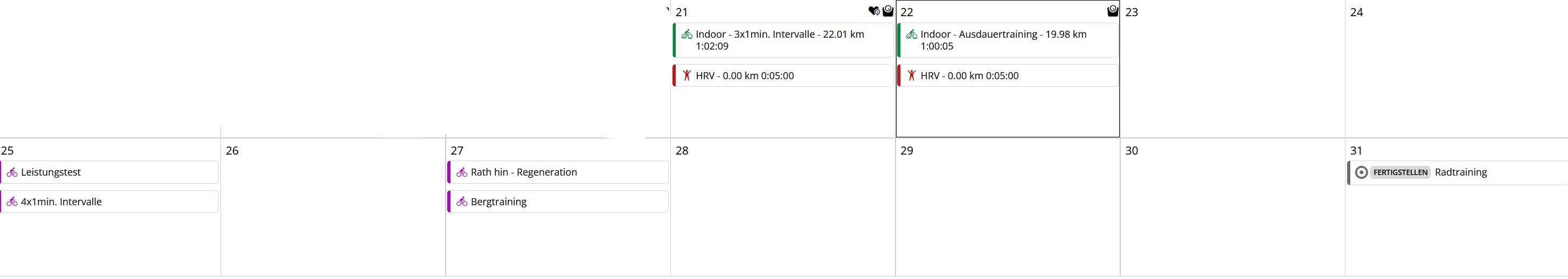

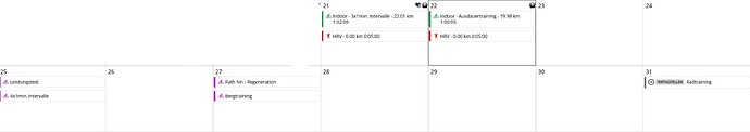

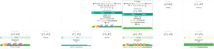

Maybe a picture says what I mean better
Garmin above
below intervals
Intervals.icu uploads the next 7 days of workouts to avoid cluttering devices with stuff far in the future. This happens every day so you will always have the next 7 days available.
