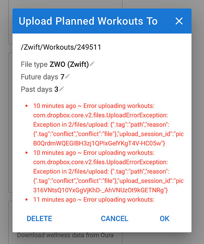

Issue with workout builder sync to Dropbox. It works for a few days, then I get this message, have to delete all connections, works for a few days, then fails again. Need some help as I rely on works being pushed to Zwift.

It happens if you modify a workout that already exists. Assuming that your settings are to sync the next 7 days (default), a workaround until a fix is provided is the following: (1) move (drag) the workout somewhere after 7 days from today, (2) modify it there as you please, (3) put it back. You will see then 2 messages: the first confirming the deletion, and the second confirming the new upload. Don’t forget to reopen Zwift to have the latest workout there.

It’s not what I mean. The name of the workout in intervals.icu is not what triggers the error. It’s the name of the workout in the Zwift folder. Again, try to drag any workout happening in the next 7 days, somewhere past that. You will see the message that the workout was deleted. Then put it back, and you’ll see another positive message that the workout was uploaded. Then open the workout modify something, save it and you’ll se the error again. That is, if you want to modify any workout happening in the next 7 days, you first have to force its deletion by moving it past the 7 days, then modify it, and only then putting it back.
