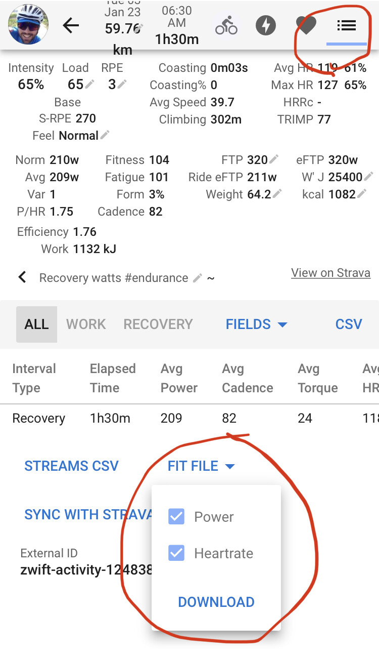

Yes. Go to the activity, go to the intervals tab and select download fit file.
Eg.
I think what @Olly_Thomas shows is an Intervals created FIT file and I don’t know if the original can be found if you sync from Strava.
If you sync from Garmin, you should see ‘Original Fit file’ as possible download.
This is correct, my mistake.
My screenshot is from a Strava activity so it’s an intervals creates FIT file not the original (as Strava does not pass/ provide the original as I understand it)
