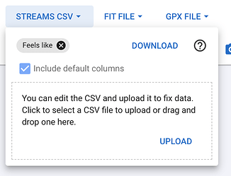

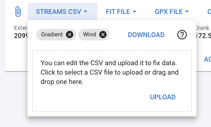

We have added a column selector. The default is all the non-computed columns and torque. Computed columns (e.g. torque, gradient) are ignored on upload.
Wow…speachless… just… thank you David :folded_hands:
If you could give me a “reference” of how do you do the grade “smoothing” (moving average of ‘n’ points…?) would be also very apreciated. Thanks again!

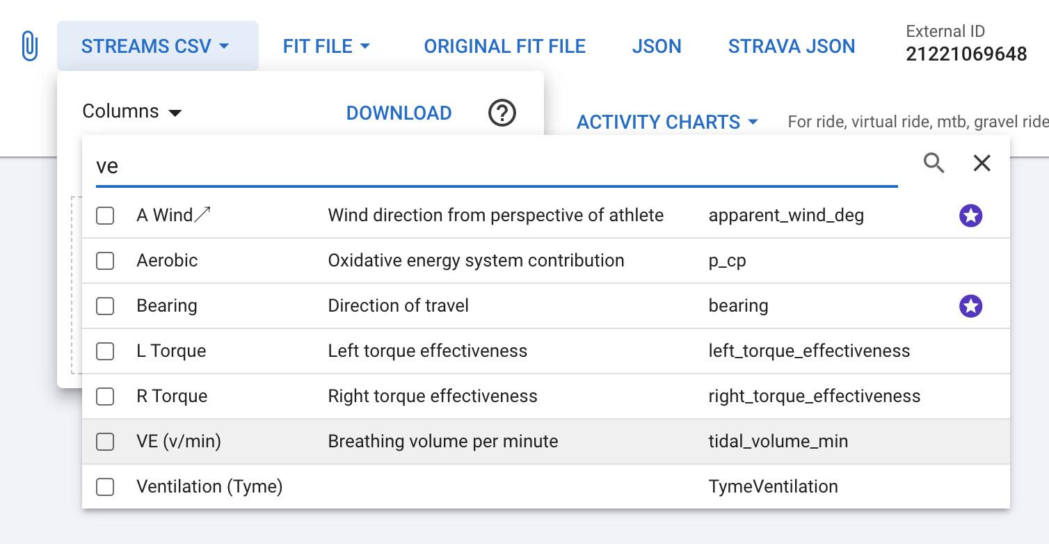

Question tho, if you select any column through the column selector, the non-computed columns “by default” don’t download, and they are not available through the column selector either. Is that the intended behavior? Thanks again!
As far as I can tell, the non-computed columns are listed in the drop down except for latitude and longitude. We have added that as well as an option to include the default columns in addition to the selected ones. This will be deployed on Wednesday AM (GMT+2).

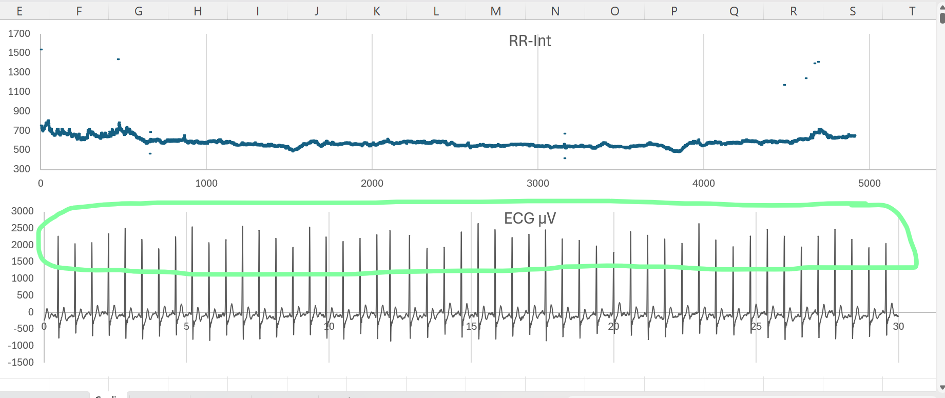

I am playing around with resprate, ventilation and tidal volume extracted from a csv created by Polar Sensor logger. As some may know, the single lead ECG from a Polar H10 can be used to extract those metrics, be it in a less precise way. The R-Peaks change in amplitude following the expansion of the chest because the sensor get’s further away from the heart and thus the electric signal is slightly weaker. I have all three signals and created a csv with comma as delimiter and number format in English US. The length of the csv is exactly the length of the entire activity in Intervals. But I’m always getting an error when trying to import the csv.

For those curious how the Polar sensor ECG looks: pay attention to the waveform of the R-Peaks.

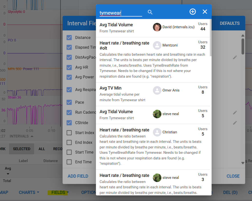

Is there any reason why I don’t get the Tymewear fields shown when I click “Fields” in that view.? They are enabled in custom streams and I can access them elsewhere
You also need Custom Fields for those. Click on Fields - Looking Glass and search for Tymewear fields to see what’s already available.
I can see them on one of your activities and they are included in the downloaded CSV by default?
@MedTechCD You do not need to add any custom fields to get the Tymewear streams. It’s all built in now (VE, VT and respiration).
Thanks . I was looking in the wrong place

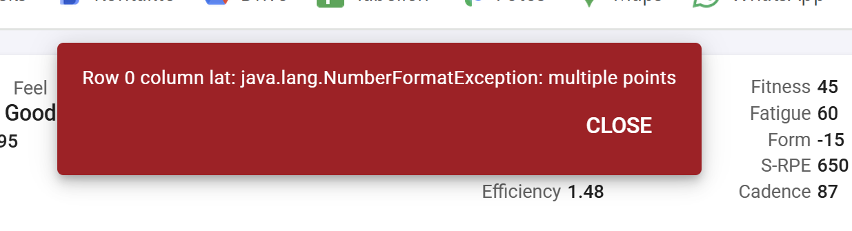

Just tried it out for two different activities. 1st time worked perfectly without issues, 2nd time I got his error:
Any idea what is wrong? I have added two columns of data, did not change anything else.
Before uploading, ensure you have created the placeholder custom streams for each of the two columns. Verify that the custom stream codes exactly match the CSV column headers. Also, confirm that the CSV time column starts at 0 and is sequential.
