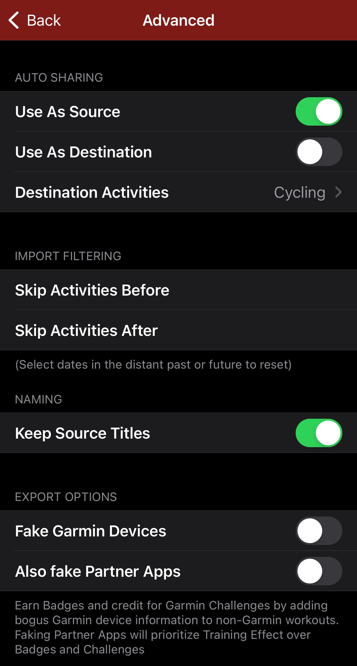

However RunGap will send my walks (Apple Watch) and weight lifting (HR data) to Garmin Connect, and then GC will send to Intervals, Strava, TrainingPeaks, etc. Not sure why it works, but it does.
RunGap like BreakAway, will fake the device the activity it was recorded on.

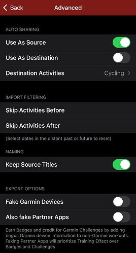

Reason I said that is because apparently it does that without the Fake option enabled.
or I don’t understand that option.
Without looking at the source FIT file that RunGap uploads. We won’t know for sure.
I’ve looked before, and again just confirmed that manufacturer is set to 255 (development) under File ID and Device Info messages.
