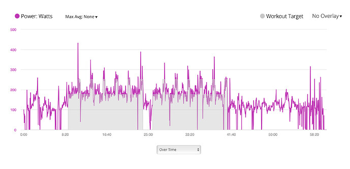

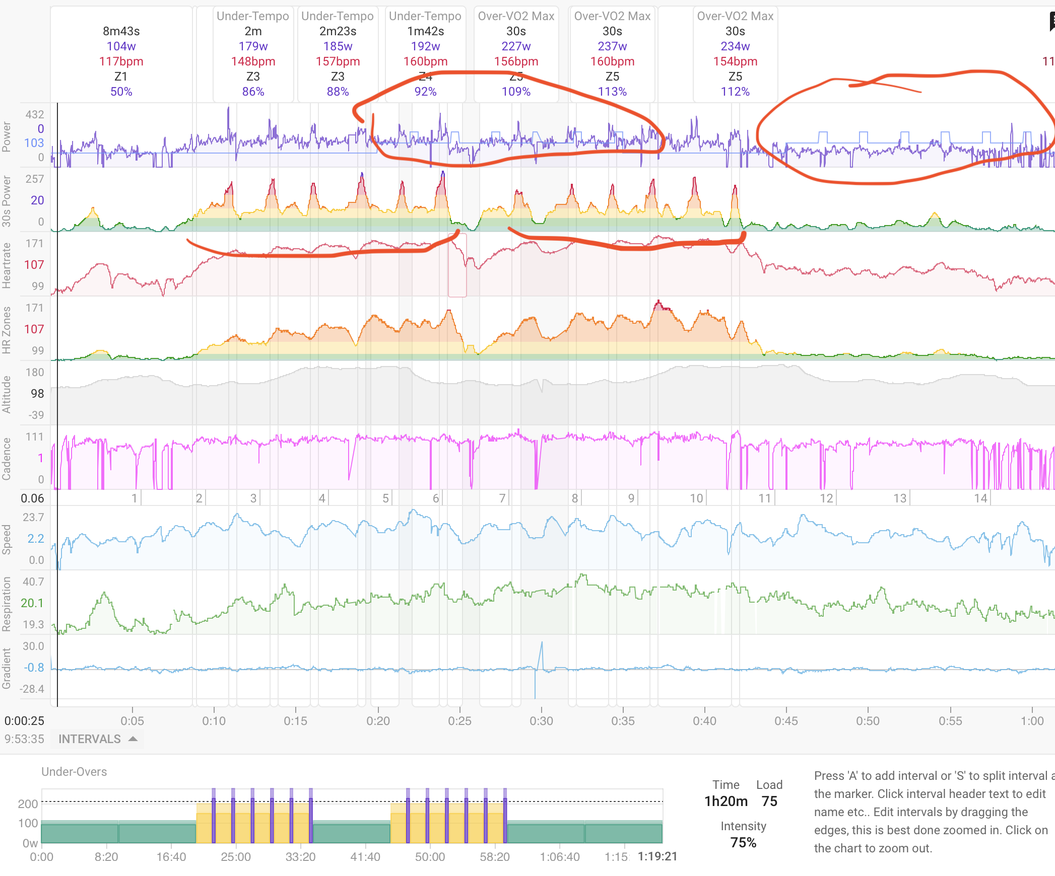

Just adding a few more details for this from a workout today, showing the workout target power out of sync with the actual workout steps.
Could be the lap presses? I used them every segment in this workout (as I usually do, to get myself into the right place), and I can see the offsets vs Garmin, as intervals is seemingly miscalculating the step starts and durations - in fact it looks like intervals pushes them too far down the workout - for example in this ride I just stayed on in the cooldown and did some extra zone 2 riding as it was so sunny, so the intervals were nearer the start as per the Garmin screenshots.
(I had 5 x intervals repeats but skipped the fifth with another lap press as I could just feel early warning signs on my calf so figured 4 was en ought for today).

Here’s the Garmin workout steps and the first part of the intervals from the corresponding workout. From what I can see from the conversion, a step that is purely a lap button press with no duration in Garmin seems to translate to 10m in intervals but they may be a red herring.

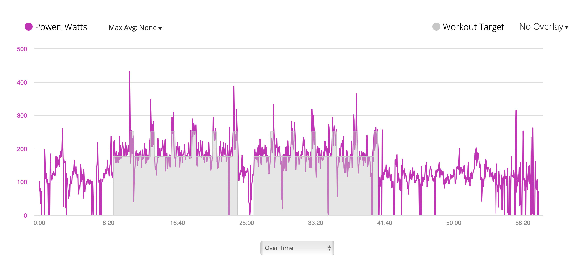

Haven’t visited for a while - but did a structured workout today and was reminded that the target still doesnt sync properly on intervals - most likely the use of pauses (both in the workout and just pausing manually) and how interval interprets them.
Would be great if they lined up properly one day…
(Intervals, with workout extracted)
(How it should be, shown on Garmin Connect)
