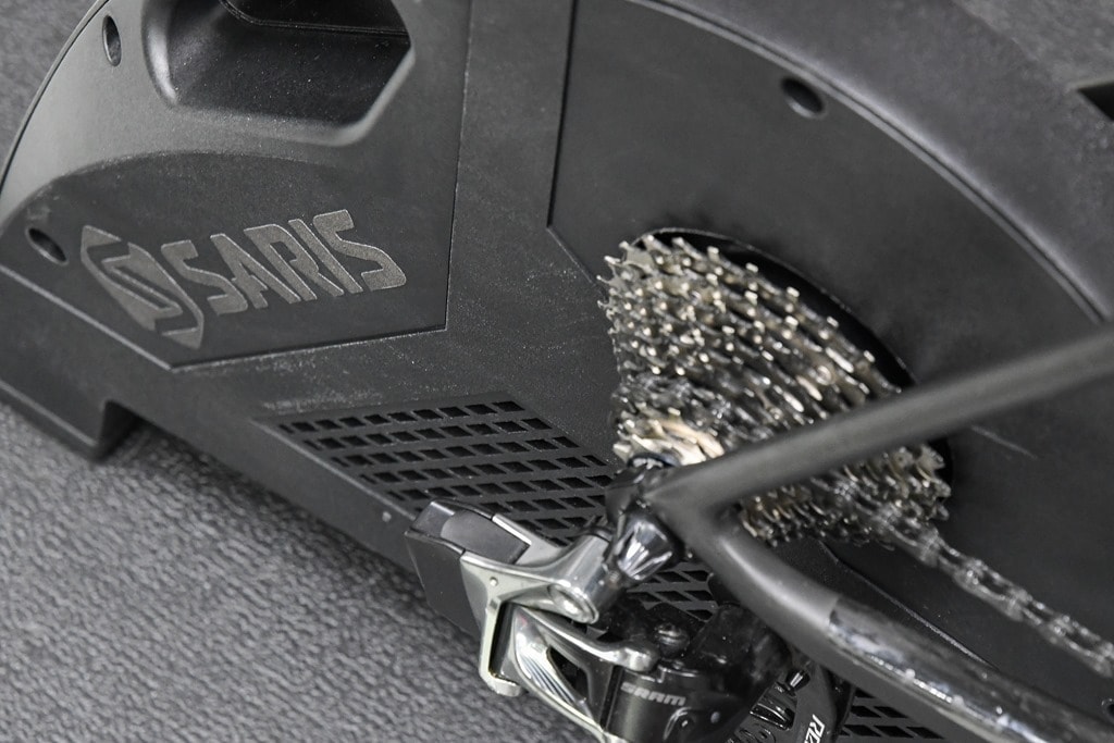

I have two power meters: (1) a Stages left crank and (2) a smart trainer. There’s a fairly large difference in readings (30-50%).
What would be the best way to determine which is the more accurate? (Ex: go to a gym and ride one - or several - of their bikes; compare with an outdoor ride; compare hr and power zones)

@MedTechCD Thanks for pointing out that the smart trainer is perhaps “making up the data”. As per your suggestion I’ve pedaled to reach "a stable power, and then stopped applying pressure still slowly rotating the cranks to prevent cadence from dropping to 0. As far as I can tell, power 3s average drops to 0 within 3s, and the flywheel is still turning, so it seems that my trainer (Saris H3) does indeed send power data.
FWIW, my FTP went from 215 down to 150 since I switched to the Saris. I am m69. 205 certainly wasn’t elite but 150 is suspiciously low and doesn’t seem to match my experience (time to complete a course, maximum daily distance, etc.) or other fitness metrics (ex: “superior” Vo2Max) whereas 205 didn’t raise doubts.
On the one hand, it doesn’t matter because after a while power zones will fall to their new equilibrium. Still, i’d like to get a third (or more) source in order to clarify this.
I still have a couple of weeks to decide if I return the trainer.

But it feels a bit strange that a high-end trainer like the Saris H3 is so different to the Stages single side PM. Stages may not be the best out there when it comes to accuracy, it is far from the worst either. Given the single side measurement, a difference of up to 10-12% could be explained, but surely not 30-50%. Something must be wrong with one or the other, or you have a huge leg imbalance.
Do you happen to have a friend that owns an easily swappable power meter? One of the pedal power meters for example? If so, ask if you can use them for a short test on the trainer to compare what they return.
Well, first I’ll rig another her unit and display power readings side by side. Next step in the plan is to hop to the nearest gym and try their bikes. And then, ride an uphill course, once Spring is with us. (Does intervals provide power estimates for outdoor segments)
