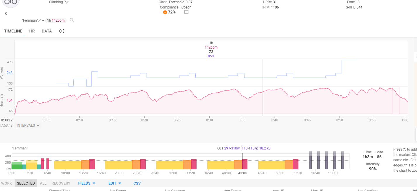

I have the issue that when I have created a workout, have drag and dropped it onto the recorded activity. Then the workout graph seems to have a “different time scale” or something, than the HR graph…
See example below:
In the bottom graph you see that the workout is more 1h3min. The recorded activity is ~=1h. But still in the topmost “workout-watt-graph” the workout starts at ~5min and ends at ~52min, as if if was only ~47min…
This makes compliance pretty bad…
This has not been a problem for me before the 4th of April and to the best of my knowledge I am doing everything the same as before when creating the workouts…
Anyone else had this issue and/or knows what it could be?
Show the workout structure because something is wrong with the blank areas in the bottom graph.
Those are being skipped in the workout graph.
Ahh, I had no percentage intensity on the rest! Thats why it was skipped, thanks! :grin:
