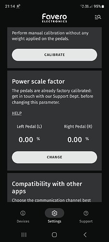

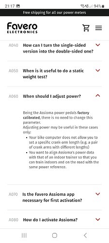

There is an ´alignment´ possibility provided in the Favero app. I have duo, so things may look slightly different for uno.
