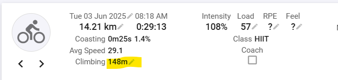

I uploaded a .fit file from my workout to Intervals.icu. The file contains total_ascent = 164 m in the session section (I verified it using FIT File Viewer). However, after uploading, the Climbing value shown in Intervals.icu is only 148 m.

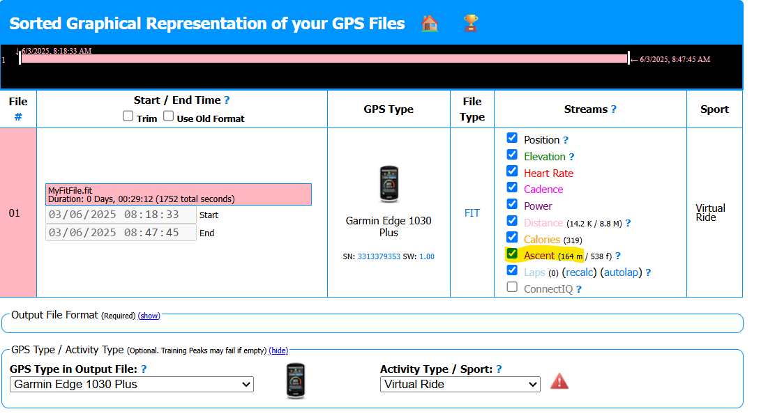

The Total Ascent field value is effectively 164m
So I would expect Intervals to simply display that. But I have never doublechecked that for a virtual ride. And when I upload your file to my Intervals, it is as you say, 148m.

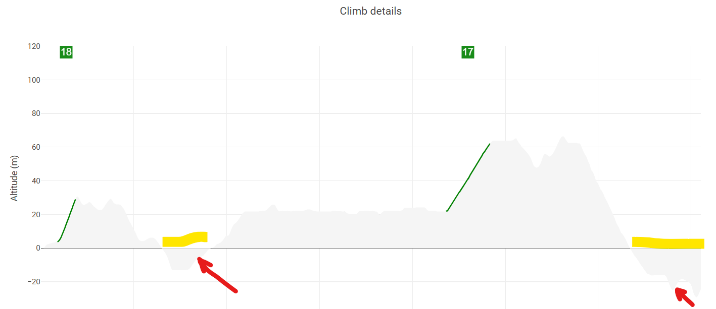

Looking at all of that a bit more in depth, there is negative altitude data (below sea-level) in the activity file (yellow highlighted)
And the difference 164 - 148m = 16m, is almost spot on with the sum of the below 0 climbing parts marked with the red arrow.
What I think is that somehow, Intervals by default, recalculates ascent from the elevation if the source is a virtual ride and discards (wrongly) climbing meters that are recorded below zero.

The FIT file indicates it as a Virtual Ride coming from a Garmin Edge 1030.
