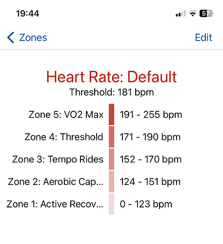

the zones are like this

HR Zones:
For both me and my athletes, there is always some difference despite having the zones equally defined.
