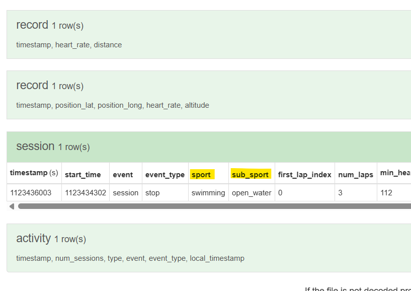

Depends on what Garmin writes in the FIT file for those meditation sessions.
Check one of those files with Fitfileviewer.com to see what it has as Sport type or Sub-sport.
Look for column headers sport and/or sub_sport.
Once that is clear, the correct type may be added.
sport: meditation
sub_sport: generic
