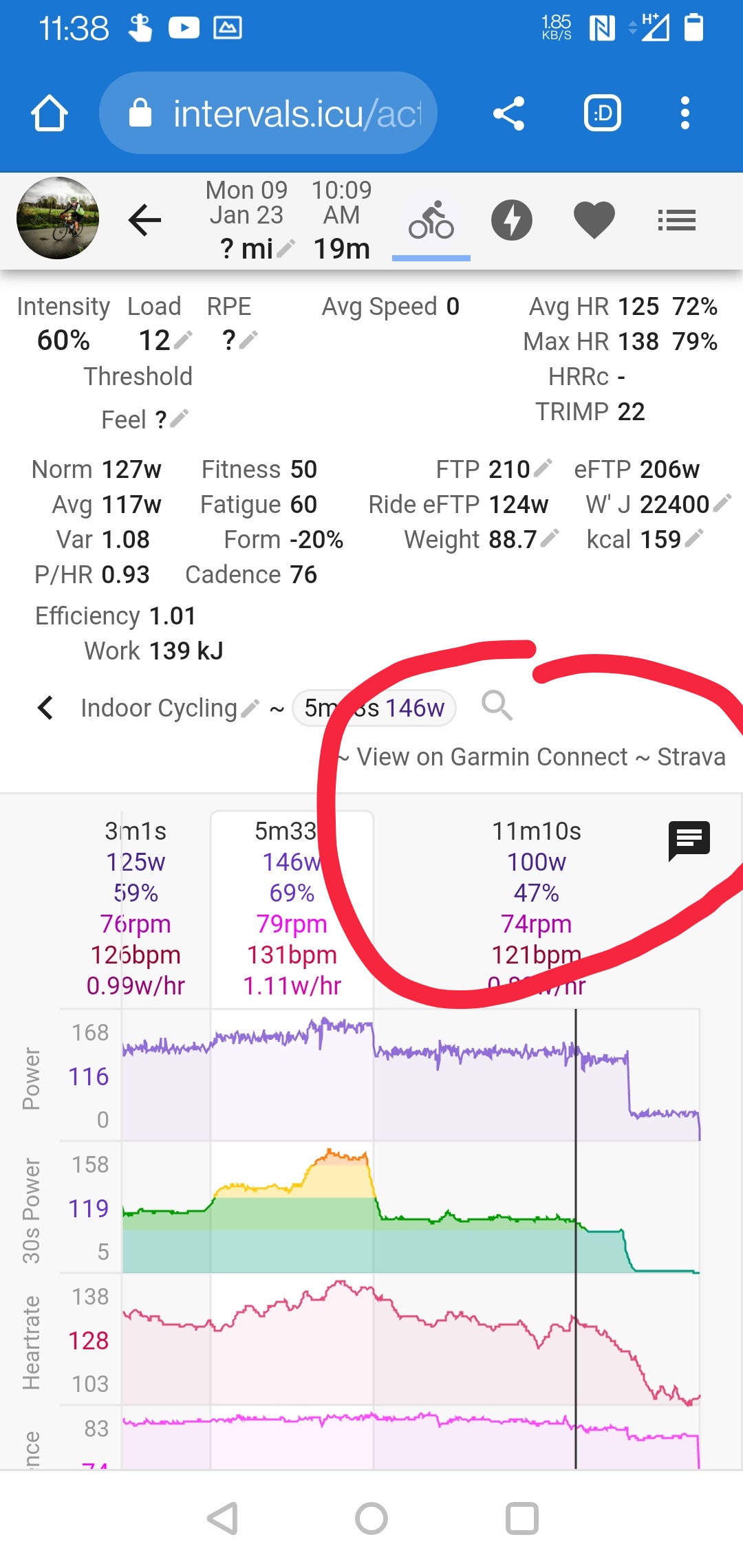

That is unfortunate, but understandable. Related question, how do I split these up again?
The Strava synced ride was the Kickr recording, the manually uploaded ride contains my bike’s powermeter. Intervals grouped them together automatically. However, it only shows the bike’s PM data. Since they differ by about 20W, I would like to access both readings. Which is the reason why I bother recording them separately in the first place.

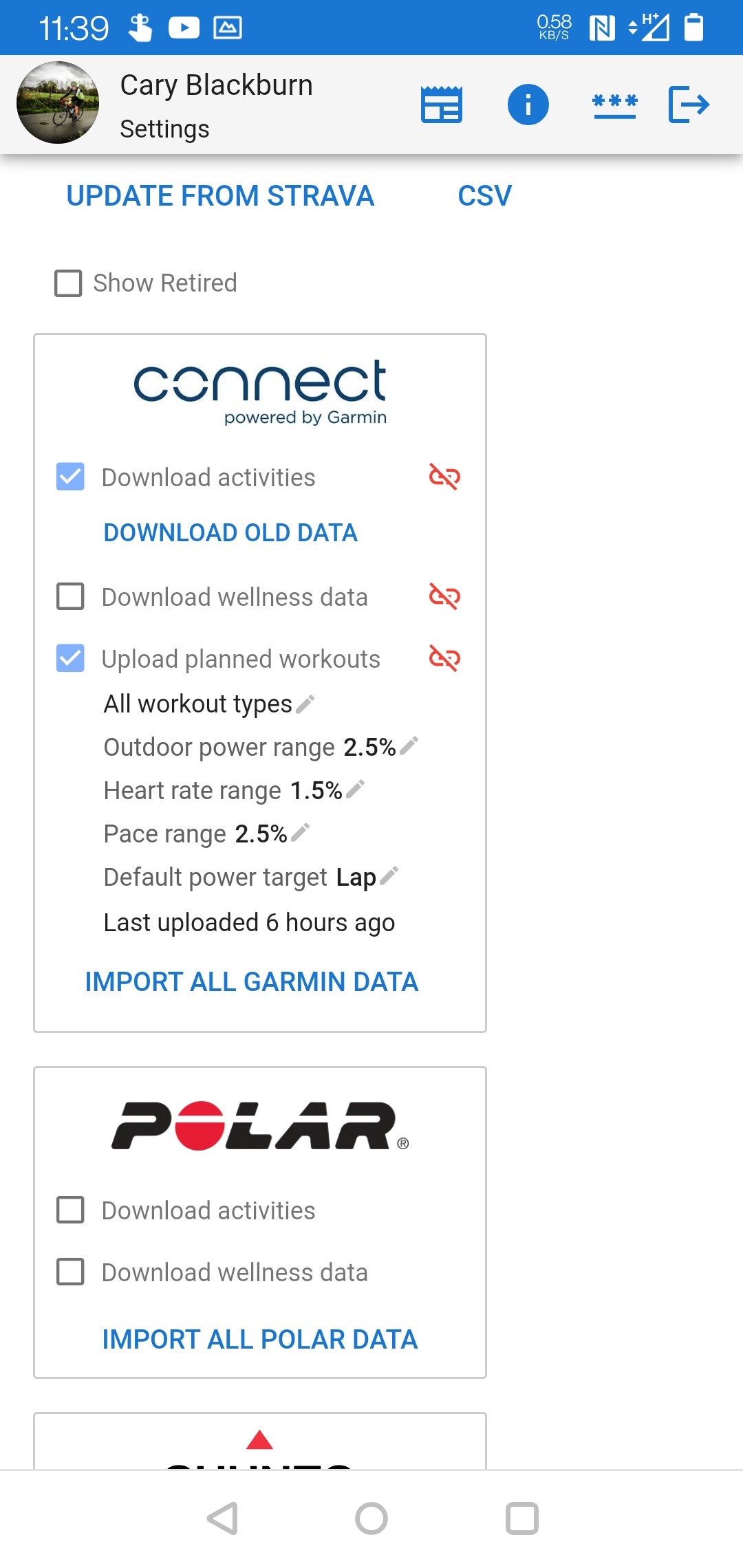

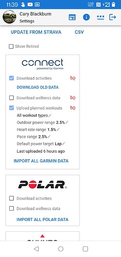

Perhaps try linking intervals to Garmin as well as Strava. Intervals matches them up and when you delete the Strava file the ride remains on intervals.Screenshot_20230109-113915|236x500
That works! Thank you, Cary!
