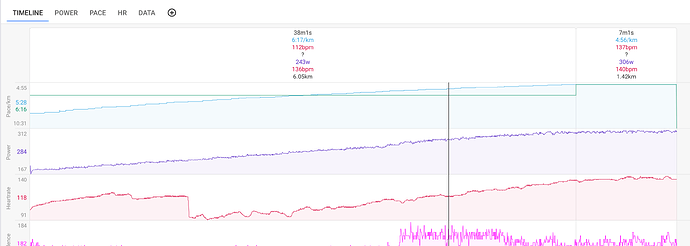

OK, thanks @Adam_Donaldson , but I don’t understand why I need to set my power zones for running if I don’t use (or don’t have) power to detect intervals as laps. Anyway, I just set a number and again the decopuling is not working on the first 2 laps, just the last one. I also now get the average lap power number I was not getting before even if the laps were correctly recorded. I am attaching the screenshots.
Hi Marco,
I haven’t looked at this for a while, but I refactored the script to tidy up some bad code. Let me know if this works any differently for you. It may not solve anything, but try re-analysing some activities that didn’t work and see if its any better.
May not do anything, but worth a try if you still use this.
Cheers,
Adam.

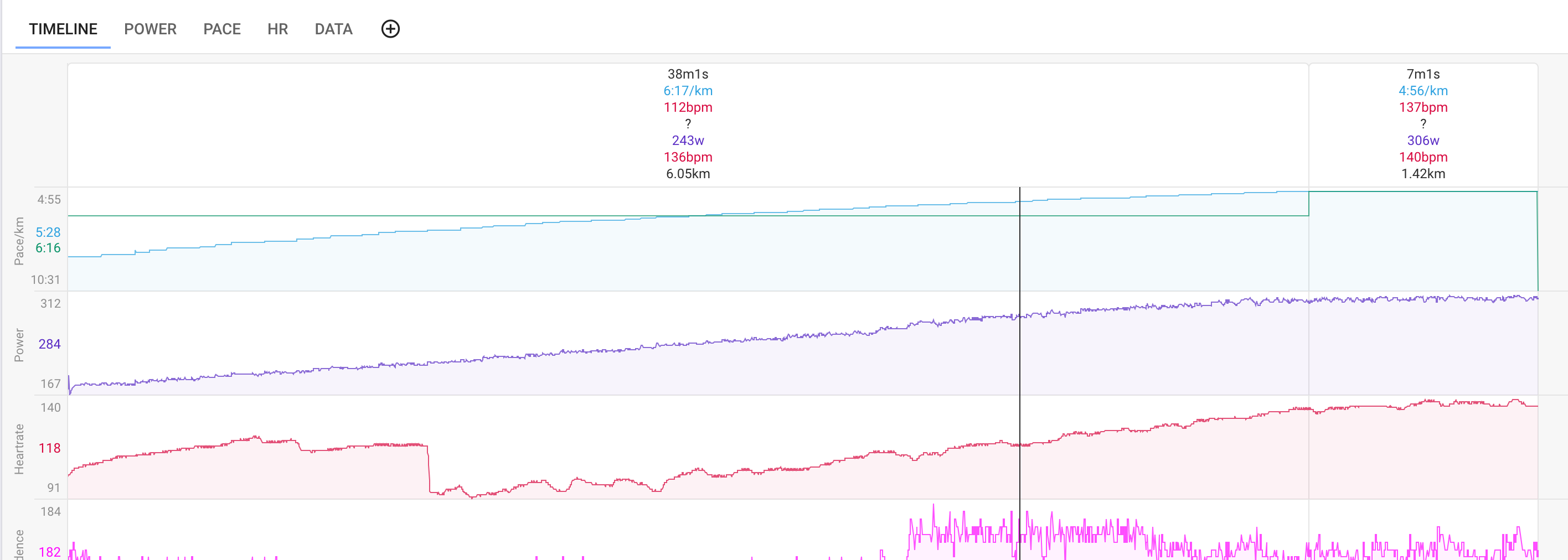

Thanks @Adam_Donaldson. Not working. Screenshot of today run (where “?” is you field):
Sorry Marco, I’m not sure what is going on there. If it was easier to debug with your data locally and someway to step through what was going on I might be able to figure it out, but at the moment I’m not sure.
It seems to work for me most of the time now, but I haven’t done to many tests.
If you need something from me just let me know!
