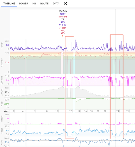

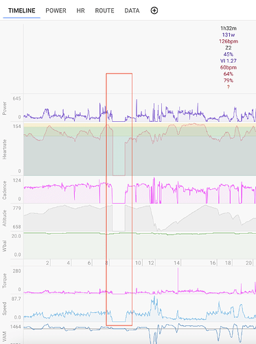

Data gaps/missing on Activities uploaded from Wahoo

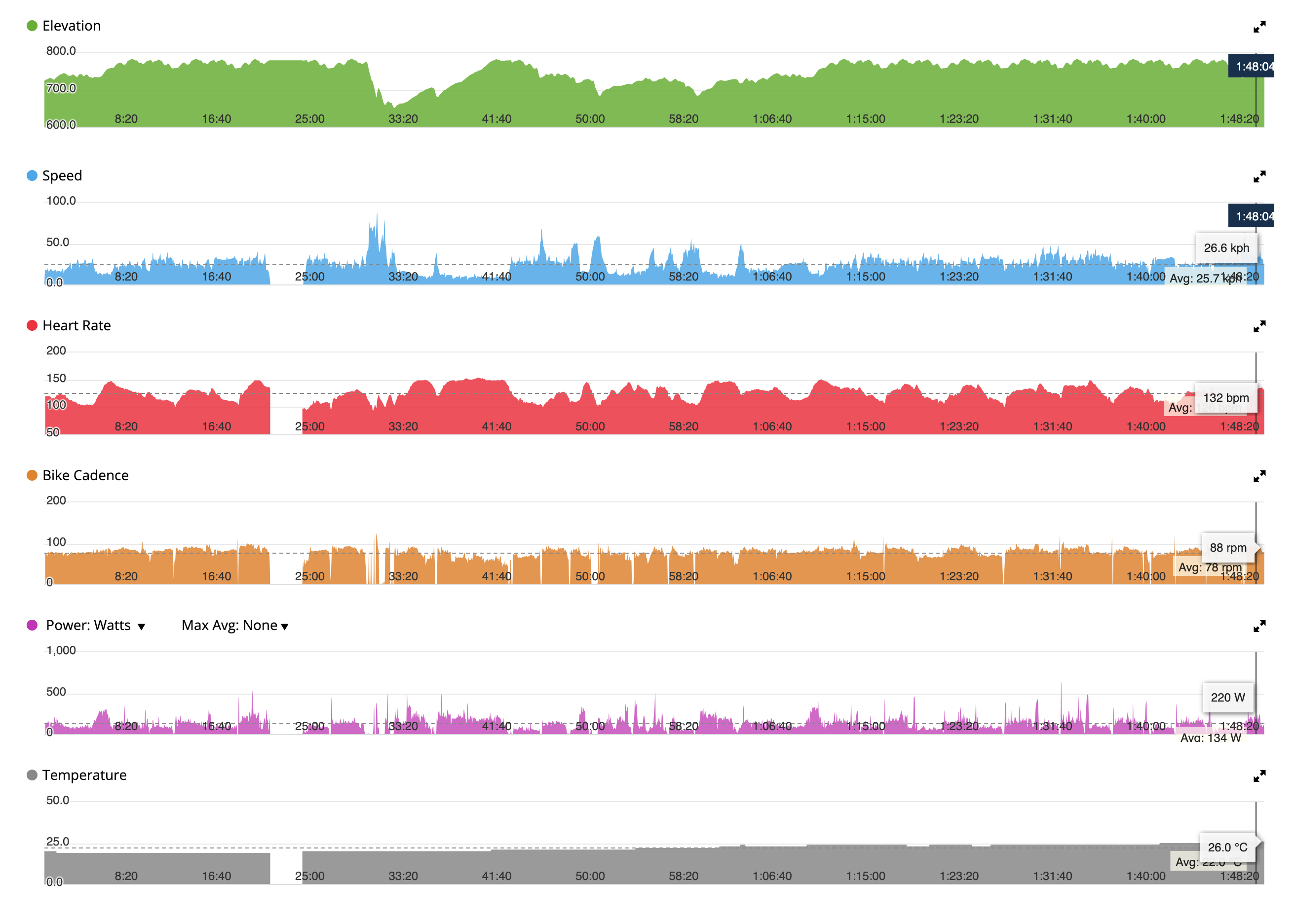

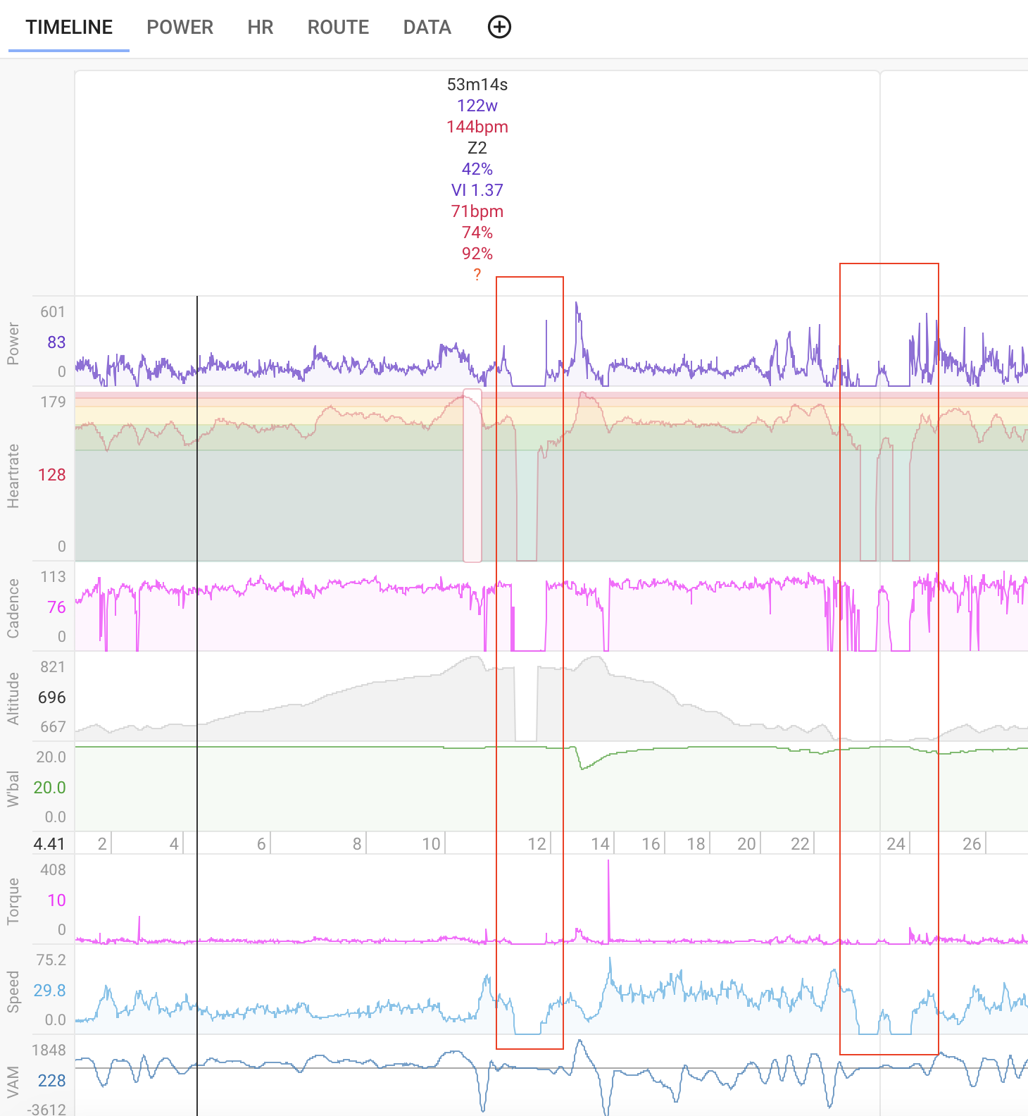

Sup guys. I’m seeing a frequent issues with my activities uploaded from Wahoo. Some data goes AWOL, even elevation data simply does not show on streams; it’s very random. Looking at other platforms (Strava/Wahoo itself/Cycling Analytics/TPeaks), I do not see such gaps. I’ve contacted Wahoo and provided them one of the .fit files for analysis and they have not found any inconsistence on data.
Ex:
We can’t acces any of your activities, so please post screenshots of your issue.
sorry about it, PFA screenshots.

@MedTechCD I don’t think it’s auto-pause, it wouldn’t crop elevation data as well, right? Taking today’s activity as example, I didn’t stop the bike, it’s 1h45m straight with coasting ~5%.
Auto-pause = no recording. All directly recorded streams are 0.

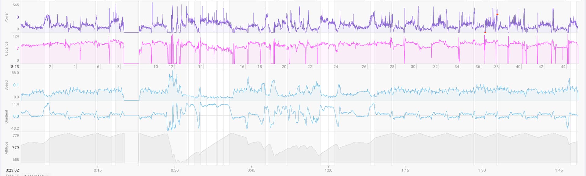

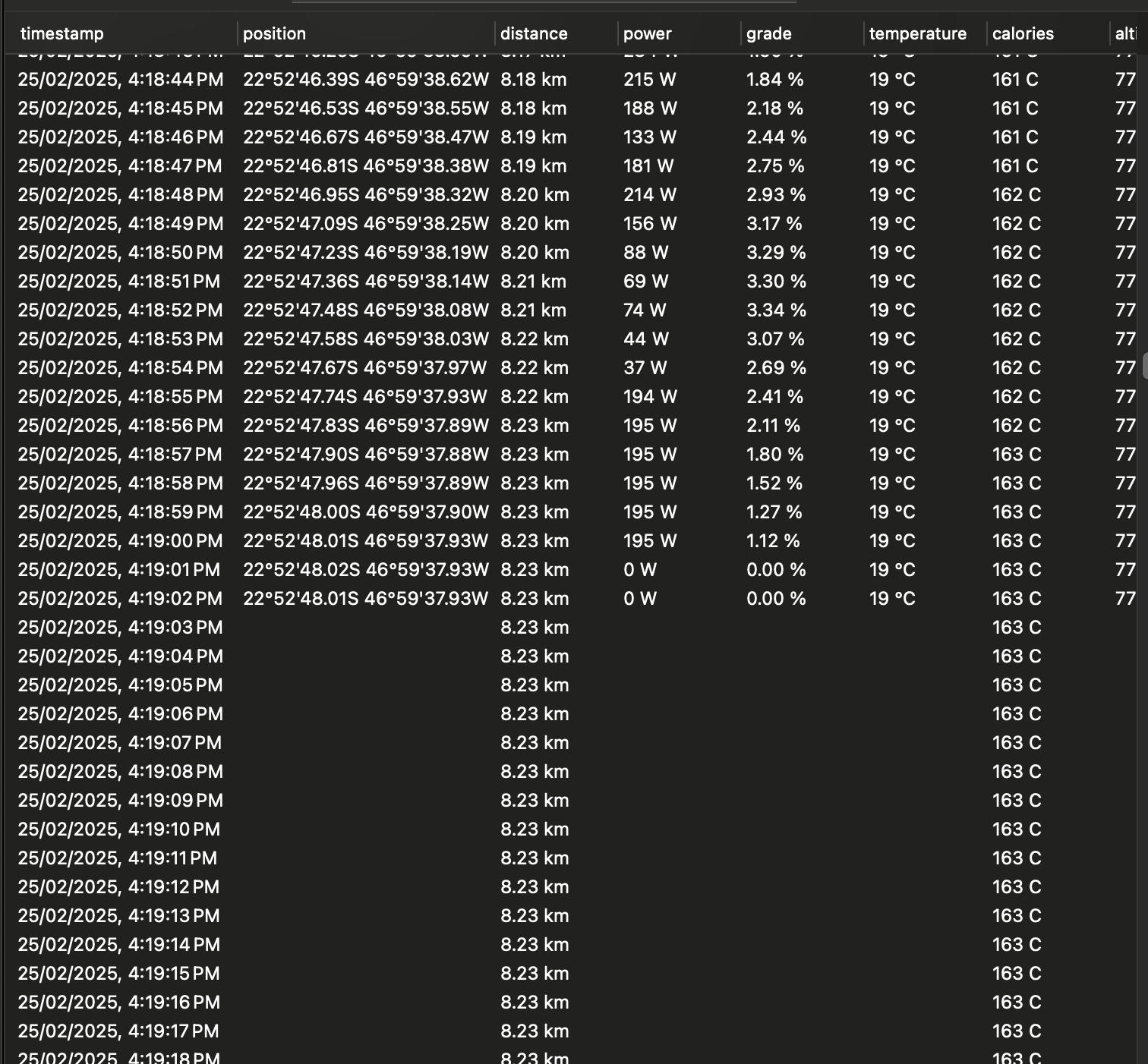

Both Uploads to Intervals.icu and Garmin Connect shows the same “blank”

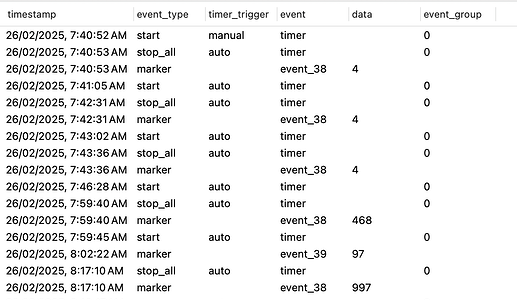

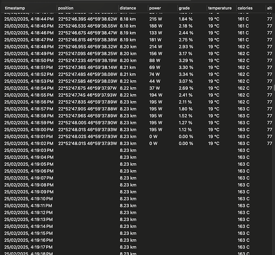

Raw File File also shows the “Gap” where the unit continues to record in the background

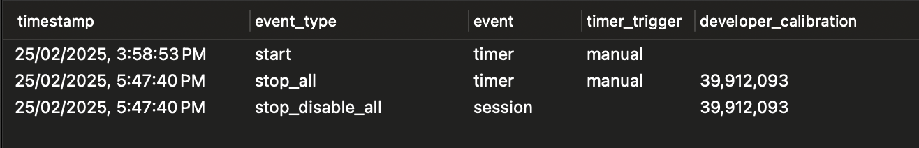

Event Info does not show any auto pauses
i don’t quite know how auto-pause functions and whether it still records any data in the background (eg: no HR but timestamp continues like the above)

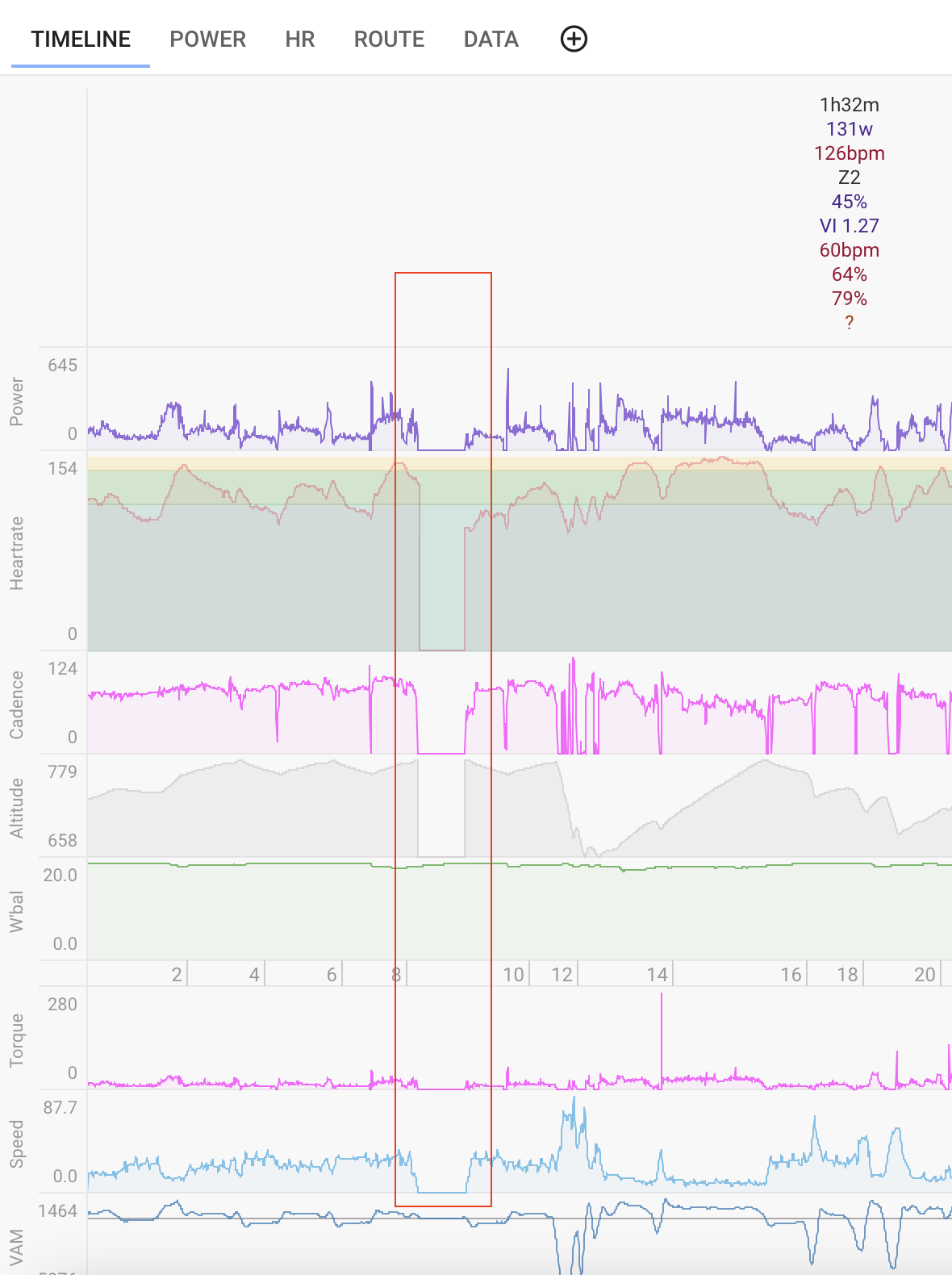

Garmin connects the elevation points from the pause start to end. Intervals just shows the empty stream as 0.
During auto-pause or manual pause, most devices simply stop recording.

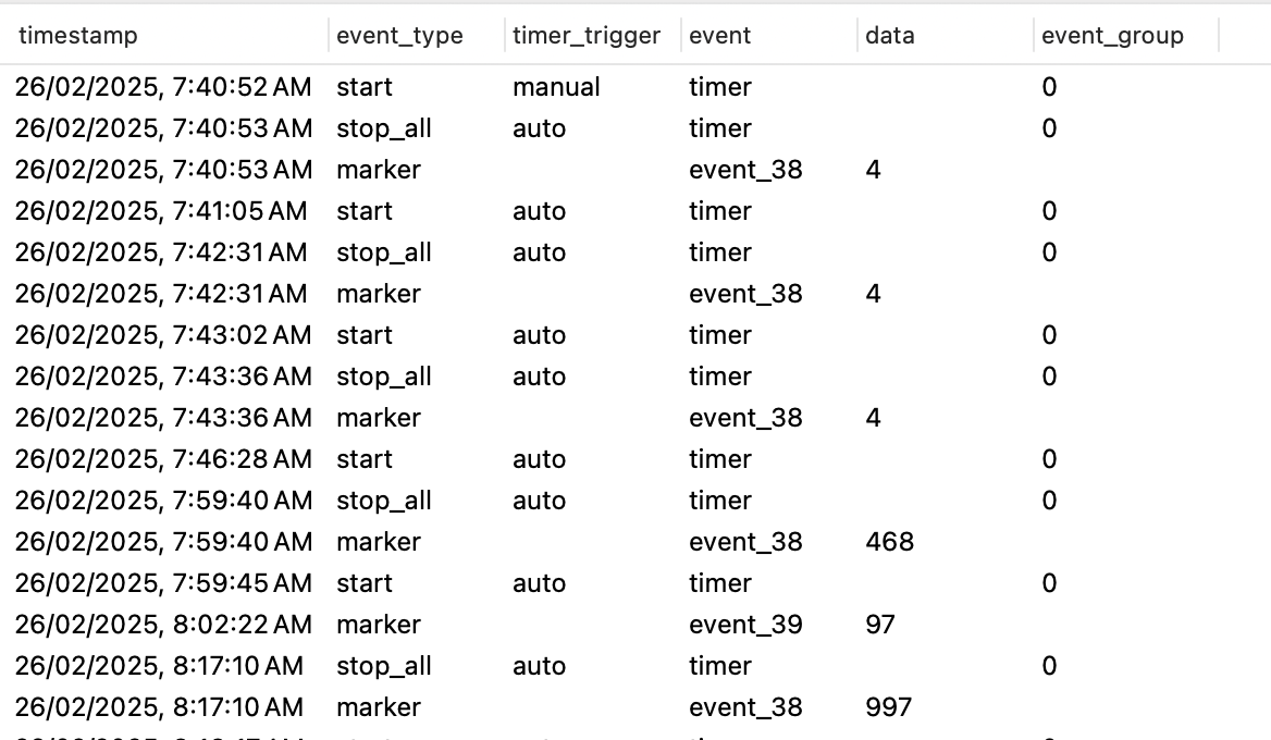

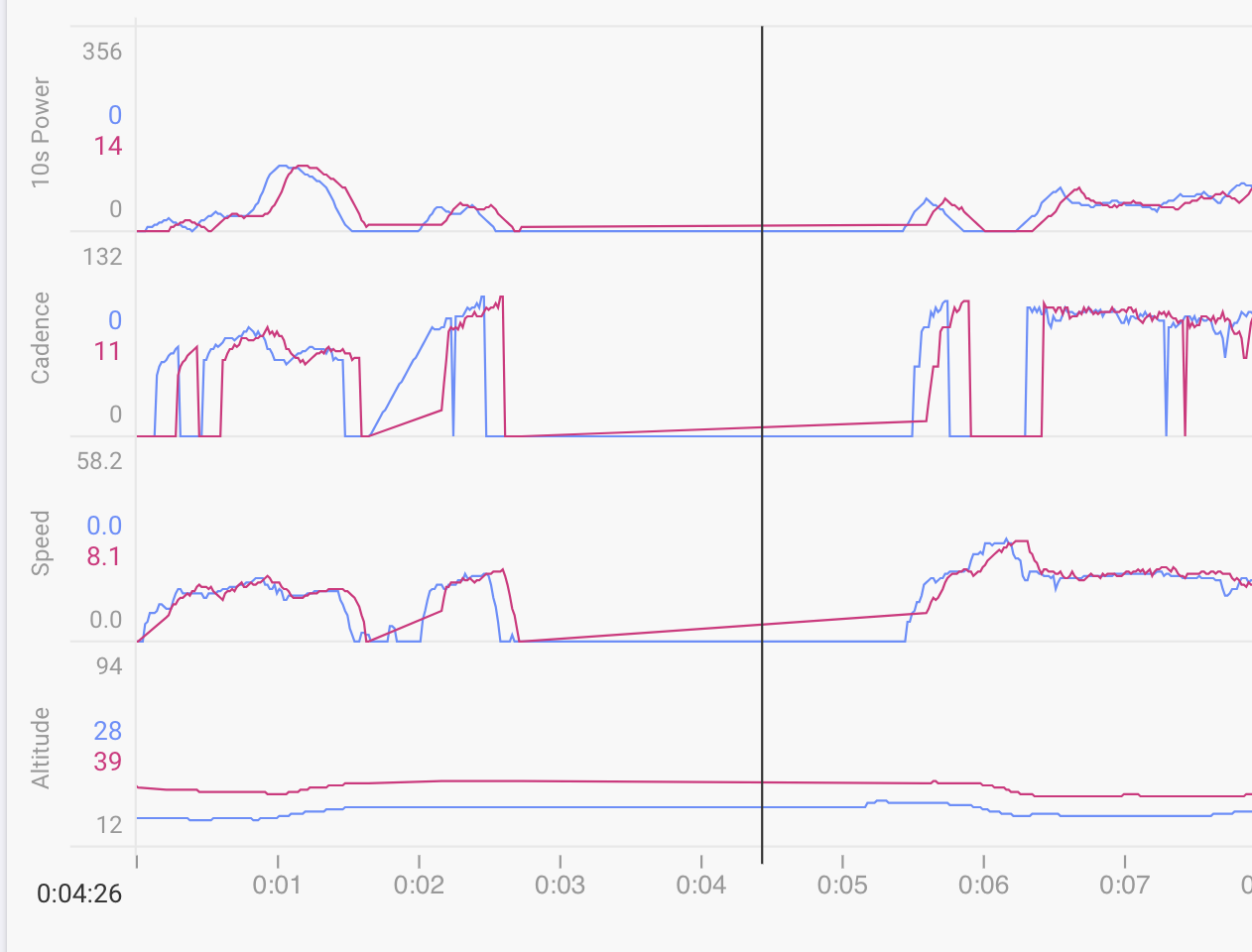

This is ride recorded on 2 Garmin. RED is with AutoPause turned on. The data stream

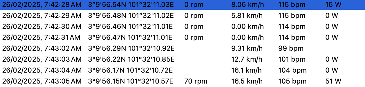

Auto Pause happened at 7:42:31 to 7:43:02. Nothing is recorded during that time into the FIT File. (no HR. No Power. No Speed. etc…)
Auto Pause also can be seen in the Event Info.
But I need to re-iterate. This is on a Garmin, not a wahoo unit so how they implement auto

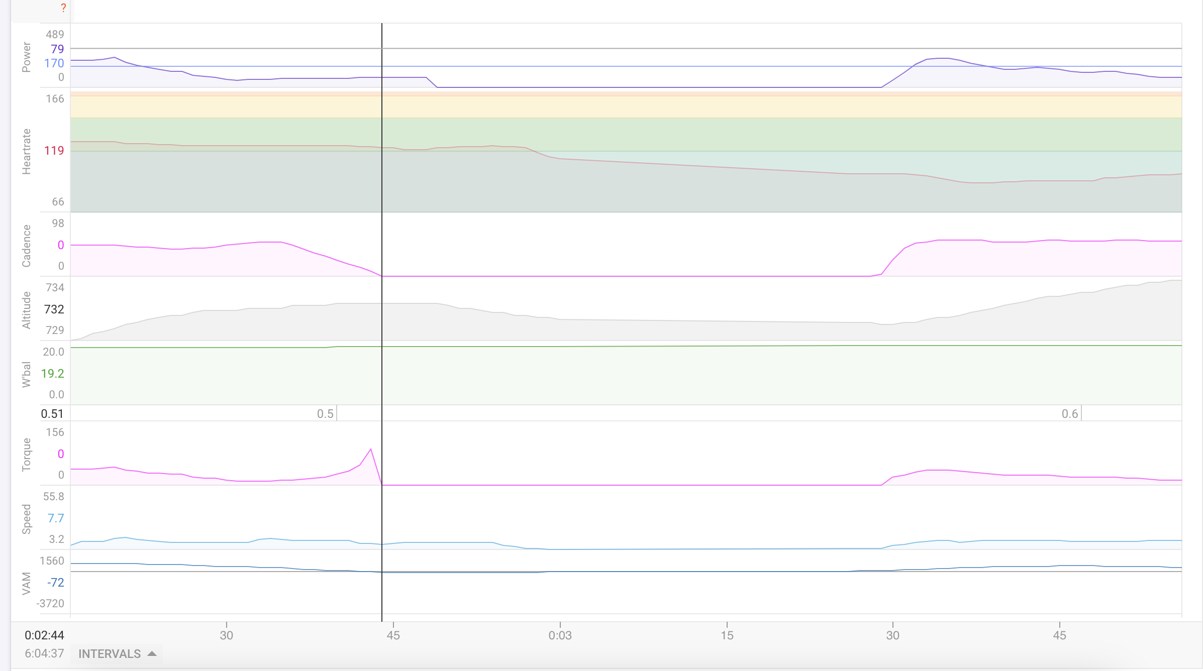

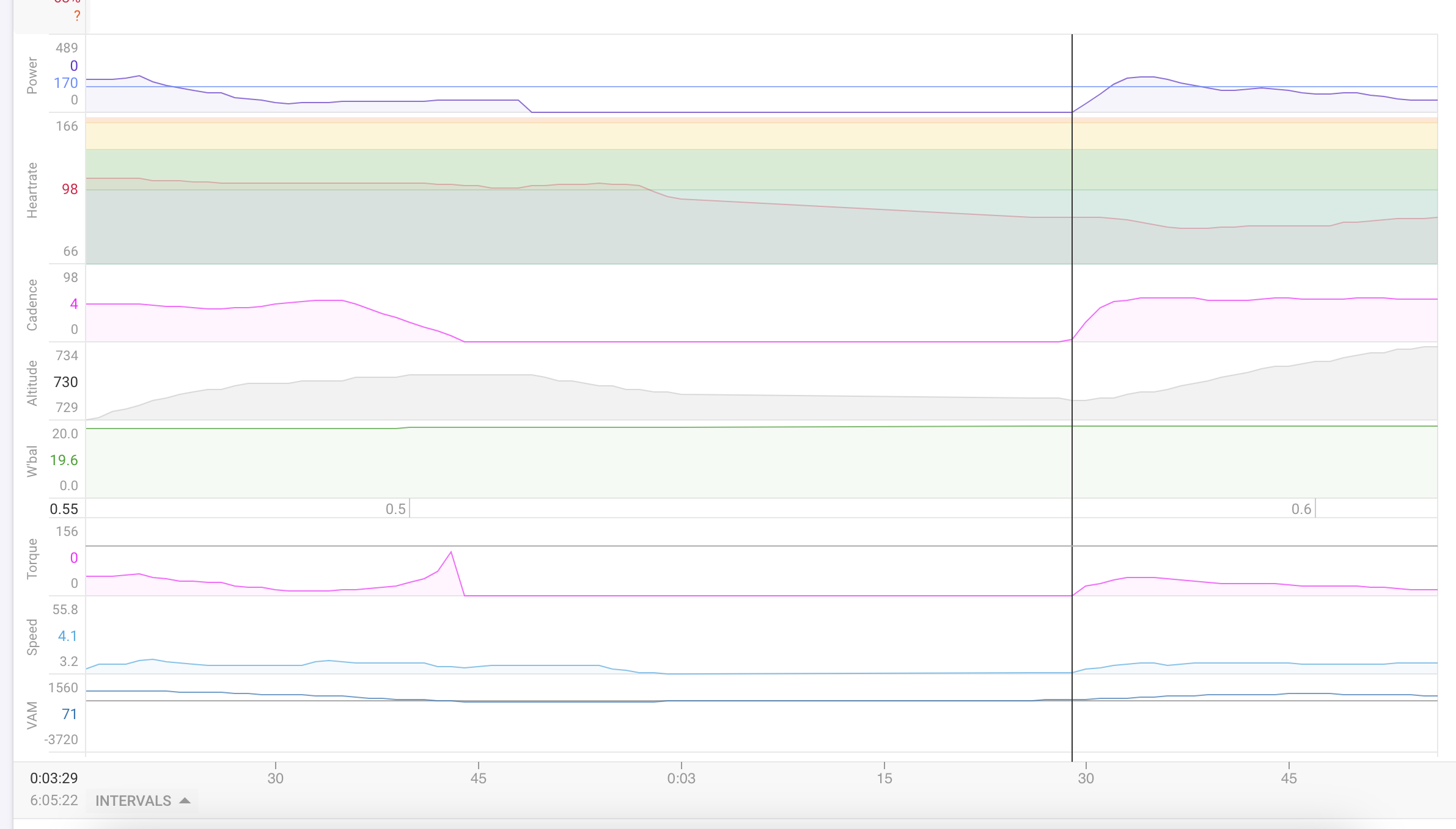

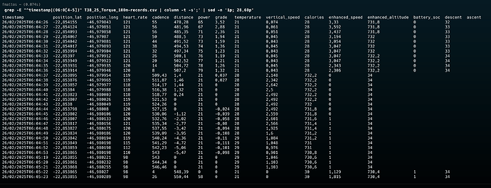

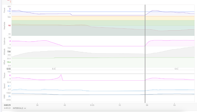

I was just analyzing my today’s activity .fit. It has an auto-pause for sure at 02m44s/06:04:27AM till 03m29s/06:05:22AM when I was passing thru home’s gate. It keeps recording everything this time and I see no data gaps on Intervals for this ride; as I said on first post, this is happening very randomly.
The only field that I see missing on this data snapshot is battery_soc, but it also shows missing on other parts of the file, don’t think it has anything with it.
