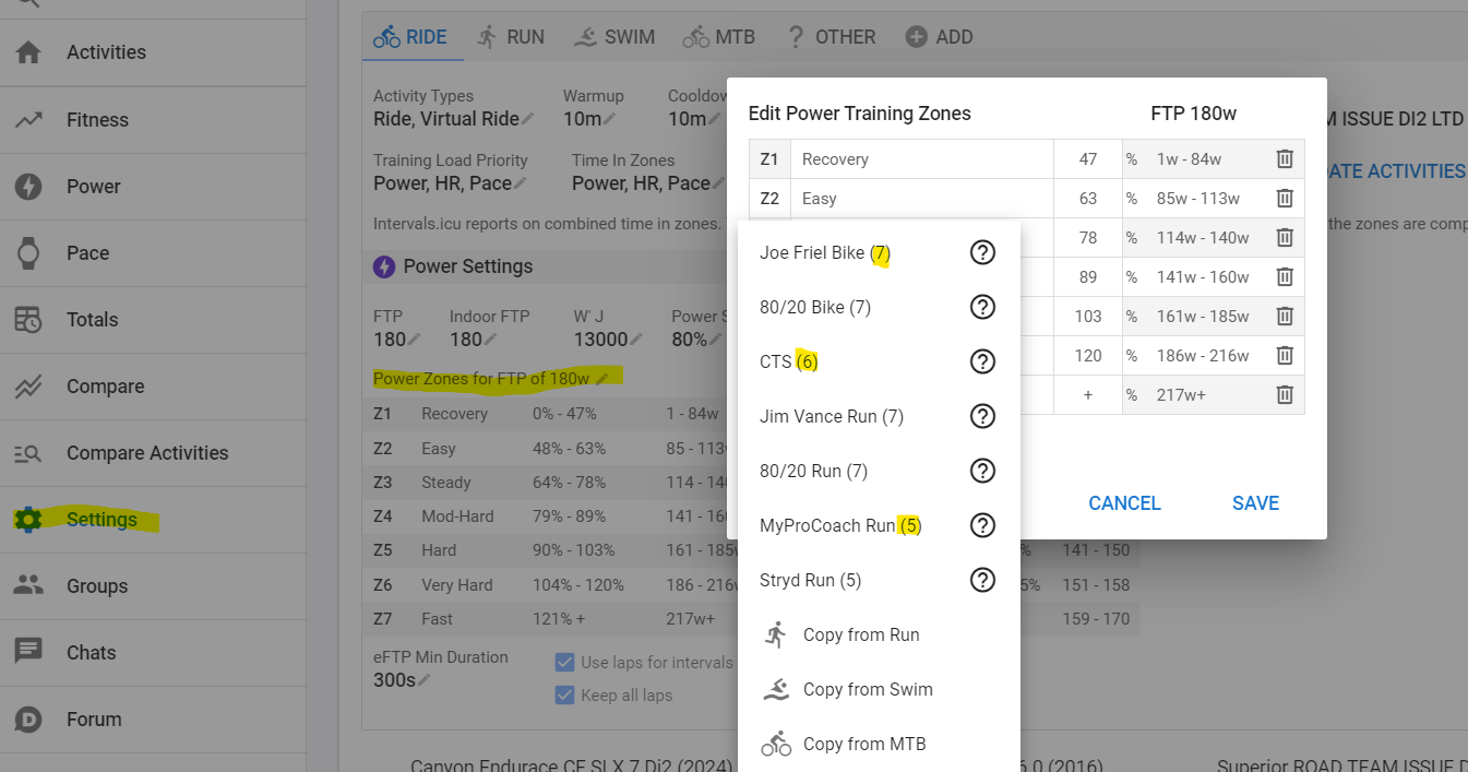

Having recently read The Midlife Cyclist…I too would like to see an option for 3 or 5 power zones over the standard 7. Thank you!
You can already make 5, 6 or 7 zones for Power, Pace and HR.
Less then 5 or more then 7 is not possible yet.
Hmm…why can’t i figure out how to do that?
Open the presets for each metric
Perfect thank u!
