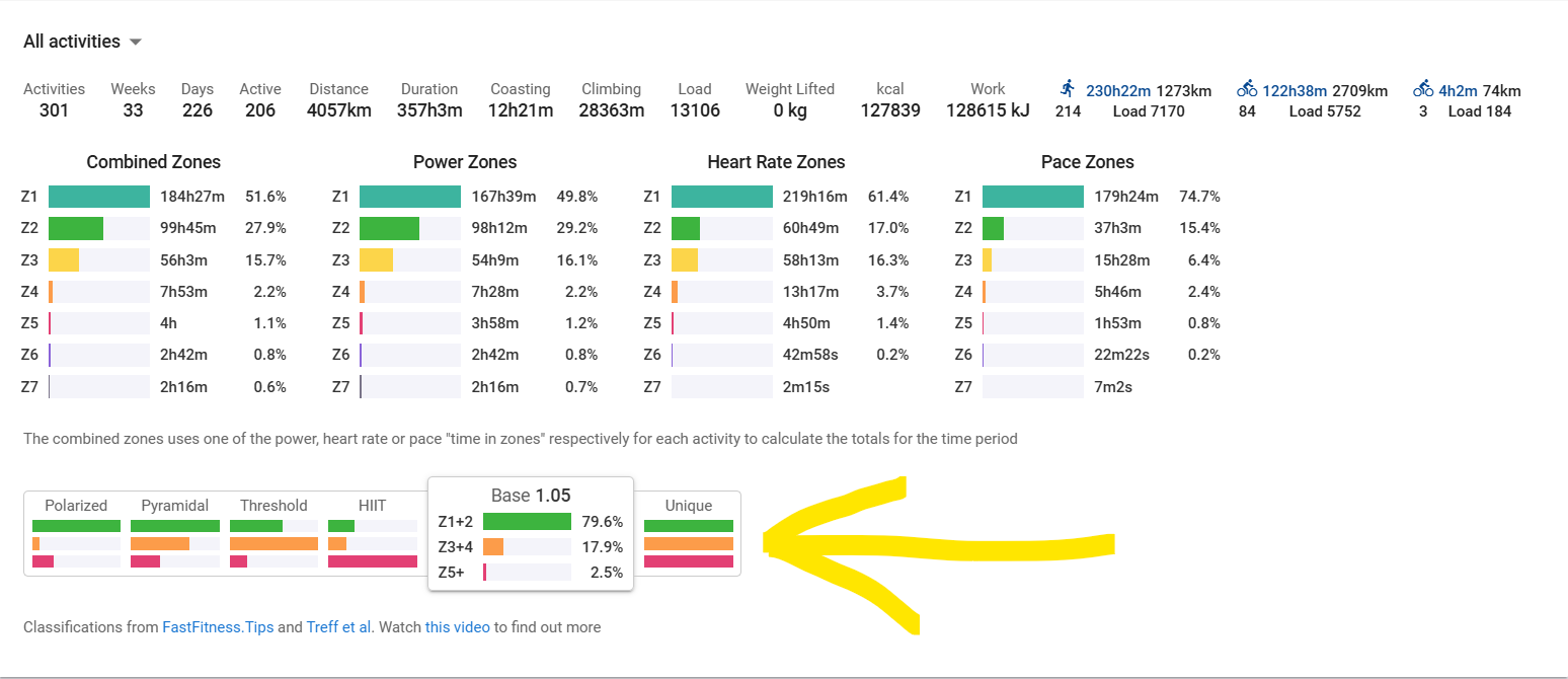

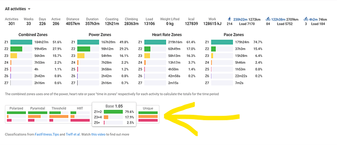

This

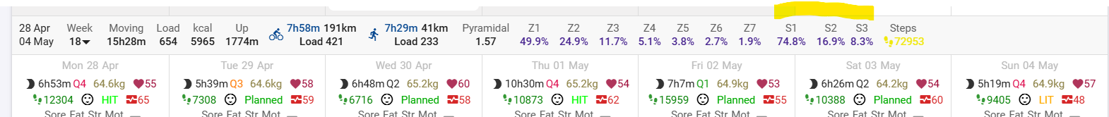

and this
is based on the grouping I just told you. And it can’t be altered.
There are a number of problems arising from the fact that the zones in Intervals are based on the 5 zone HR system and the 7 zone Power system. David knows that and will change it at some point. But for now it is what it is and it’s difficult to change because it is so deeply ingrained.
At this moment there’s no ā€˜proper’ way of using the Seiler system in intervals because it uses top of Z2 power as AeT power and top of Z4 power as the borders. Depending on the athlete, we know that the correct point for AeT can be lower or higher then top of Z2 power. And for AT, we know that power at top of Z4 is too high because that is 105% FTP.
So we have to work with what we have and the mentioned grouping is the best approximation at this time.

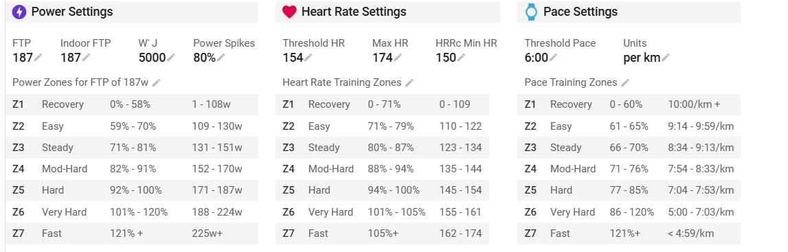

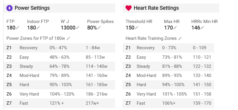

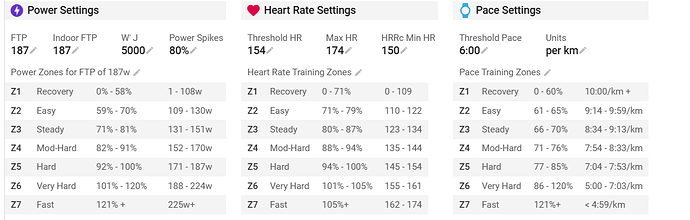

You can kind of manipulate the zones to suit your preferred system, but there’s always something that doesn’t match. Hence the different grouping that is now already implemented. My way of getting as close as possible is to use AeT power as top of Z2 power and top of Z2 HR. For AT I use top of Z5 power and top of Z5 HR. This all in an ā€˜adapted’ 7 zone system for both Power and HR. For cycling I have this:
And for running:
This gives me Loads for all three parameters that are acceptably close and I do modify HR and Pace zones with Power as a ā€˜master’ when I see Loads from HR and/or Pace that start to diverge too much.
It’s not ideal because it skews the Totals in my first screenshot and the Seiler zones in the calendar view. But I’m aware of that and handle accordingly.

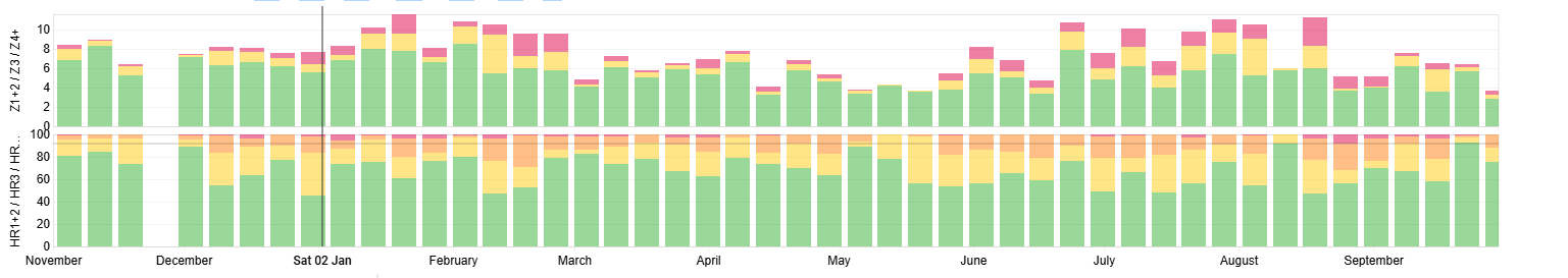

I am playing around with block periodisation broken down into Low Intensity, Mid and High, and thus was looking to map my time in zone for HR and PW into these categories.
As above, the option is there for power, but for HR, I had to add an additional zone plot, but, I suppose I could change the colour for Z4 and Z5 to red from a visual point of view.
