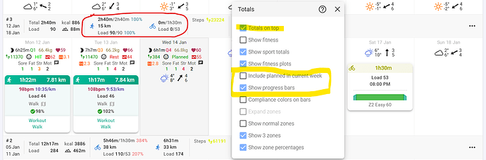

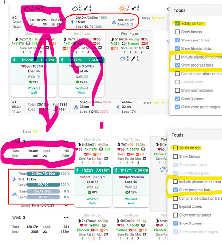

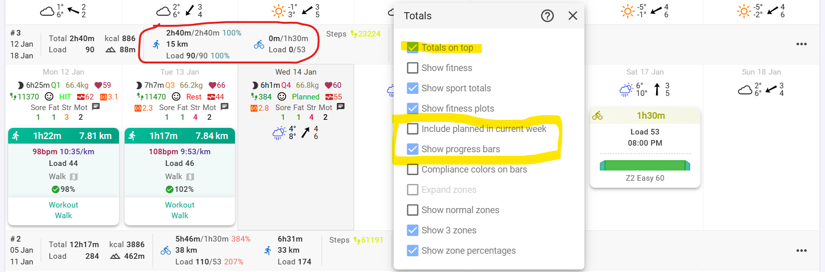

I have searched on the Forum but didn´t find the answer (sorry if I miss or repeat something). It is possible to see in Calendar view the Training Load and Time in Zones completed so far in actual week for the Totals?
I see the following on my Calendar:
As you can see, there are 2 “Load” numbers in Totals, both show 372 which is the mix or sum of Completed and Planned TSS for this week. Detailed info shows the same:
Same happens for Time in Zones, is a mix of workouts made plus planned (future) workouts.
I am not sure this would be a bug, but if not, I don´t understand why I see the same load number twice?
  1. May I see in Calendar my current training load (completed) and Time in Zones so far in the week without include my planned workouts?

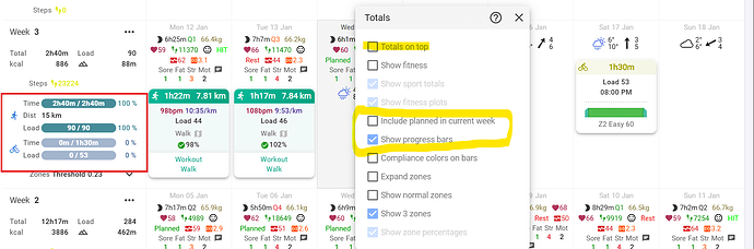

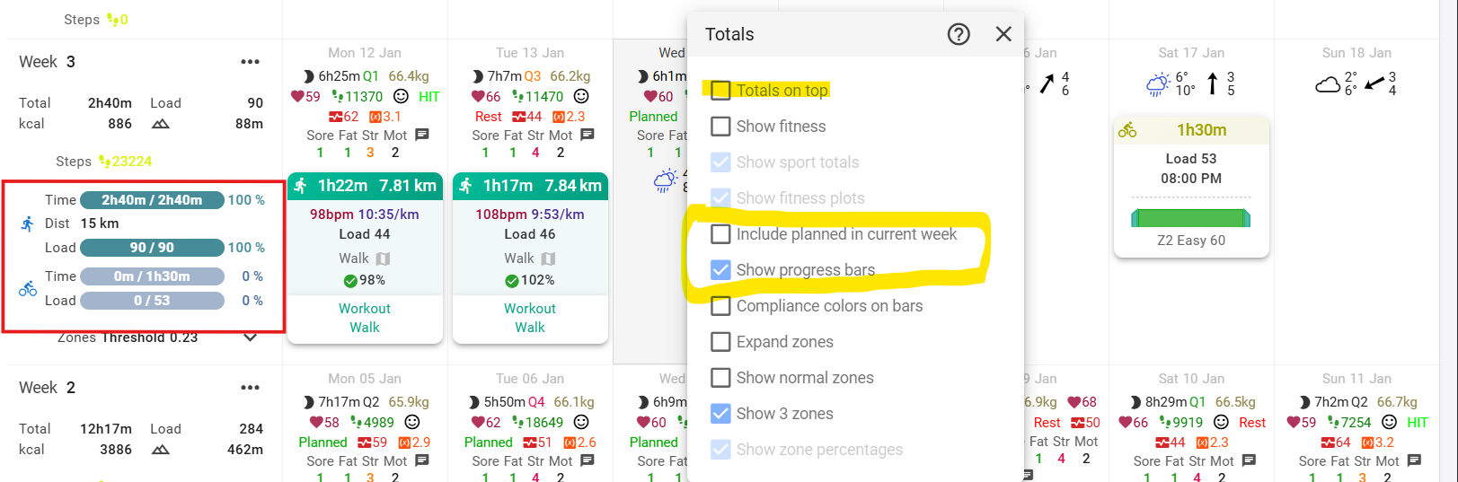

With Totals on left menu I can see those real completed numbers for load and time in zones, load 238 and real time in zones made so far:
  1. May I see my planned training load and time in zones for the week without mix it with completed workouts?
  2. The idea is to see Planned vs Completed at the same time without mix them…

Tx. I have revamping this part of Intervals.icu on the todo list specifically showing progress vs the plan for the week separately which is what you are asking for.
There are 2 load numbers for the week because the first one is the total for all sports and the 2nd only cycling in your case. Makes more sense for triathletes :slight_smile:

So you want to be able to see only what you have actually done so far excluding planned workouts? I could add a checkbox to the week popup for that?
Yes David, a checkbox as an option (some like “show load and time done so far”) to see the load and time done in the current week so far without include planned future workouts for that same week. At the end of week both numbers should be the same…
I schedule my training sessions with a target Load per week, and if for some reason I could not do an entire workout as was planned, I can easily modify if needed some future workouts (specially at weekends) to try get close to that target load. (most useful when doing Base periods)

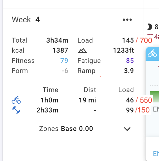

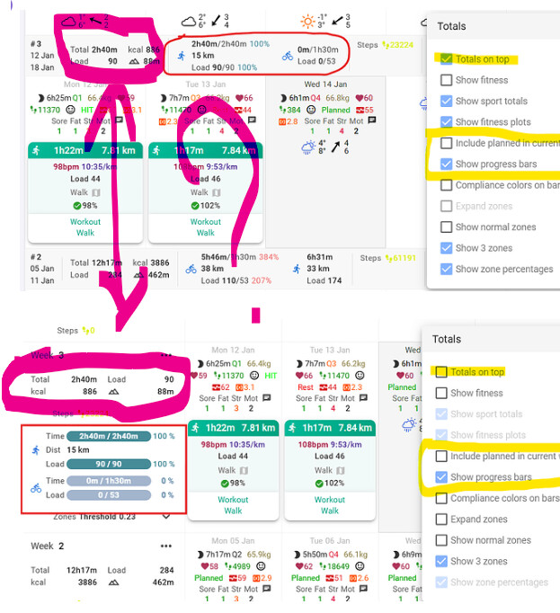

Anyone find a way to set this up. I too would like to see total load so far for the week (all activity types added together). Ideally it would be great to see it in the “Load” part on the calendar page. For example, on Thursday of the week someone might be at 470 / 700 of their week. 470 is what they’ve done so far of their 700 total load plan.
Thanks for the reply, but that only shows total per sport. I’m looking for the cumulative total of all sports added together.
Thanks for the continued replies. But I think what I’m looking for isn’t available. I was hoping that there was a way to show total load completed so far and total load planned all at once (for all sports types planned that week). There’s only the option to show either.
Something like this
Perfect world… it would show what you have done, what was planned, and what will be completed if you continue as planned. So say I have done 150 so far (25 of that is over what was planned), I planned 700, and if I continue with my current schedule I’ll end up at 725. So something like 150 / 700 / 725 would be displayed for the totals, and then the same for each sport. Showing where I’m over, under, etc.
