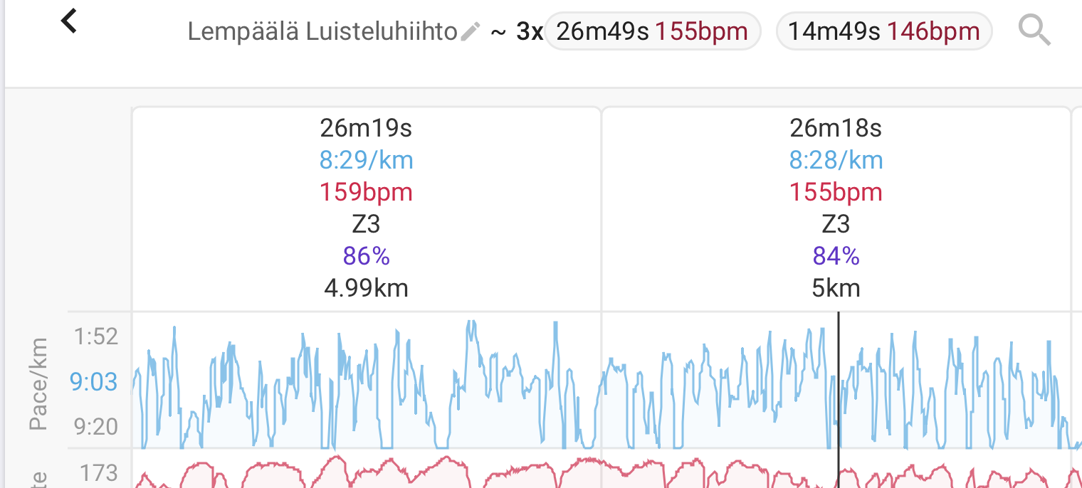

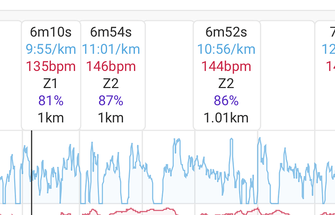

Is there an issue with cross-country skiing interval pace numbers? I have couple of examples, one originating from Garmin (5 km lap intervals) and one from Apple Watch (1 km lap intervals via Strava sync):
In Garmin activity pace is displayed as ~8:30/km but it should be a bit over 5:00/km (26 mins for 5 km interval). In AW data pace is shown as 10-11 /km where it should be a bit under 7:00/km. Is this a bug or is there something I’ve overlooked?
Also, Garmin activity is read in as backcountry ski and AW activity is Nordic ski.

I don’t follow. I verified the Garmin data and the first interval is 5k with elapsed time 26:19 (actual, wall clock time) so that would include pauses (and there weren’t any). If there would be excluded pauses, the pace should be faster, right?

I looked at the numbers and something came to my mind: incorrect units or unit conversions, almost as if there’s miles instead of kms somewhere…
So, for the whole ski trip intervals.icu gave a pace of 8:41/km. Actual numbers are elapsed time 1:35:15, distance 17.64 km → in decimals this is 5.3997 min/km.
When I convert 8:41 to decimals and divide by 1.609 I get 5.397 so we are pretty close. Could it be?
That is so close that it can’t be a coincidence.

Garmin-originating activity (which is more representative): Intervals.icu
Apple Watch activity: Intervals.icu
Fixed! Tx for that. It was broken for people who hadn’t set a threshold pace for the sport in /settings. Thats why it had been hidden for so long.
