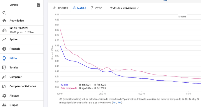

back in GC I kept track of my swimming progress with CSS. Unfortunatly I cant see it in intervals. My tempo curve is showing, also the checkbox for CS is checked. Any clue what I am doing wrong here?
Hi, iâm also interested in the topic.
If you look below the graph at rhythm/swim, it says âCS (critical speed) and Dâ are calculated using the 2-parameter model. Intervals.icu uses your best 1k, 2k, 3k, 4k and 5k times while keeping the ones that take between 2 and 15+ minutes.â
So it seems to take the same distances used to calculate running CSS (1k, 2k, 3k, 4k, 5k). Of course, this is not realistic for swimming because swim sessions usually last less than 2k (unless long distance swimmers).
It would be great to fix this issue and use the most common distances to calculate swim CSS (200m and 400m).

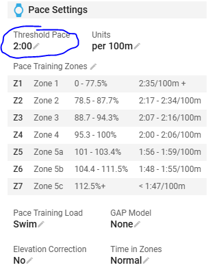

If Iâm not mistaken, .icu does that as âThreshold Paceâ , which you can update manually, here:
EDIT: I believe this auto-updates from recent swim data as you complete WOs, or at least prompts you that you might want to update it. Not 100% sure though.
Perhaps Iâm misunderstanding the question though !
We are talking about the general rhythm chart, which is accessed from the menu on the left.
In running tab, it auto-estimates the critical speed based on the times obtained in 1k, 2k, 3k, 4k, 5k. In the swimming tab, graph description indicates that uses the same distances (1k, 2k, 3k, 4k, 5k), which is not realistic for swimming activities witch rarely arrives to 2k (at least for me).
As i donât have 2k swimming workouts (yet) then it doesnât estimate my CSS as it needs 2 valid distances (1k and 2k for example).

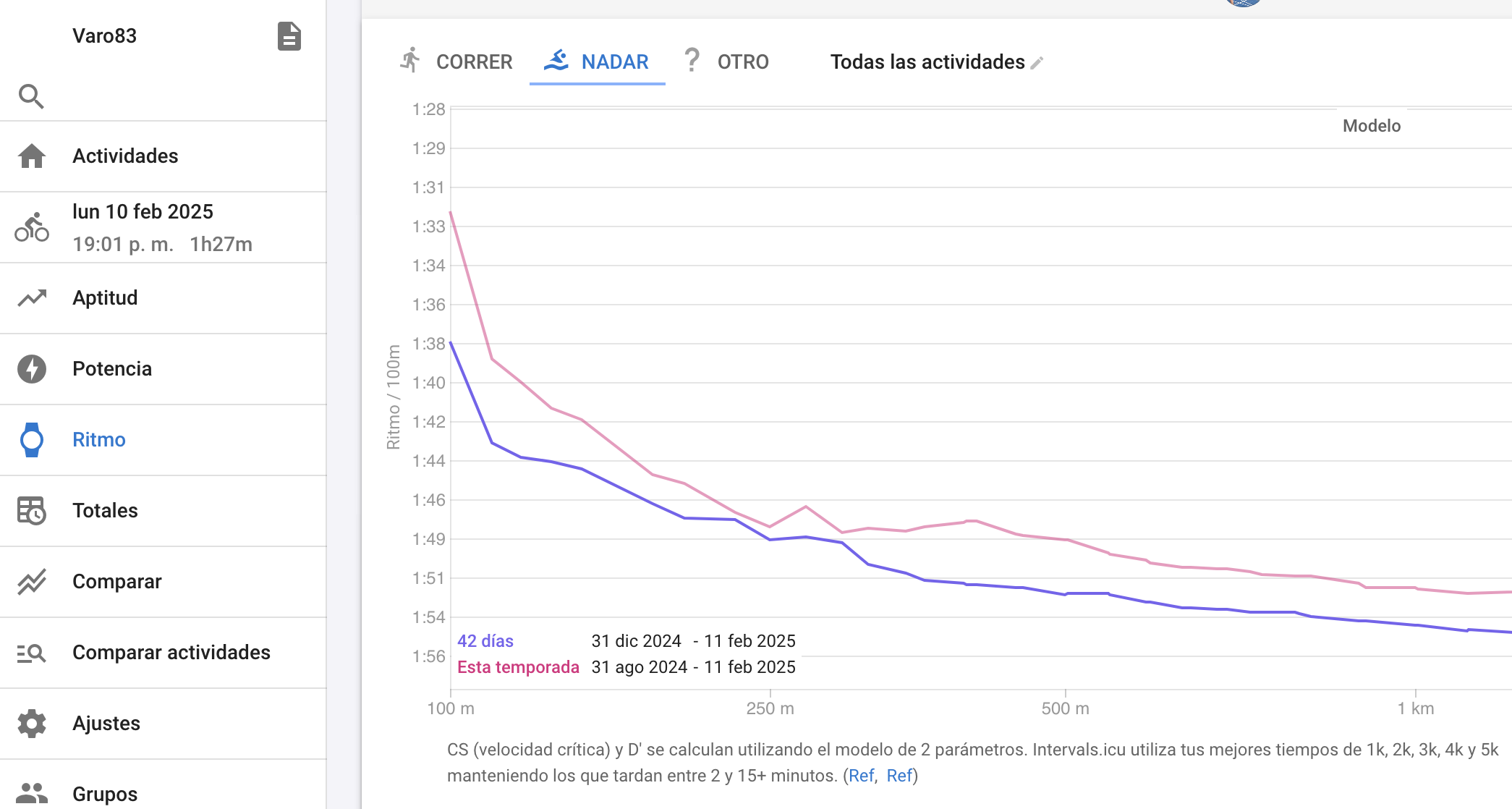

I donât see rhythm/swim. The graph that I have above the quote you give is âPace/100mâ.
I think you are looking in a workout. You have to enter from the left menu, Rythm (Ritmo in Spanish).
Nope, thatâs where I was looking. I figured it was a language interface issue. In US/Can/GB English itâs âPaceâ. ![]()
Ops, youâre right
And below pace graph, i guess you donât see CSS, right? Unless you are a true swimmer (not like me
