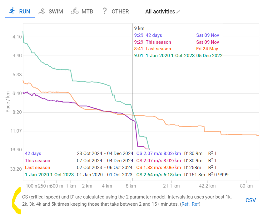

It does based on activities within a date range. It’s on the Pace page:
Yes MedtechCD, but it’s a bit different to estimate with best performance on 1K, 2k, 3k, 4k and 5k that is realize within an other workout, than 3 predefined time workouts and select that particular workout to calculate critical speed.

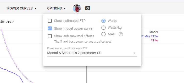

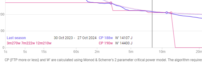

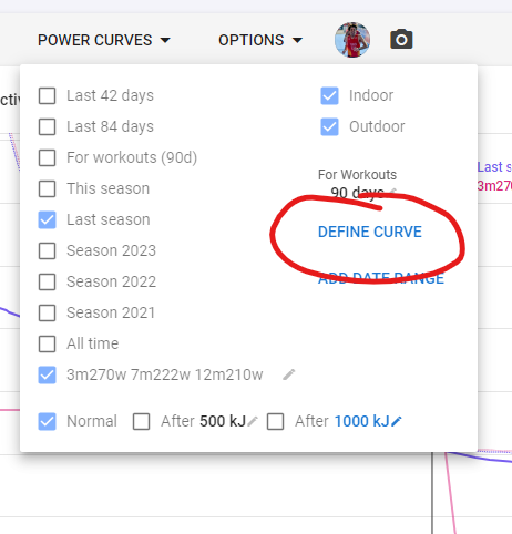

you can add a power curve using individual 3/7/12 min trials (or any other combination) by going to the power or pace tab and define your desired curve:
don’t forget to choose the model for the estimates under “options”:
you will end up with the estimates based on the model used and the P/t combination:

Yes I see this for CP curve, but it doesn’t exist for CS, despite modelling is similar.
oh yes I see, this isn’t available under “pace curves”
anyway, based on the accuracy of the models the data points are taken from your runs. And if you perform tests regularly these data points are used to estimate CS/D’.
Its not necessarily required to define your own curve because your test-runs are used anyway.
