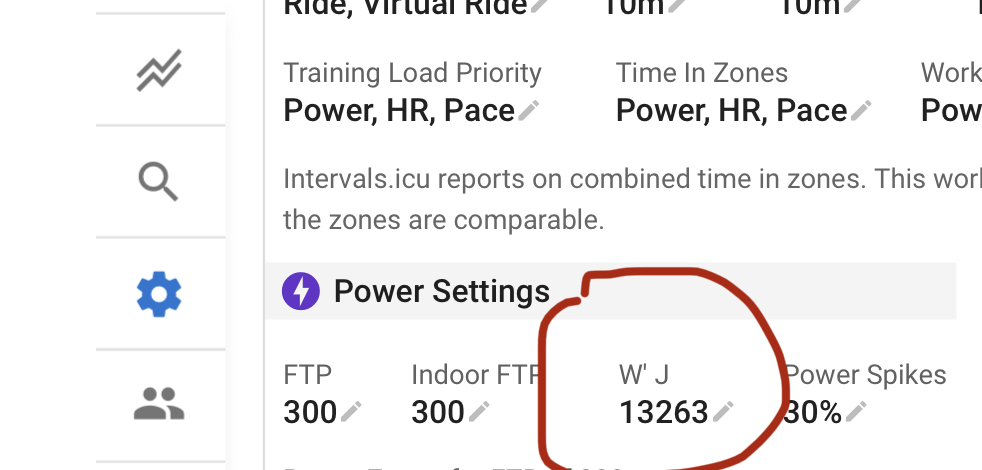

I know my CP via testing but how can I plot W’ ?

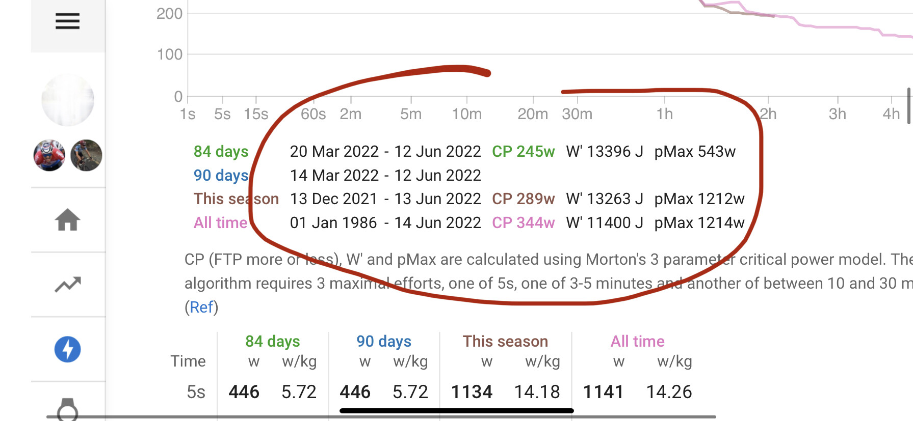

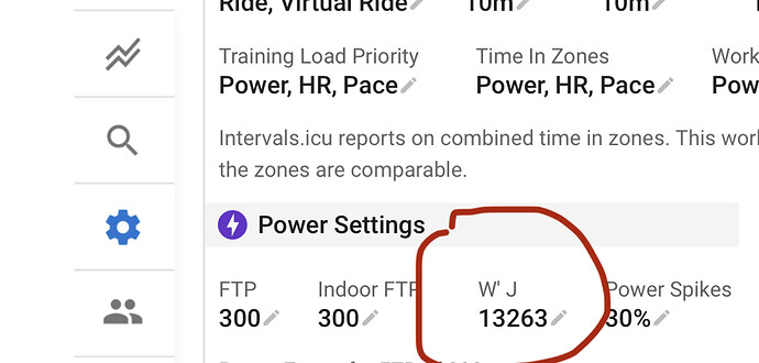

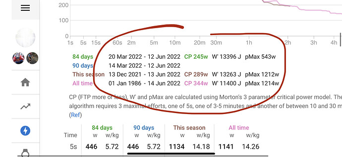

On the Power page, you can see you CP, W’ and pMax values. Copy the W’ value to the Settings page.
How do you see the pMax?
It’s the highest power you can do, and is probably measured as your 1s best.
I don’t see the pmax as you do in the power curve.
The 1s power is used for pmax. So you just have to move the marker to 1s.

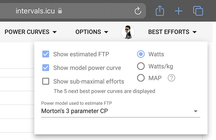

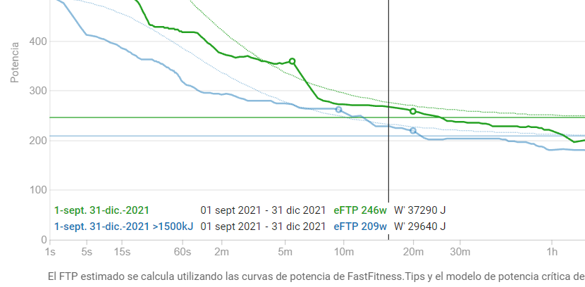

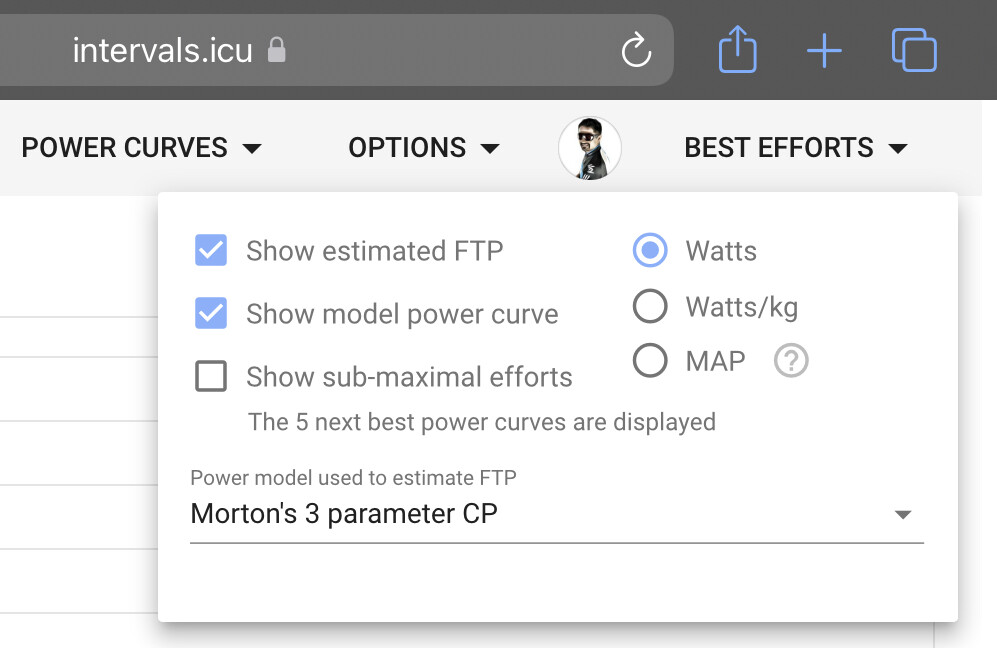

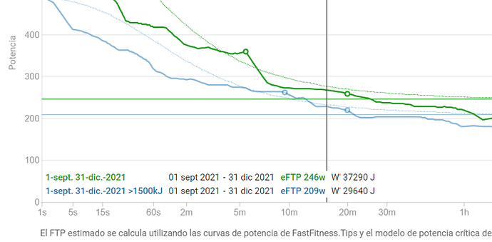

Check on the Pawer tab, options then select Morton’s 3 parameter CP.
I think yours could be on the Default option.
