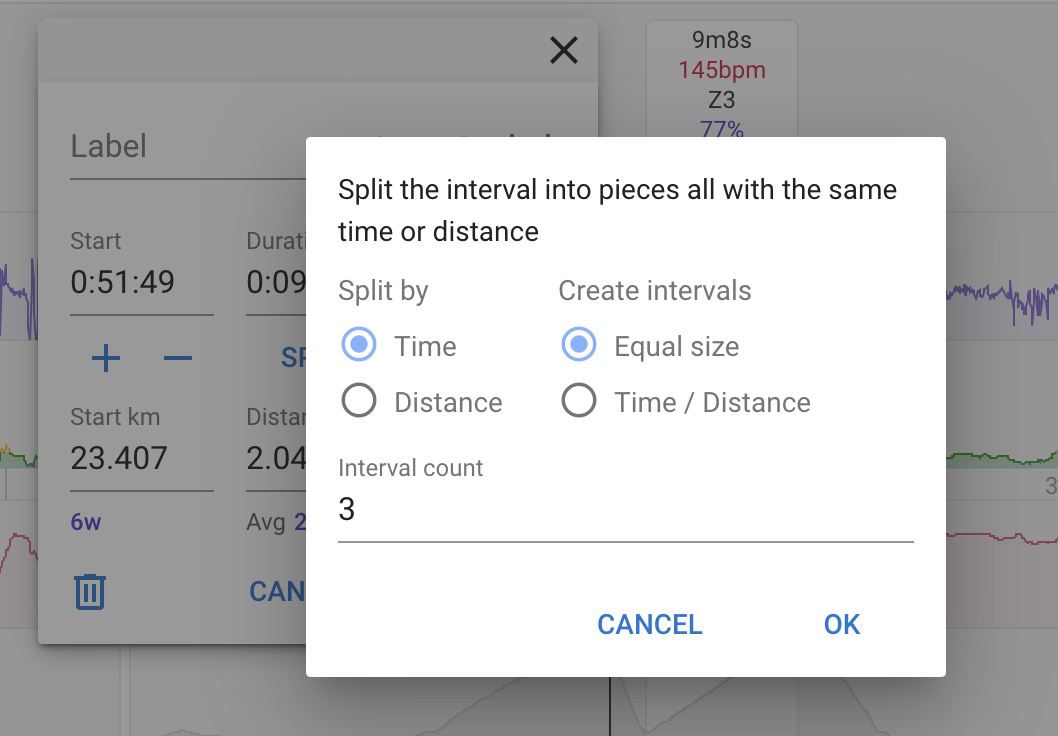

You can do that already. Click any interval to open the edit dialog and then click split:

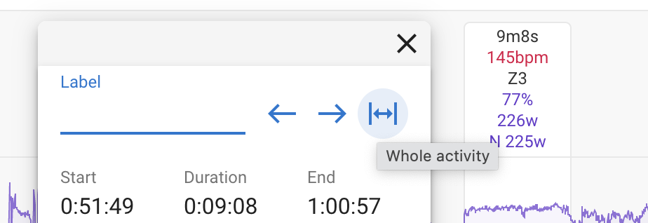

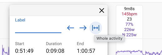

You can expand the interval to the whole activity first if thats what you want to split up:
