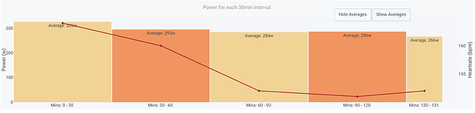

I think the custom charts is a good area for this.

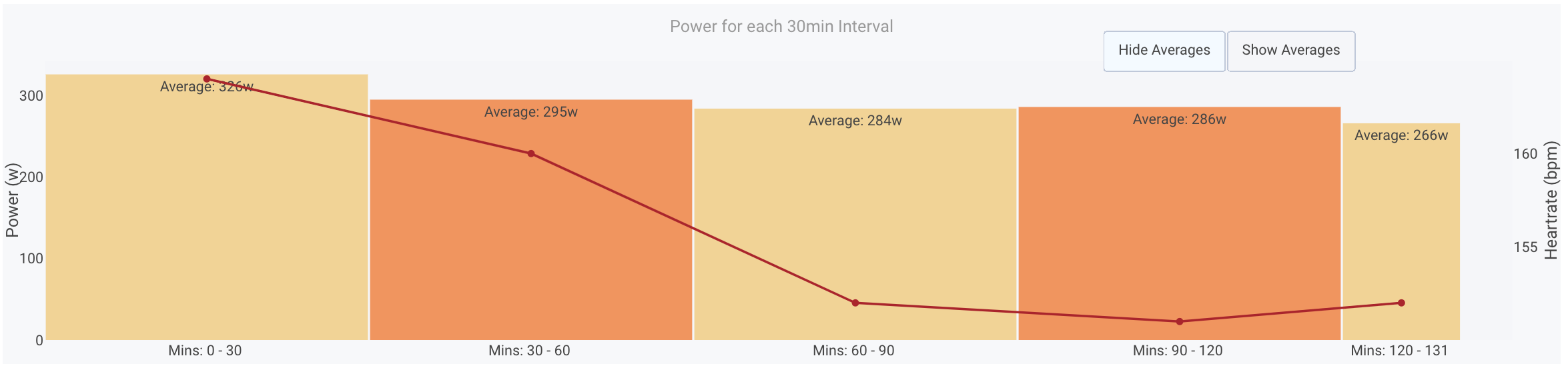

I made this one to break down my cycles into 30 mins (the variable at the top of the script can change this)
It’s currently public if you want it to use or edit - Power & HR by every 30mins

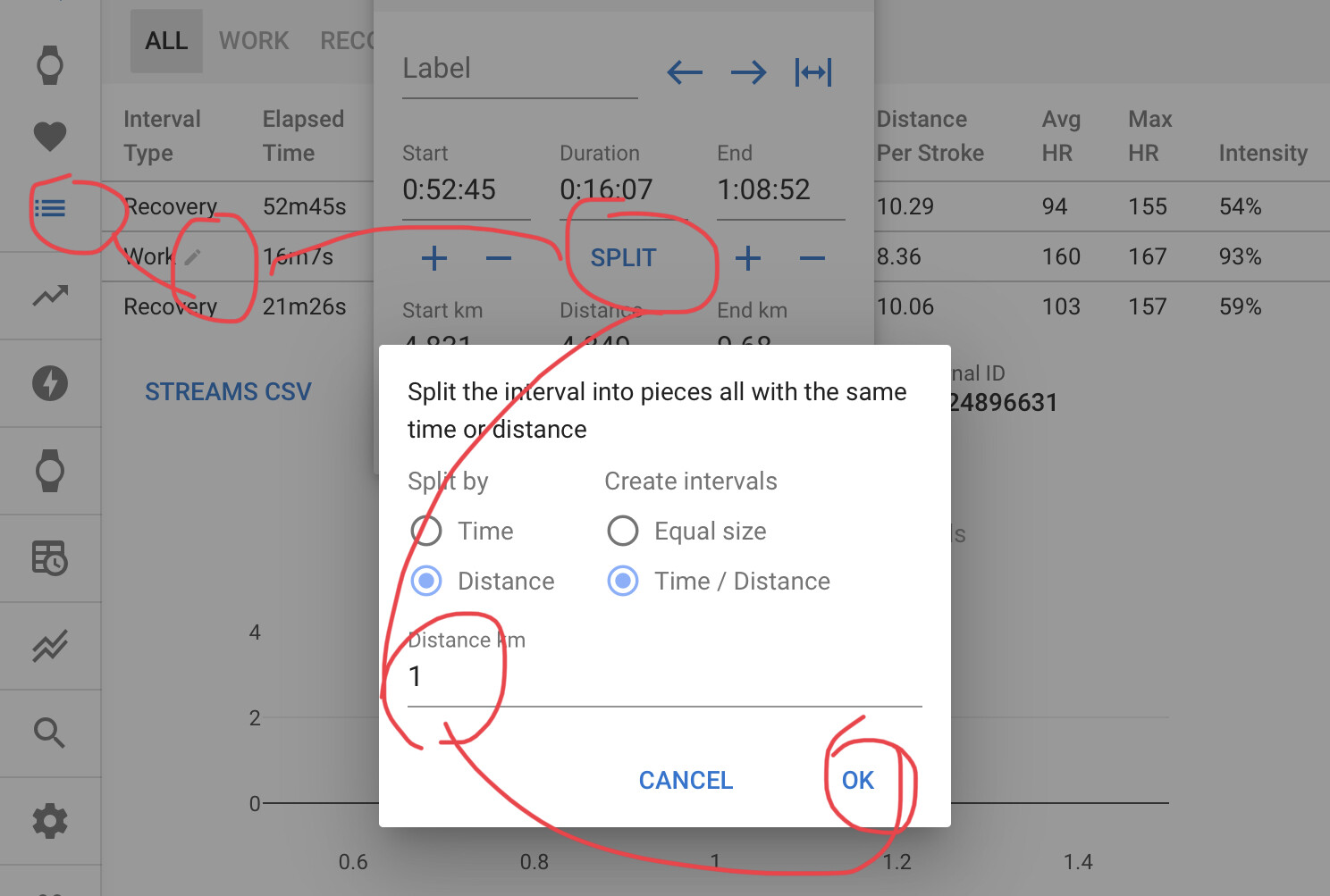

You can also use the “Split” function to split an interval into preset distances or durations.
If you want to do it for the whole activity, first you create one interval spanning the total duration of the activity and then you apply the split.
Kind of an afterwards auto-lap.
