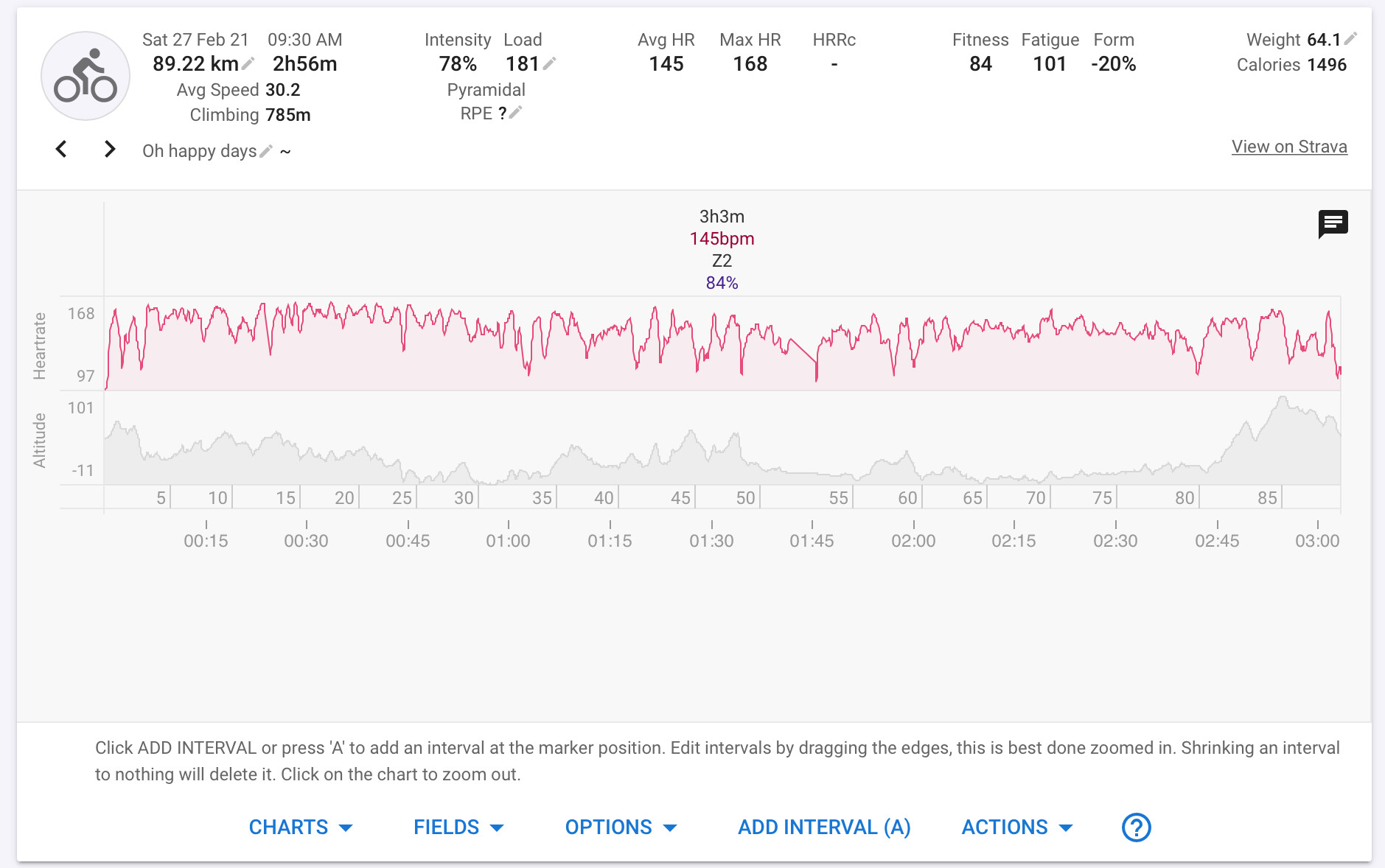

Intervals will automatically use HR data when power is not available. It will provide a TSS for your ride and will provide some ride based analytics based on HR including time in zone etc.
Here is an example of a outside ride of mine from yesterday using HR only. This ride contributes towards TSS, overall time in zone, fitness and any other parts of Intervals that uses HR metrics where possible.

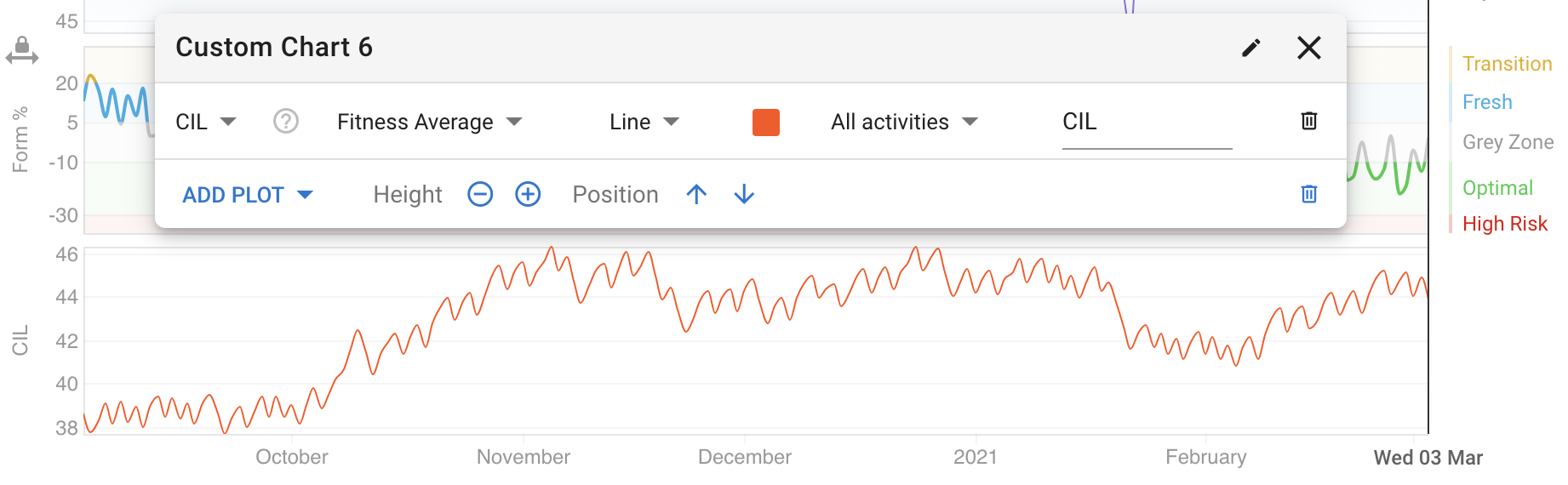

I can answer that the other way around. I had used intervals.icu for over a year just with a HR monitor and found it very useful with that alone - the fitness / fatigue / form curves work without it. I recently splurged on a power meter and of course I get a whole lot of additional data, but I would by no means say that intervals.icu is useful only if you have a power meter. There is one particular chart, the chronic intensity load (CIL), which was impacted in my case: it was rather flat before I had a power meter, but has since gone up rather significantly, while my fitness curve stayed flat. I am sure David can explain why that is, but I guess this just means that CIL is based on power more so than on HR, but I have not looked into the details.

Chronic Intensity Load (CIL) is not designed as a replacement for CTL, but simply a useful addition. Athletes and coaches should monitor duration of training carefully, but CIL gives an indicator of how the quality of training is progressing through the season.
