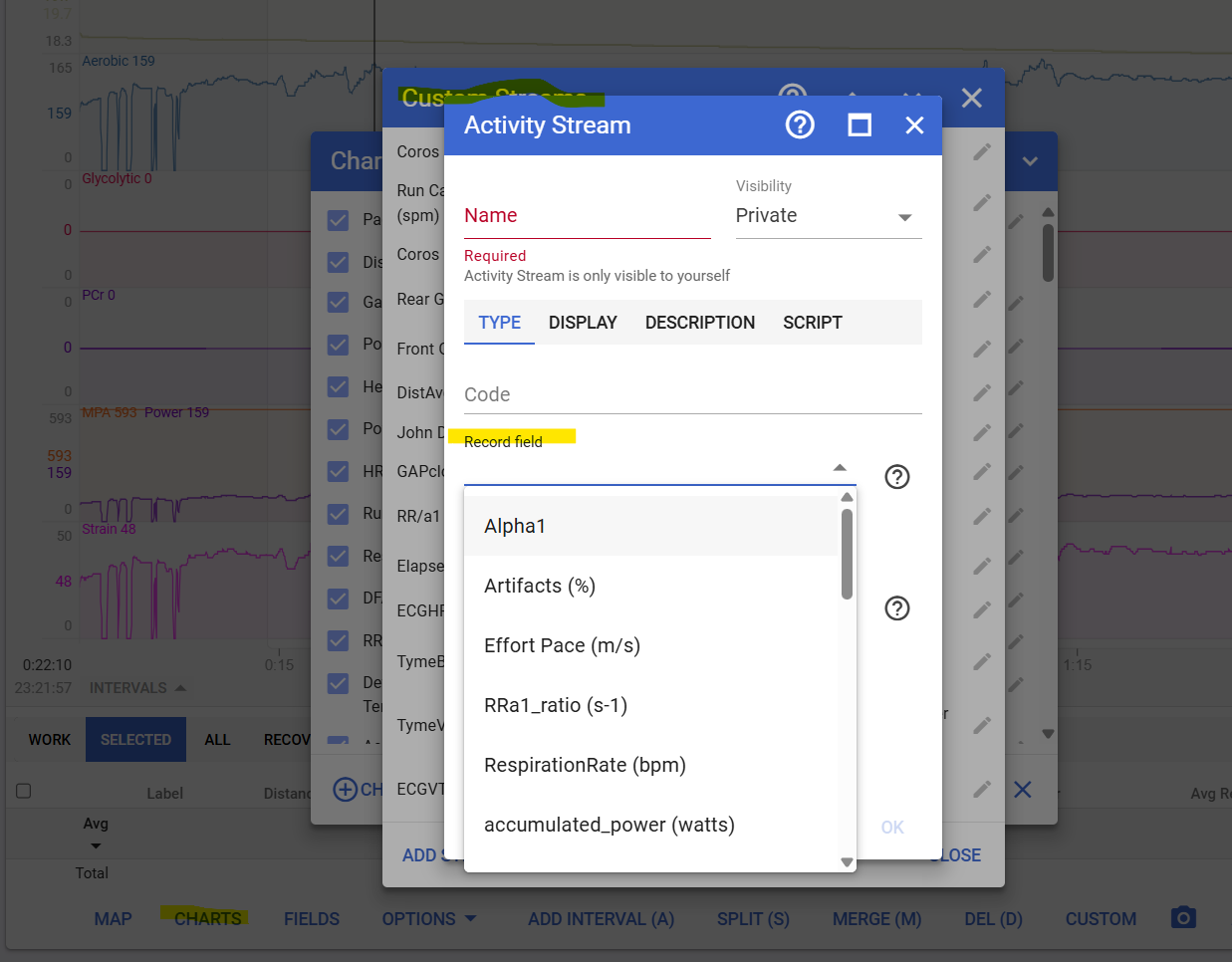

You need to add them as Custom Streams. Charts - Custom Streams - Add Stream
Then you can add Custom Activity Fields for totals and Interval Fields for Selections and Intervals.
They will all be accessible from the API after creation.
