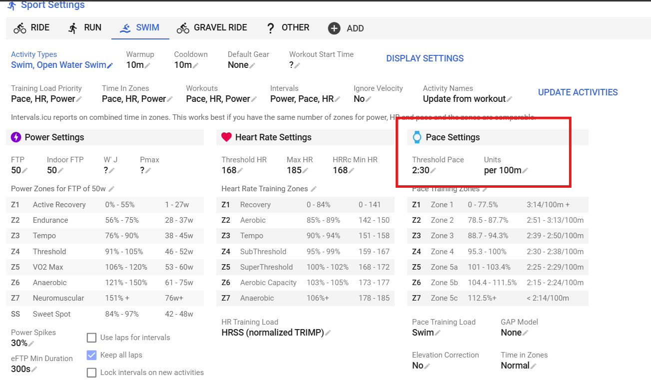

Is it possible to modify the “distance” units from km to meters? For swimming totals it would be more accurate and pertinent
Can’t tell for sure because I don’t swim but try changing this
Unfortunately I have already that setting applied: no luck.

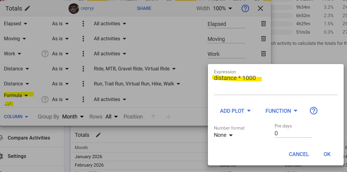

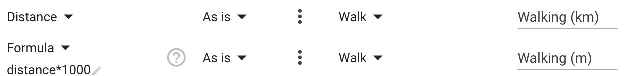

If you are just looking to display the swim distance in a Totals table, a simple way is to use a Formula function in the table and just multiple the distance in kilometres by 1000 to get the distance in meters. You will not have “m” after the total in the column but you could add “m” to the title.
Thanks! What would be the distance field name?
I have tried Distance. * 1000 but I get no results.
It’s “distance * 1000”.
No capitals and no dot at the end.
Thanks, solved!
