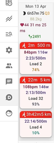

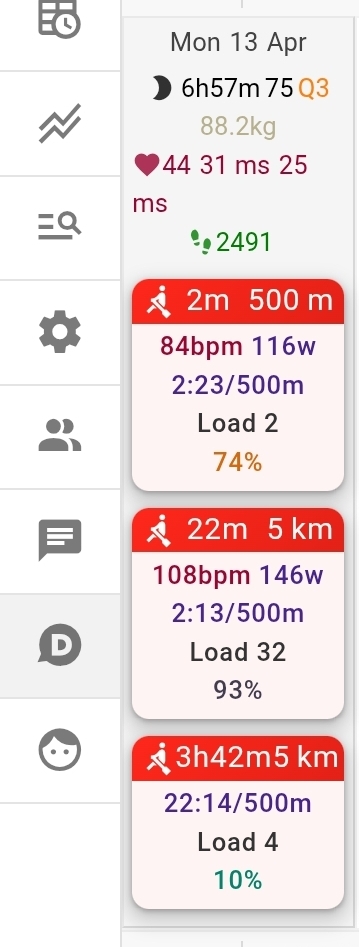

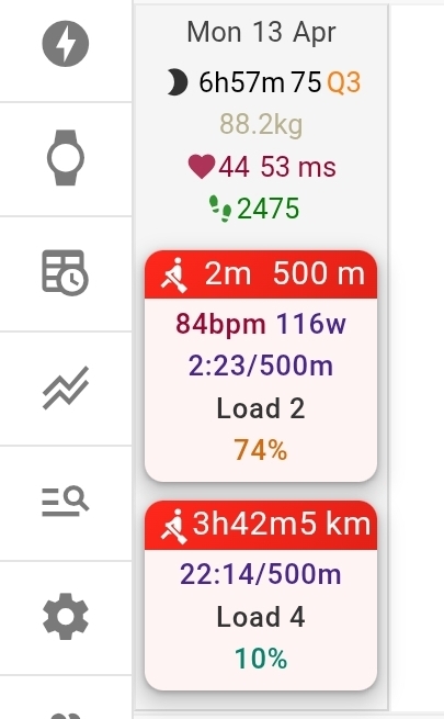

Today did 2 rows, first was just warmup looks ok. Second one is completely wrong .Both were done using Concept2 erg app and are fine on Concept2 website.
22min 13s for 5000m is what it should be.
I dowloaded fit file from concept2 and uploaded and it is ok.
hello, same problem for me too, 2h56’ of rowing…instead of 2’56’'…
