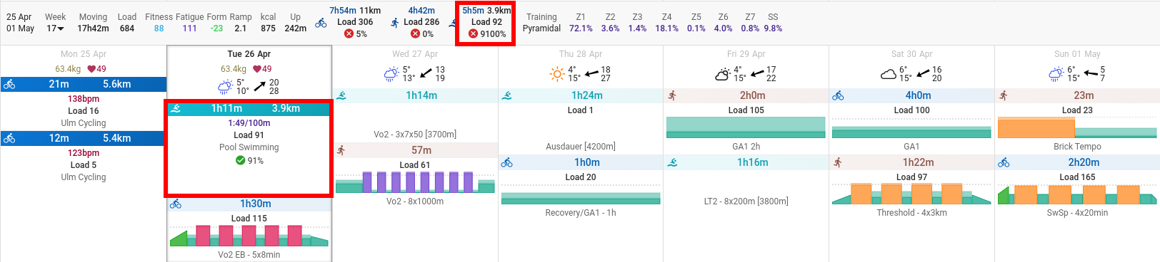

For some of my swimming workouts, the compliance to plan is completely off, both for the workout and for the week. All of the workouts are distance-based, and I do not provide an expected pace but the calculated time seems reasonable.

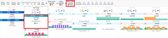

This week I have planned four workouts, of which I completed one
today (in accordance with the plan). The compliance for today’s workout is 91% which is as expected (I was slightly faster than anticipated by intervals.icu). But my compliance to plan for this week is 9100%, which is obviously way more than expected (and exactly off by a factor of 100…).

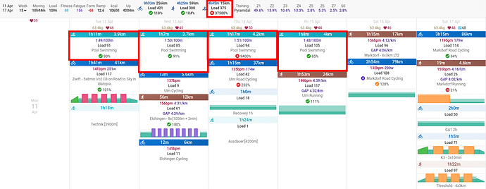

Two weeks ago I also planned four workouts, for three of the four workouts the compliance to plan was as expected. But for one of the workouts, the compliance was 9400% (which could once again be a factor of 100) even though I completed the workout as planned. The total compliance for this week was 37500% (once again suspiciously close to a factor of 100).
So it seems that under some circumstances the compliance to the plan is wrong, probably by a factor of 100.

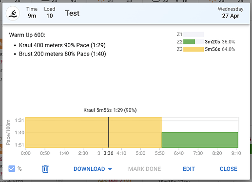

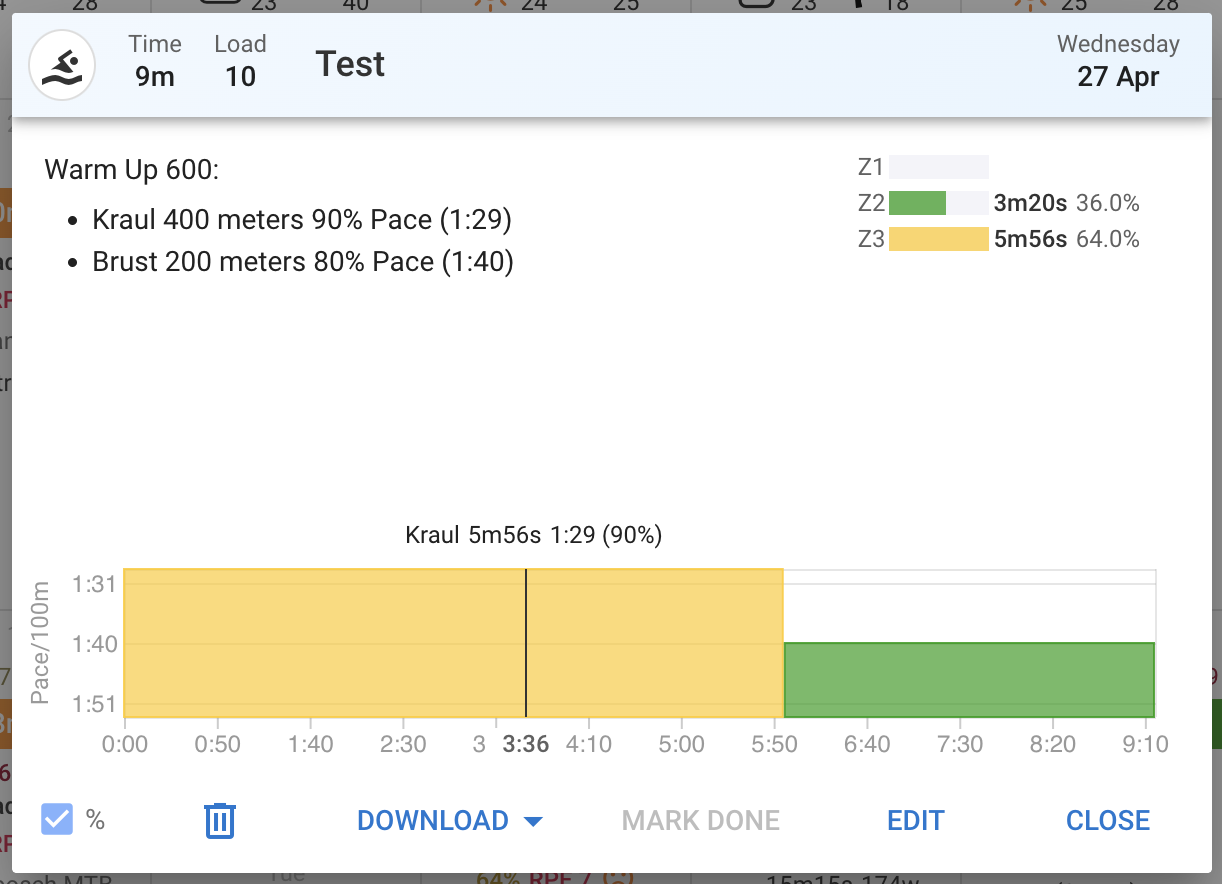

The issue is that your swim workouts don’t have any load calculated for them. You need to format them a little differently and include the pace for each step.
You have:
Warm Up 600:
 - 400 meters  Kraul
 - 200 meters   Brust
You need to change that to:
Warm Up 600:
 - Kraul 400 meters 90% Pace
 - Brust 200 meters 80% Pace
I don’t know what would be reasonable % of pace for these steps! When you get it right the skyline chart will fill in based on your swim threshold pace and training zones and duration and load will be calculated for the workout:
