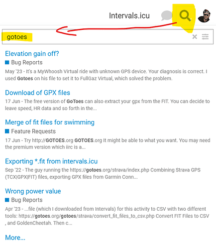

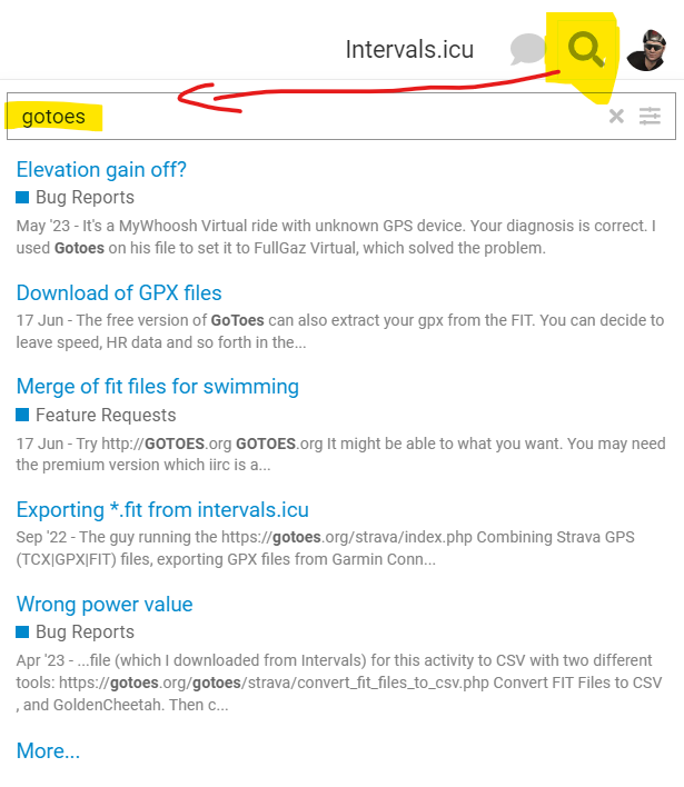

Use the search bar to find how @MedTechCD uses a website called Gotoes, to merge two fit-files together. He hasposted a few times about this, which will help you achieve what you are hoping to do.
Intervals will take Garmin Connect as preference over Strava data, but still use some of Strava’s information, eg. segments.
https://forum.intervals.icu/search?q=gotoes

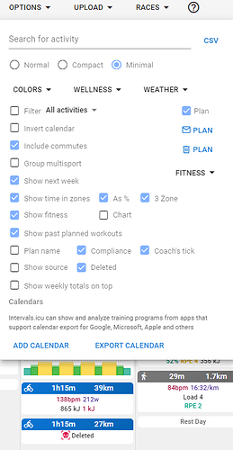

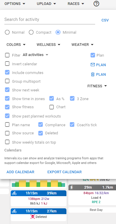

I wonder if when Intervals.icu does the merge it should check the activity type matches? i.e. above one might be a cardio activity type and just have heart rate, and the virtual ride coming from Strava is different activity type. You may want to view both information in two separate browser tabs, but due to the smarts, it only shows the Cardio activity as it is from Garmin.
You can tick the Deleted box in Options, to view the “deleted/duplicate” activity.
