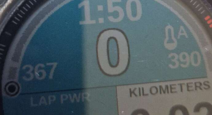

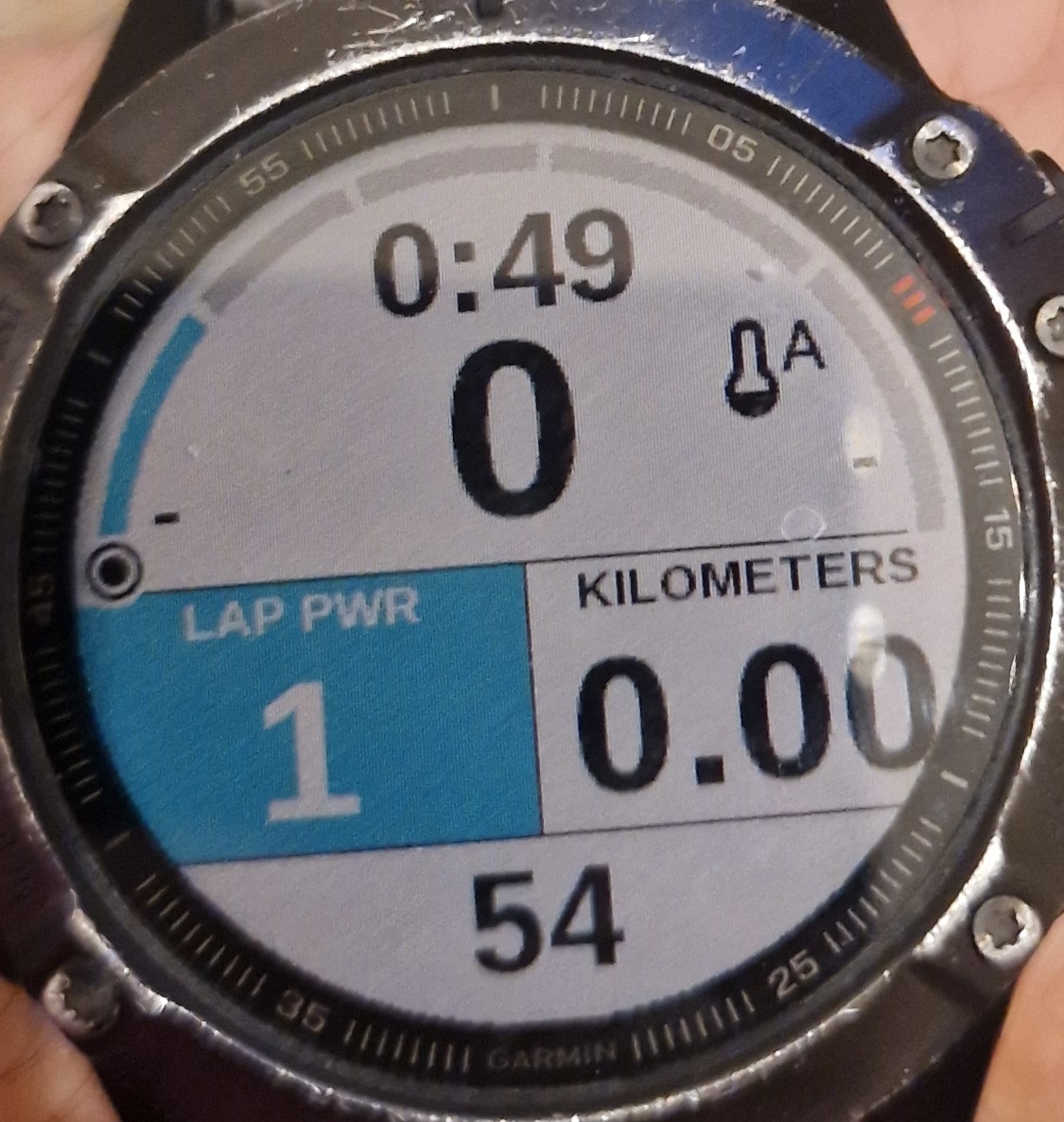

For my time trials I am trying to use the builder to schedule a lap with an absolute power range (i.e. by Watts, not percentage of CP/FTP). While executing, the Stryd data page on my Garmin does not pick up that range, it just displays “-” for the upper and lower bounds.
I tried these two ways:
- 2m 367-390W
- 2m 367-390W power=3s
Both had the same result (the latter was just a shot in the dark, I seem to remember that the power=3s option was mentioned somewhere).
I would expect the lower and upper range to be displayed at the sides of the upper field.
Is there a way to schedule such a lap correctly so it is picked up by the data page?

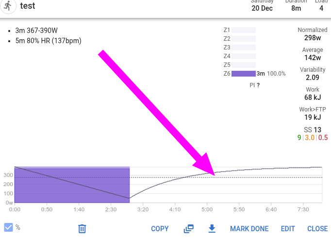

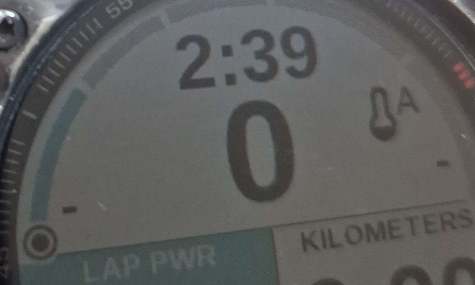

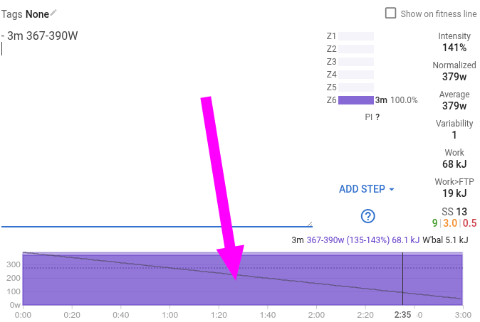

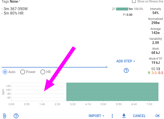

Experimenting a bit more. I made a very small workout which consisted of only a single lap with power. It works:
- 3m 367-390W
In my other session from my original post up there, there were a number of laps; some of them with power, others based on HR. Let’s see what happens if I make a workout with one HR and one power lap:
- 3m 367-390W
- 5m 80% HR
Voila, again the power is missing (for the lap with power of course, not for the other one):
Also very interesting: when I do only a lap with power and nothing else, intervals.icu correctly displays the workout intensity:
But for the workout with two laps, one with power and one with HR,now it shows no intensity for the power lap anymore, only the HR one:
It almost looks like intervals.icu itself ignores the power intensity as soon as I add a HR lap, and subsequently also does not emit it in the .fit file that goes to Garmin.

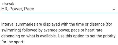

Note that I do have this setting for my Run workouts currently (all the 4 similar settings on that page are the same):
When I switch that around to Power->HR->Pace, the behaviour flips:
After flipping this setting to “Power, HR, Pace”, the power shows up not only in the GUI but also in the Stryd data page. But now the HR lap is missing.
On the one hand this explains the issue and gives me a fix, but on the other hand it is very unexpected. The setting says it is a priority for when intervals.icu could use HR, Pace or Power for something. But in my case (this kind of workout with some laps with HR and others with Power) there should not be a priority involved; for every single lap there is exactly one intensity, and I would expect that to be sent to the watch (and used in the load display in the GUI - I am aware that the load calculations from those three metrics are possibly not 100% comparable, but still they should be somewhat in the ballpark, and better than completely removing them, for sure).

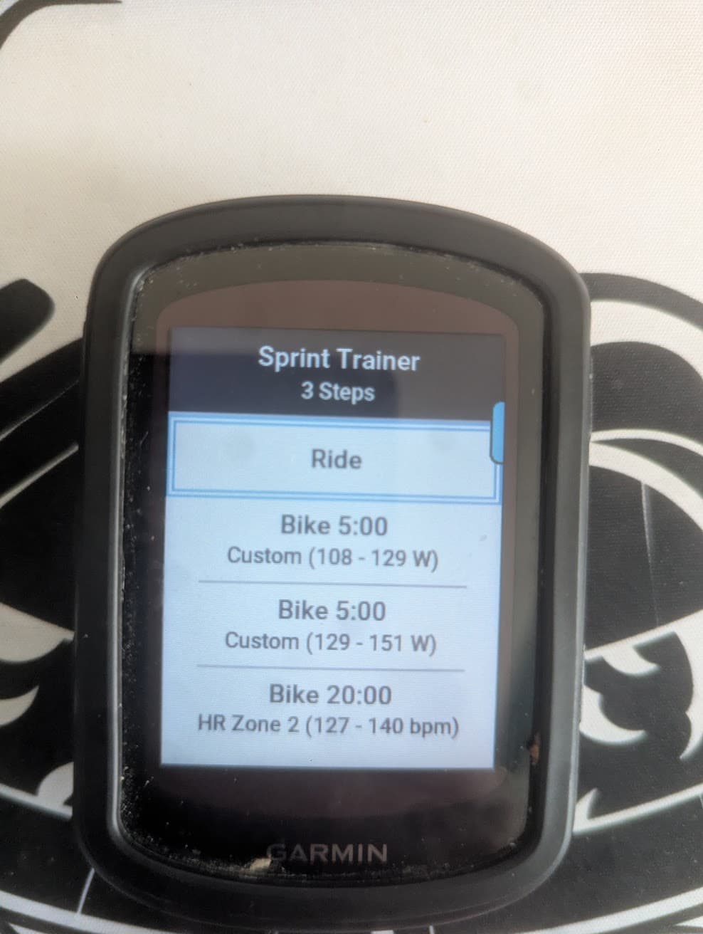

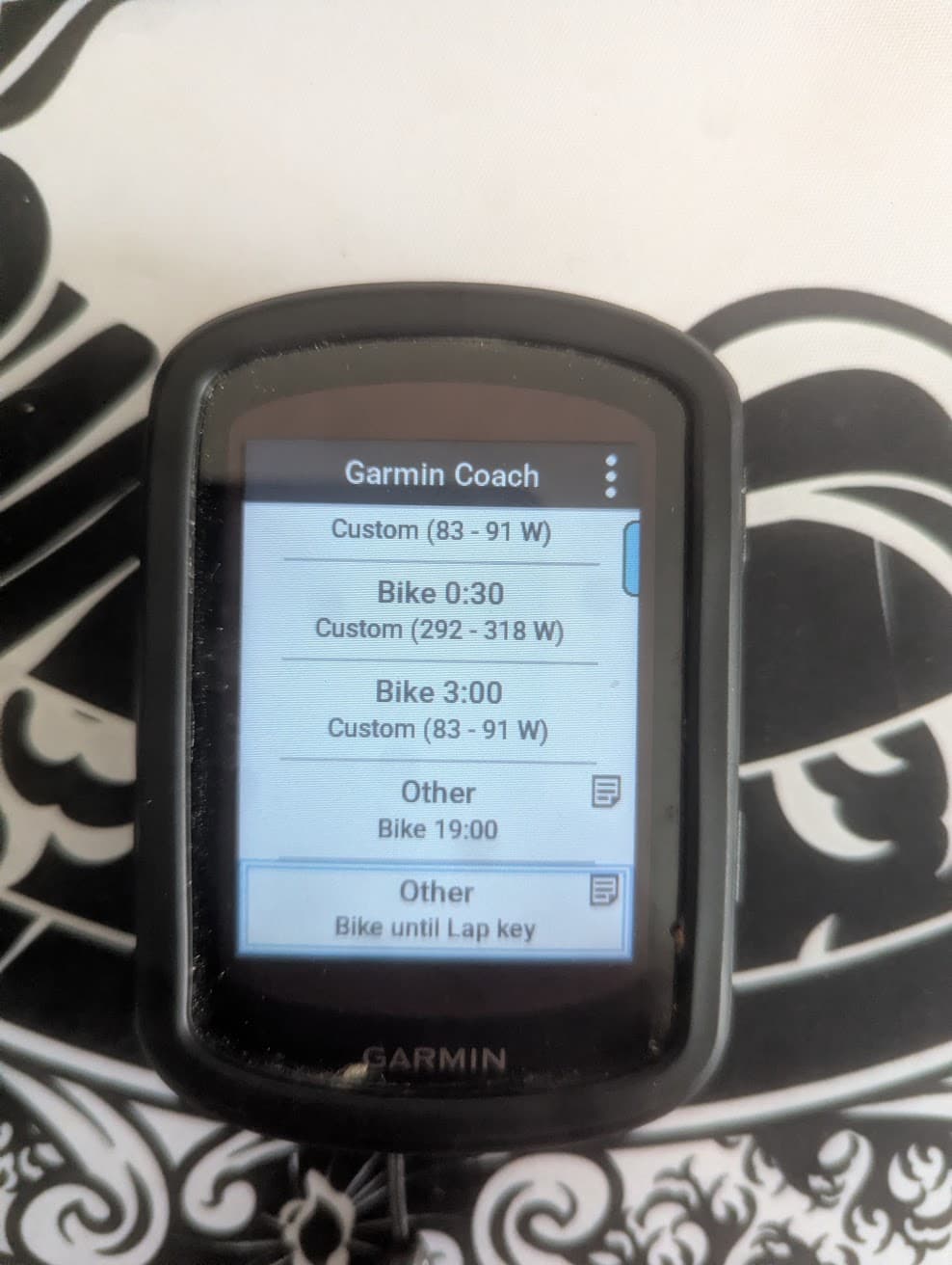

I’m seeing the same behavior here.
Workout created in Garmin Connect app → sent to edge 540. Different laps can have different target types.
Workout created in intervals → synced to edge 540.
Power steps have target, HR steps show as “Other”

— duration_type=0=time
— duration_time=60000=60.000 s
— target_type=10=power_lap
— custom_target_value_low=1175=1175
— custom_target_value_high=1185=1185
— target_value=0=0
— intensity=5=5
— message_index=1=selected=0,reserved=0,mask=1
CRC: expected=0x963C, calculated=0x963C
Garmin states target_type=1=heart_rate for the HR step and target_type=3=cadencein the cadence target step, while Intervals changes to target_type=2=open on the “non-prioritized” target instead of leaving it as stated by the creator of the workout, so as someone already stated it would be fixable by giving the option to disable this “overwrite” of the target_typevariable.
Thanks a lot for your efforts
Could you please consider looking into correcting this as the current behaviour makes the workout planner kind of useless to me… it’s not clear to me why having different targets on different steps would be
Intervals isn’t generating any workout files. It sends a workout in script form to the Garmin API and that’s what you see in Garmin Connect. Garmin interprets that and sends it as a workout file to your device.
What you’re calling the ‘Intervals generated file’ is the result of the Garmin interpreter.
I’m not saying that there is an error at Garmin’s side, and also not saying that there’s no error at Intervals’ side, but it isn’t as simple as you state. If it was that simple, it would have been solved long ago.
