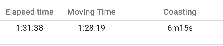

is it possible for a user to implement a stop time calculation and add it to workout and list view?
For example yesterday:

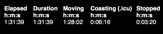

and I implemented your coasting formula in WKO5, along with a stop time formula:
WKO5 formulas
Coasting:
  • sum(if(if(isvalid(cadence),cadence,0)>=0 && if(isvalid(power),power,0)<=10 && if(isvalid(speed),speed,0)>=0.62, deltatime))
Stopped:
  • sum(if(if(isvalid(cadence),cadence,0)=0 && if(isvalid(power),power,0)=0 && if(isvalid(speed),speed,0)=0, deltatime))

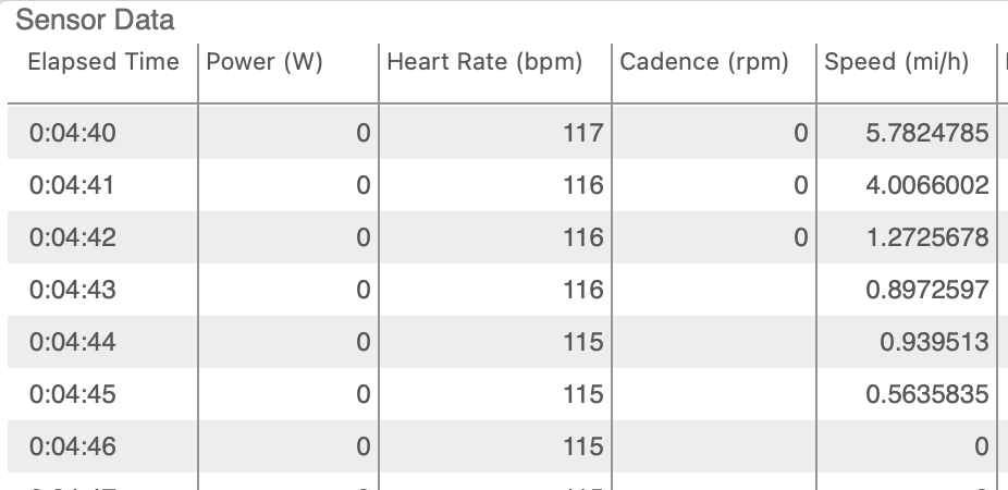

Had it use “if(isvalid(xxx),xxx,0)” because Garmin will stop recording as seen in the cadence records here:
