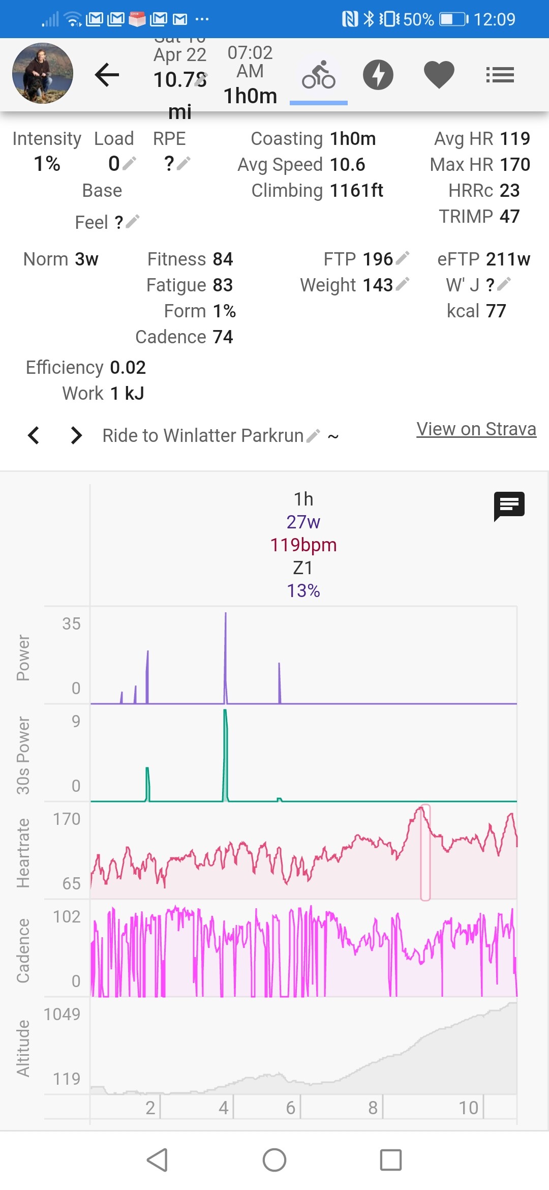

I do not have a power meter on one of my bikes, but somehow my watch detected another PM mid ride on my way to parkrun (maybe a Stryd in my pocket)
This has given me a TL of 0!
In this case if I could toggle between HR and power to calculate the load it would correct my fitness/fatigue/form graph - using power has caused a big loss in Load

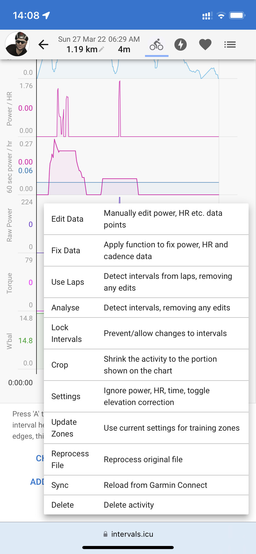

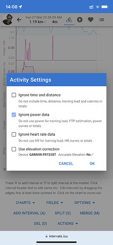

Go to the activity
At the bottom is Actions
Select Settings
Ignore power
It will then use the HR for the load.

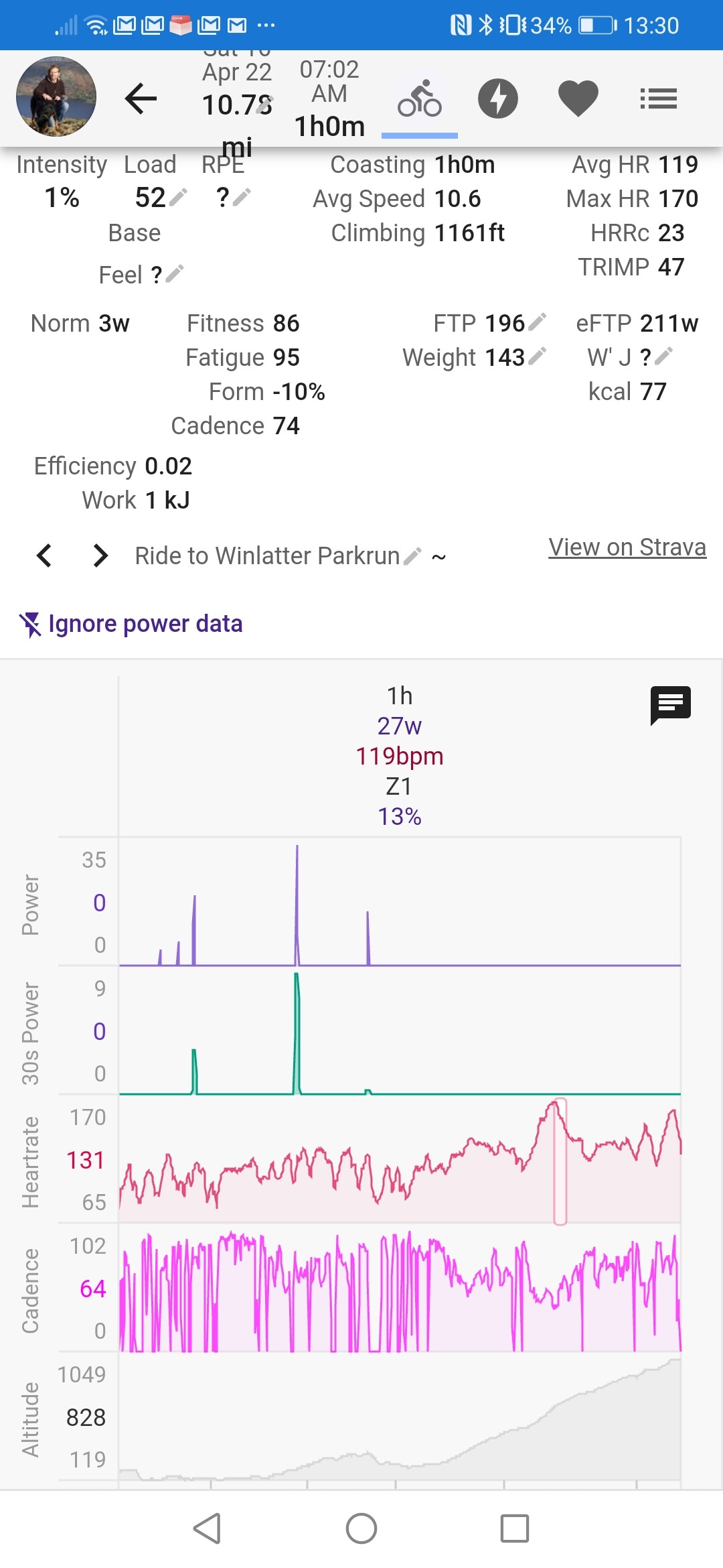

Thank you Gerald
That does indeed correct my load to use HR.
I can see some metrics still use power, for example intensity and calories (work kj) but your solution is good enough for me.
