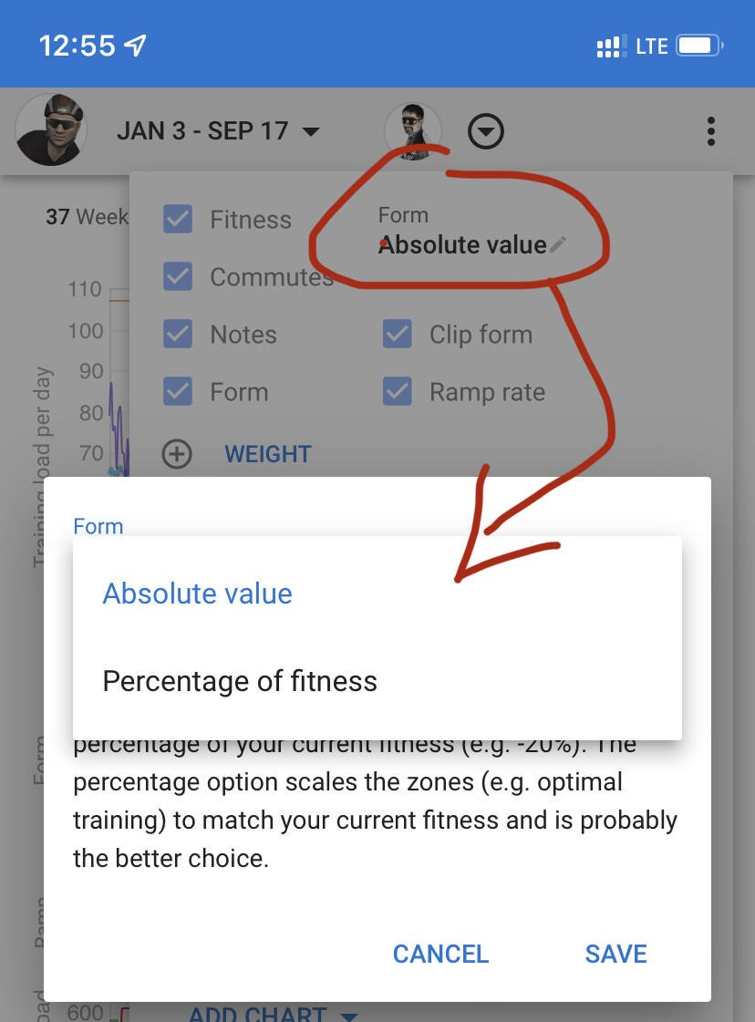

After trying to sync my heart rate zones from Intervals to Strava and Garmin (it keeps auto messing around my zones!) I was really exploring all the screens here and something really weird happened as you can see from screenshots bellow. .
What I remember of changing was fitness from absolute to percentage.
What could I have done to completely mess up my data like that ?
First image is absolute fitness
Second image is % of fitness
Look at the form (TSB) number on your fitness graphs. Change it back to Absolute and you will see that it reverts back to “normal”.
Rather use your ramp rate to guide “too much training, too quickly”.

The absolute number is an old, but trusted, way to measure Form (aka TSB or Training Stress Balance in TrainingPeaks). It’s a measure of how much an athlete trained recently (Fatigue, aka ATL in TrainingPeaks), compared with how much an athlete trained historically (Fitness, aka CTL in TrainingPeaks).
From TrainingPeaks.
TSB is not as a predictor of performance but as a measure of how adapted an athlete is to their training load.
Formula:
Form (TSB) = Yesterday’s Fitness (CTL) - Yesterday’s Fatigue (ATL)
The % of Fitness method is related to your zones. I’ll be honest and say that I don’t know as much about it as I should. I’m old school, and can tell you if you’re over training based on what I know, or have been taught, using CTL, ATL, TSB, ramp rate, TSS, TIZ, RPE and Feel, and perhaps a few other metrics not listed.
I prefer the Absolute value, as I also use WKO5 for all my athletes, which is where this originated. Intervals adds more value than TrainingPeaks does, which is why I’m here for the integration with my athletes.
