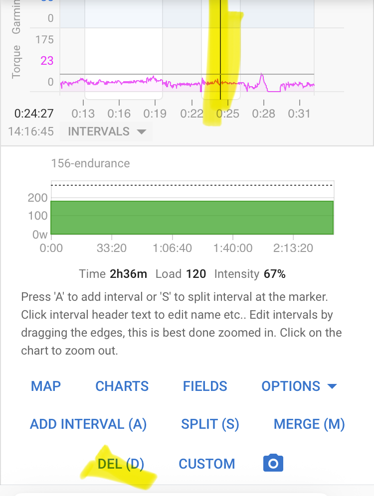

I selected an interval (one that I labelled as a break) then went under the option “Del” bottom of the screen, and it seems something else was deleted as the interval selected with the label was still in the list intact. I went to Re-analyze activity and all my labels are gone now.
I think it should not be a complicated UI feature to expect : select an interval, change type, or simply as you told me, selected an interval and delete. Or did I chose the wrong option on screen? It’s not obvious, at least to me.

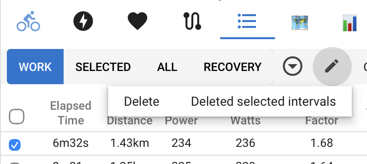

On mobile I would use the data tab as shown in the screenshot above.
If you use the timeline it deletes the interval where your mouse last hovered. On computer you just hover over the interval and press d.

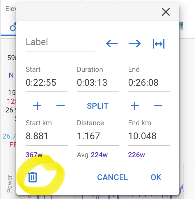

But you also can delete by opening the interval
