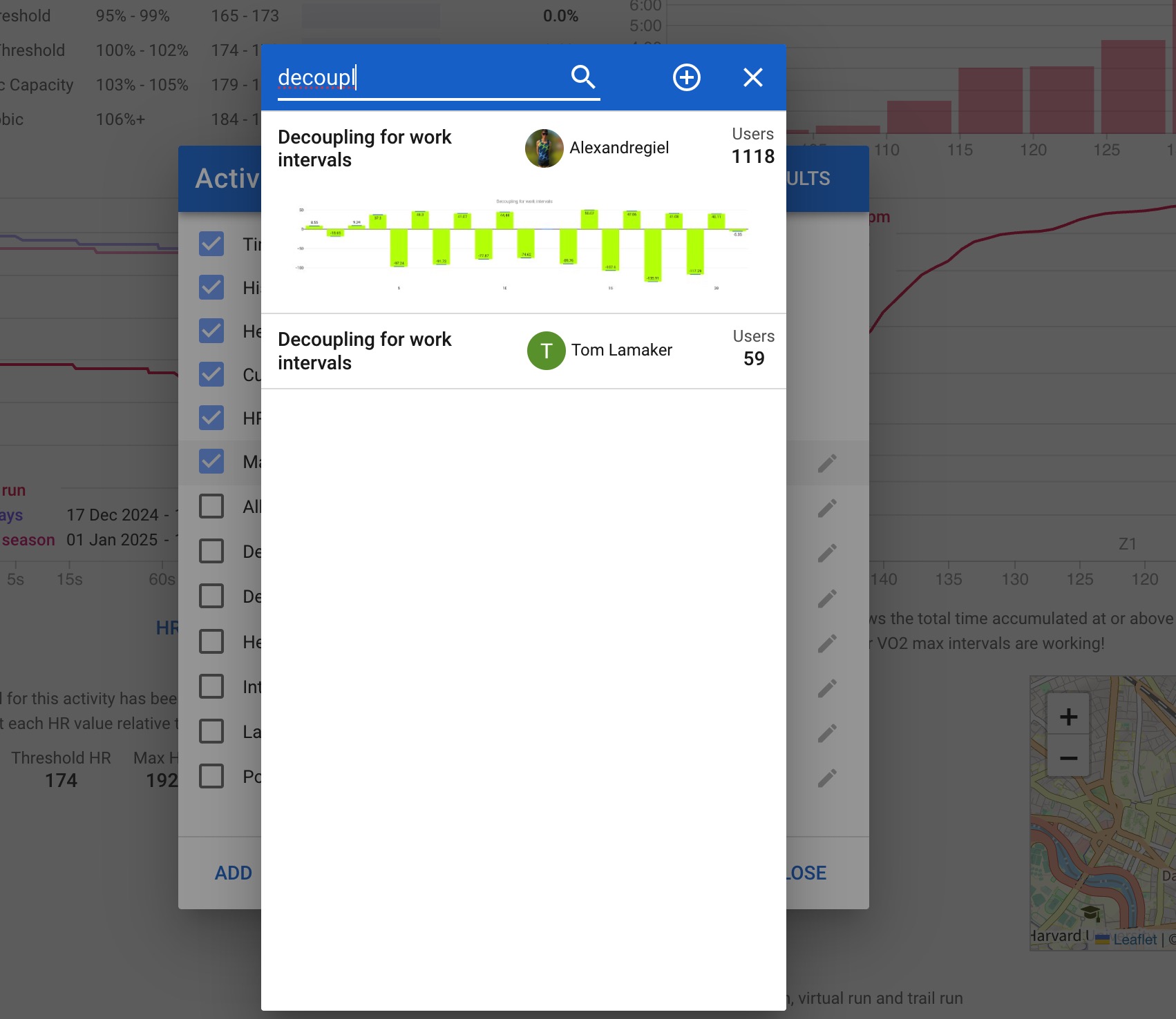

hi @Radvocaat , im not able to see any charts when looking for “dec” on my run :frowning:
Can you tell me where you found those? I can’t find those when looking manually , either
I think you have to look at the (custom) fields. It is a metric.
Ah got it :slight_smile: Thank you @Radvocaat !! I got it now :smiley:

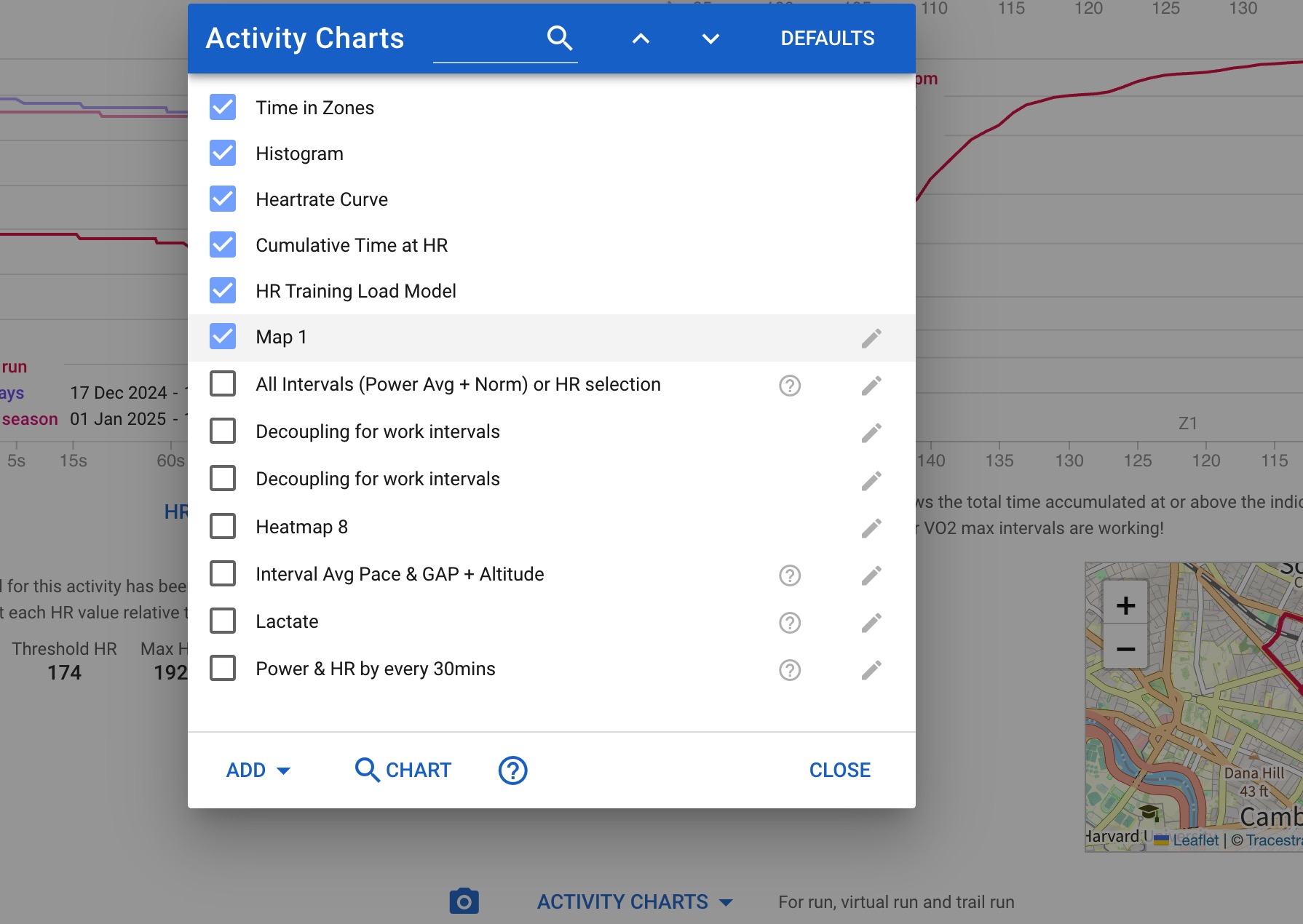

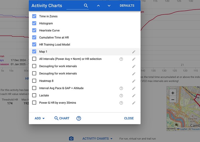

hey, sorry to ping a dead thread, but I can’t seem to figure out where the custom fields are?
I scroll down the the bottom of the activity, click on “activity charts” centered on the bottom of the page, click on the “chart” button with the magnifying glass, and then search in the pop-up, but to no avail (the chart that comes up doesn’t work for me). Sorry for the ignorant question, I’m still new to Intervals.icu and trying to figure everything out.
The custom field is added from the timeline screen. Select Custom and search the fields from there. It is an activity level field, not a graph.
I don’t think anyone has made a plotly graph for decoupling based on pace.
