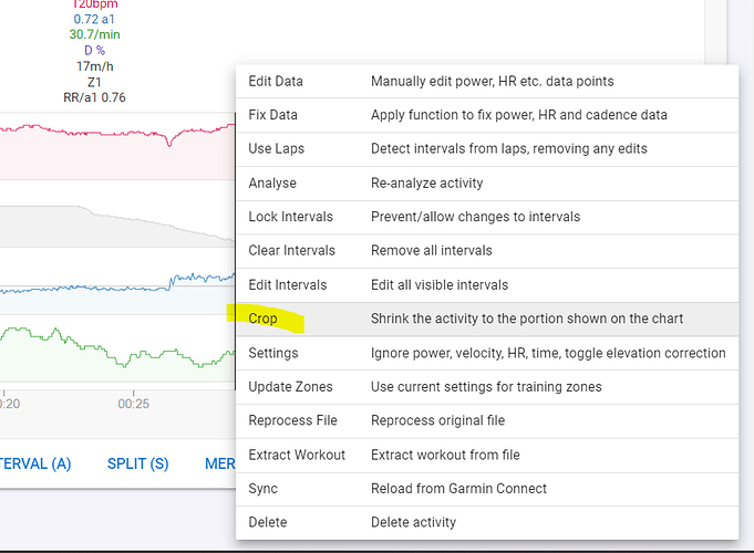

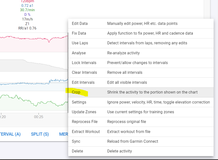

If you really want to split, use the ‘Crop’ function. Import the same file a second time and crop the other part if you want to keep that one too. Crop keeps the visible part and removes the rest.

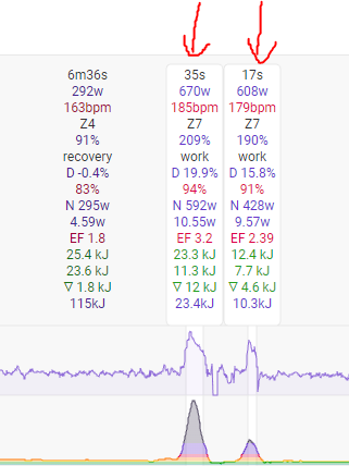

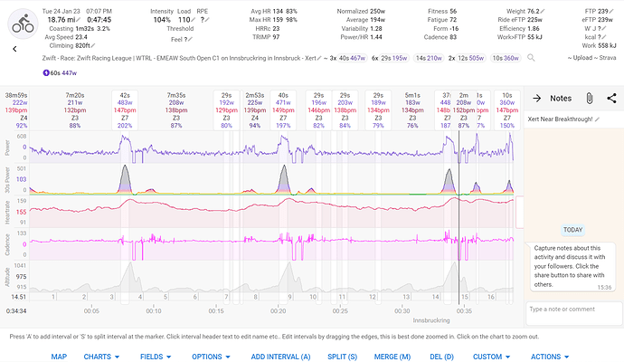

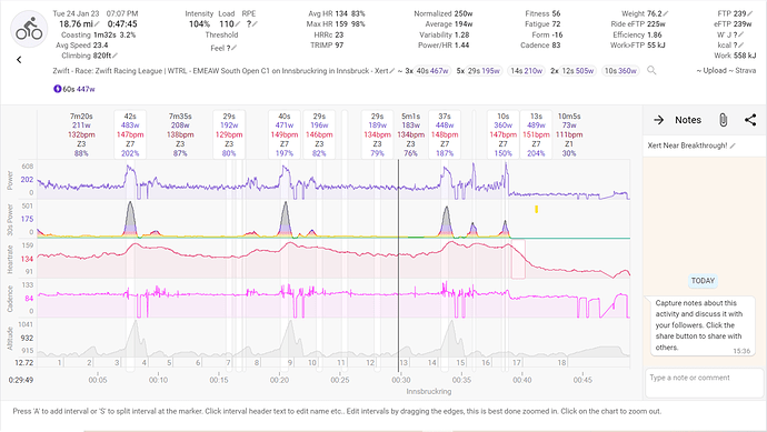

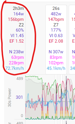

This is the activity…

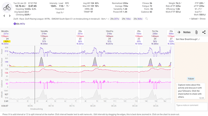

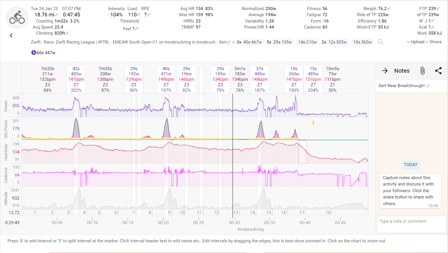

and this is the subset I want to look at…
It shows the correct interval length over at the far left, but it doesn’t appear on the Interval Data list and the Intensity for example is not correct. (Must be less than the whole activity as I’ve chopped some low power stuff out).
Not sure I follow still sorry - I’m missing something. But I would think you need to delete all your current “intervals” and add a new “interval” using the “a” key for the duration you want and then use the fields to get the data on that interval specifically. Not sure if that will solve your use case in this instance.

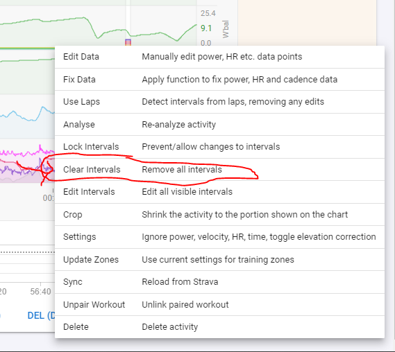

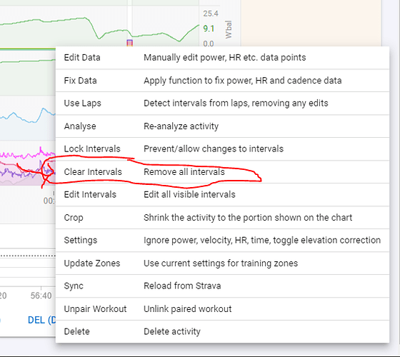

Its easy to get rid of all intervals…
Activity > Actions > Clear Intervals

I had a similar question a while back. In my opinion you have two options, 1) to crop the activity in Strava and re-upload it, with the disadvantage that you “lose” the cool down part of your activity. Alternatively, and this doesn’t work in retrospect obviously, you can 2) always end your activity as soon as you cross the finish line on your Zwift race and start a new activity for the cool down.

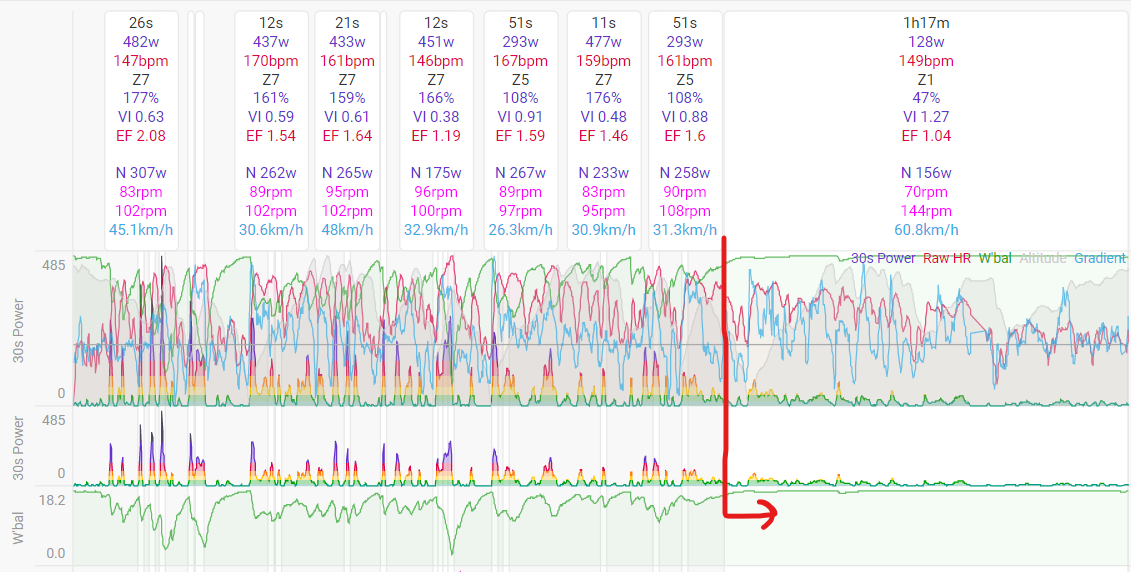

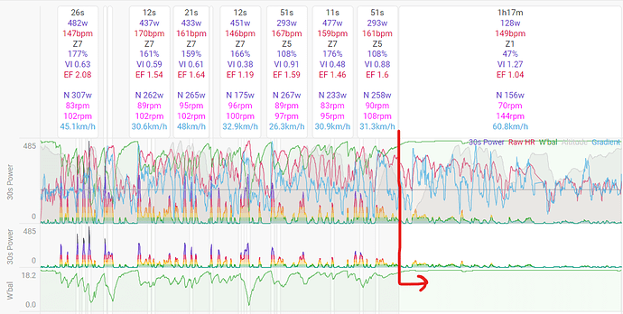

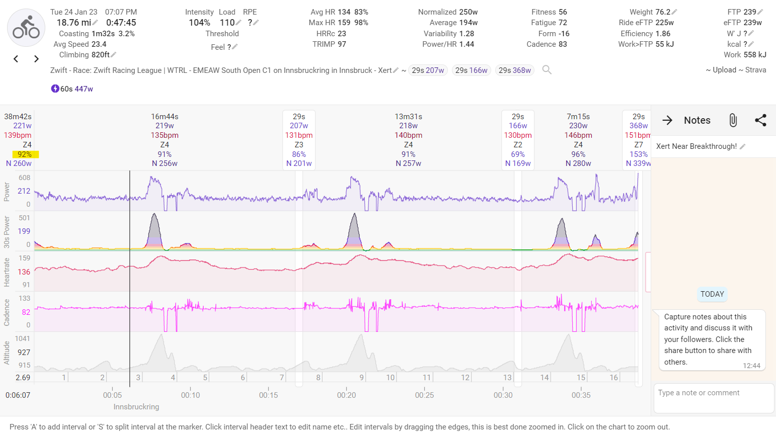

As @Kosio_Varbenov mentioned, if you highlight the section you want to review, it will zoom into the “interval” data you want to see. The summary appears on the top left of the screen.
It will retain the intervals already highlighted on your activity, but exclude your cool down section.

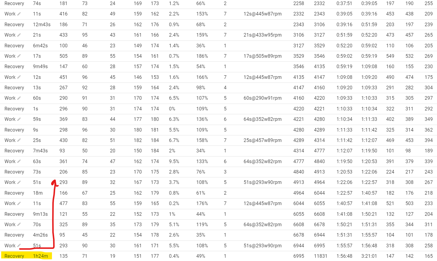

If you want to see it in the table format, then mark the final section as one long interval, from when you pushed lap, to the end of the ride. This will then show all your work/recovery intervals and the final long recovery. Here’s an example of a race, where it was racing for two hours and then a 1h24m ride back to the start.
Summary data at top left
Thanks. I have half sorted this. I “cut” the recovery out and it is showing the data now for the race part of the ride. However, it looks as though for the Intensity data field, it divides the average power by FTP - when IF =NP/FTP. This was one reason I didn’t think it was working.
