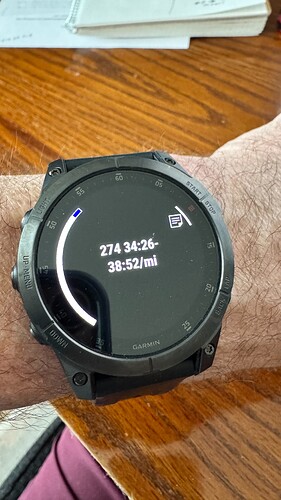

Can I please understand how SWIM programming works in YARDS?
I programmed this workout in TrainingPeaks and Intervals. When loaded onto the Garmin the TP version works perfectly, all segments are represented in yards. For the version I programmed in Intervals (below), it doesn’t show the distances in yards it shows in some weird position of a mile (pictured). Is the 300 yards converting to 274 even though I have the pool length set to yards? And, is pace always shown in MPH or is there a way for me to have it be a normal per 100 swim pace (for pace based workouts)
Here’s a workout programmed in Intervals, what am I doing wrong?
