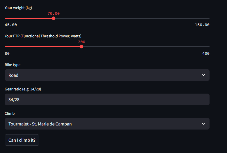

I’m creating a very simple webapp and even in the very early stage I would appreciate some feebback or ideas. It is not even published yet so I will use screenshots.
The idea is to know if you will be able to climb certain iconic climbs given your current fitness (weight, FTP) and gear.
For the calculations, I use a minimum of 55 RPM, no wind, decent road. I could of course add all these parameters, but I prefer to keep it simple for the user.
That’s all I have for now, appreciate any ideas or comments. Thanks!

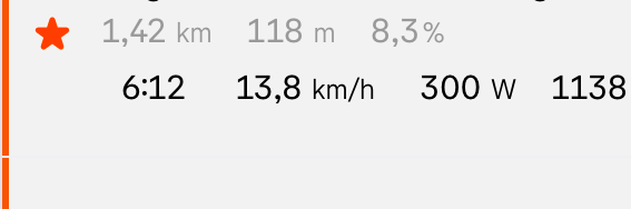

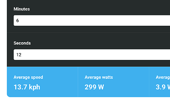

Hm, I have a small hill in front of my door, constant gradient, perfect to hold constant power and the calculation fits just as perfectly:
But I think if one of both (power or gradient) is not constant, it won’t match as perfect.

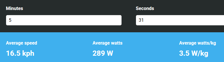

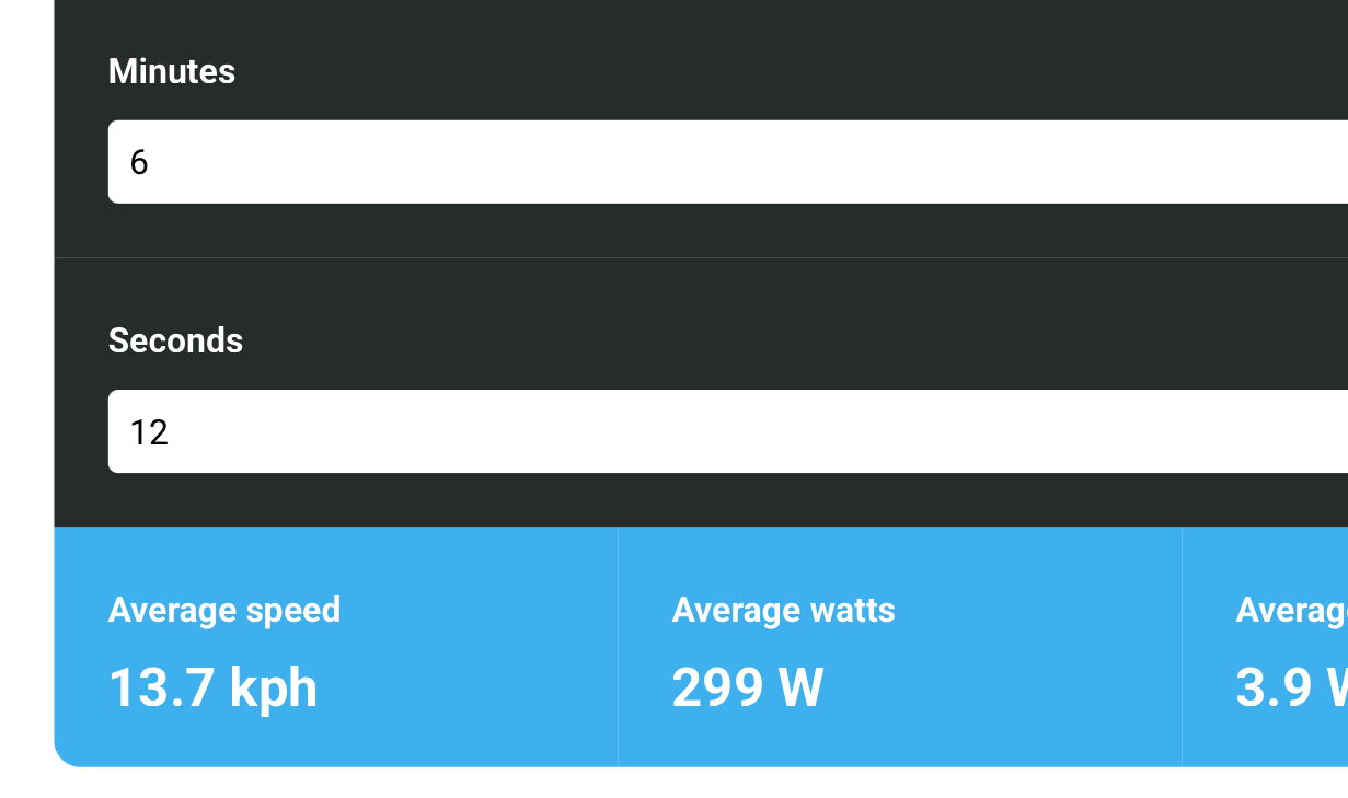

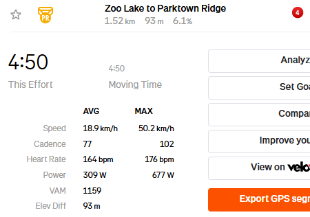

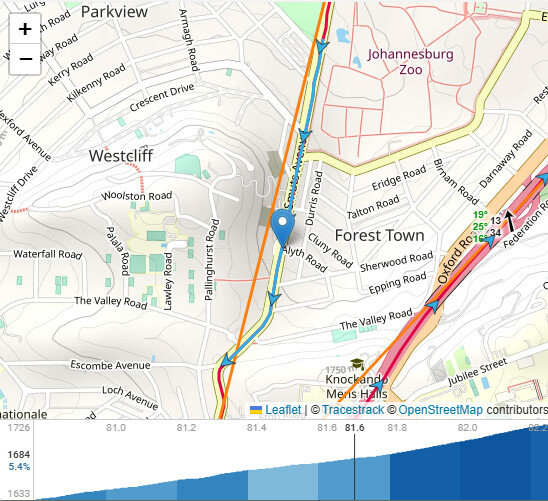

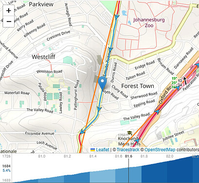

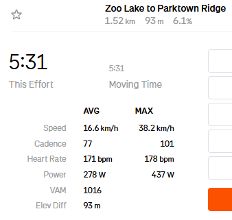

I found another segment of 6.1% that shows 278 vs 289 (4%). Intervals shows 283 (mid point between the two). Not sure if altitude (1633-1726m) would make a difference to the calculator.
I live at 1530m, so would be acclimatised to 1600m, yet the w.alt field is 315W which too high.
The PB effort shows a little more variance (10%), but I can’t remember what my weight was back then. 4Kg doesn’t change the value by much.
Anyway, I’m not worried about the differences, but it’s good to have some reliable sources, if/when needed.

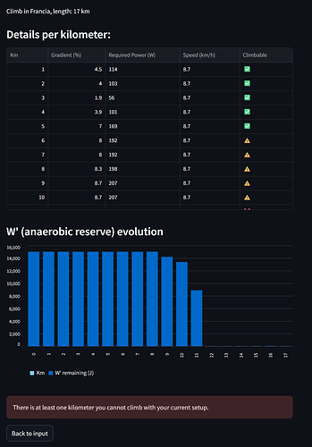

I have published a very first iteration:
https://can-i-climb-it.streamlit.app/
When I have some time, I will improve UI and add more climbs, also the possibility to import your own.
For now, it assumes a min cadence of 60rpm.
The main difference with existing calculators is that it does km by km. I can in theory climb Angliru based on average percentage, but in reality I will die in the hardest kms.
