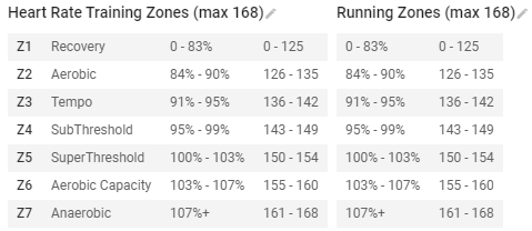

Can you go to Intervals.icu and show the table HR Zones and Run Zones. Unfortunately still don’t exist an HR Zone just for RUN.

Below are my zone settings. I don’t care too much about the absolute Load figure. But a 10-minute warmup in Z2 having a load more than half of 42 minutes in Z5 is messing with my trend analysis.
Would be great if you could spot my wrong setting!
I dont think your running zones are correct, 42 minutes in zone5 is not human possible.
Can you get the PB workout and give me average BPM of the last 20 minutes? Did you went full out for the PB right?
You should probably change both of these in /settings to HRSS:

The “time in zones” model requires a lot of rides with power meter and HR monitor. HRSS just needs correctly set resting HR and max HR.
Running 42 minutes at LTHR (and above LTHR in last 10 minutes) is not impossible, is it?
My LTHR value of 150 comes from Garmin’s auto-calculation. Last 20 minutes of all-out run: average HR was 153 bpm. So I guess I should manually increase LTHR to 153.

That makes sense, will change that setting.
